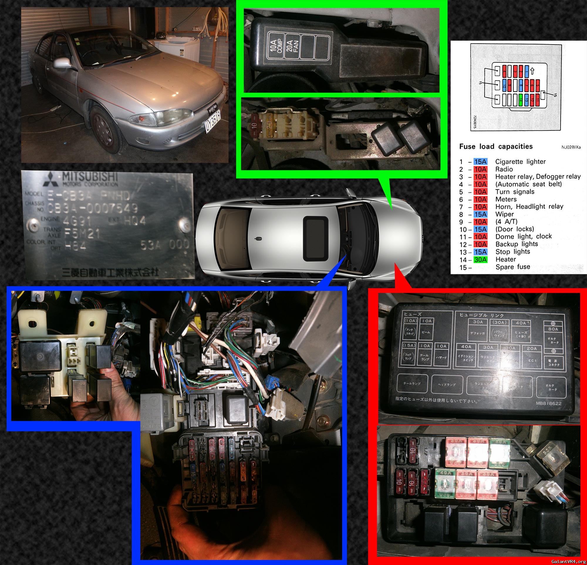

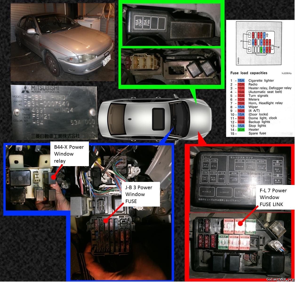

If you or someone could tell me out of any of these images is definitely
the relay for the power windows i would appreciate it.

(d) So where would the location of the power windows relay be on any of these images??
Because it has to be some sort of rusted relay thats got worse and worse to energise over time.

Start out with the power Fuse, then the power to the relay, then the signal to the relay, then end at the main driver side window switch.
Here is your picture with some extra annotation to help you find the relays:

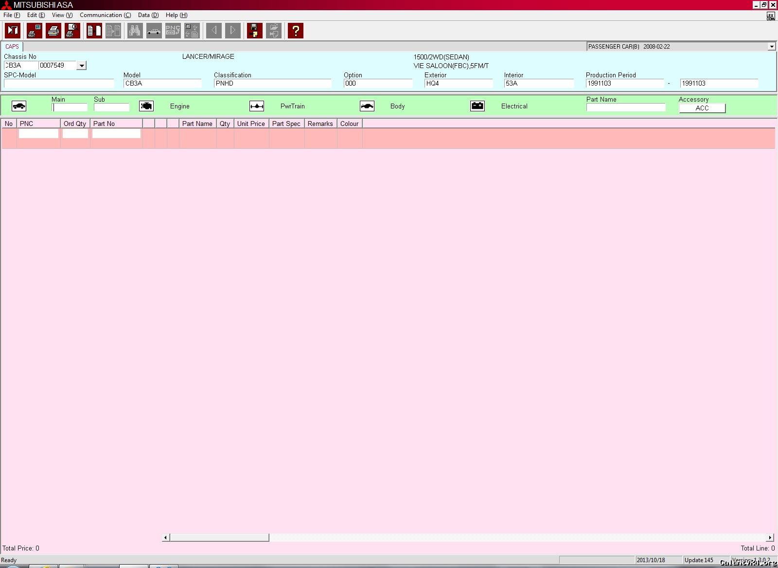

Your car shows as a 3rd week October 91 Build date:

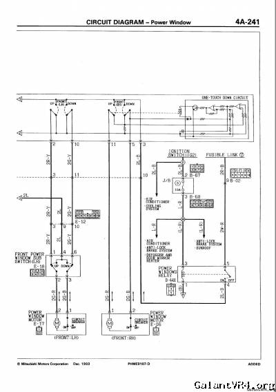

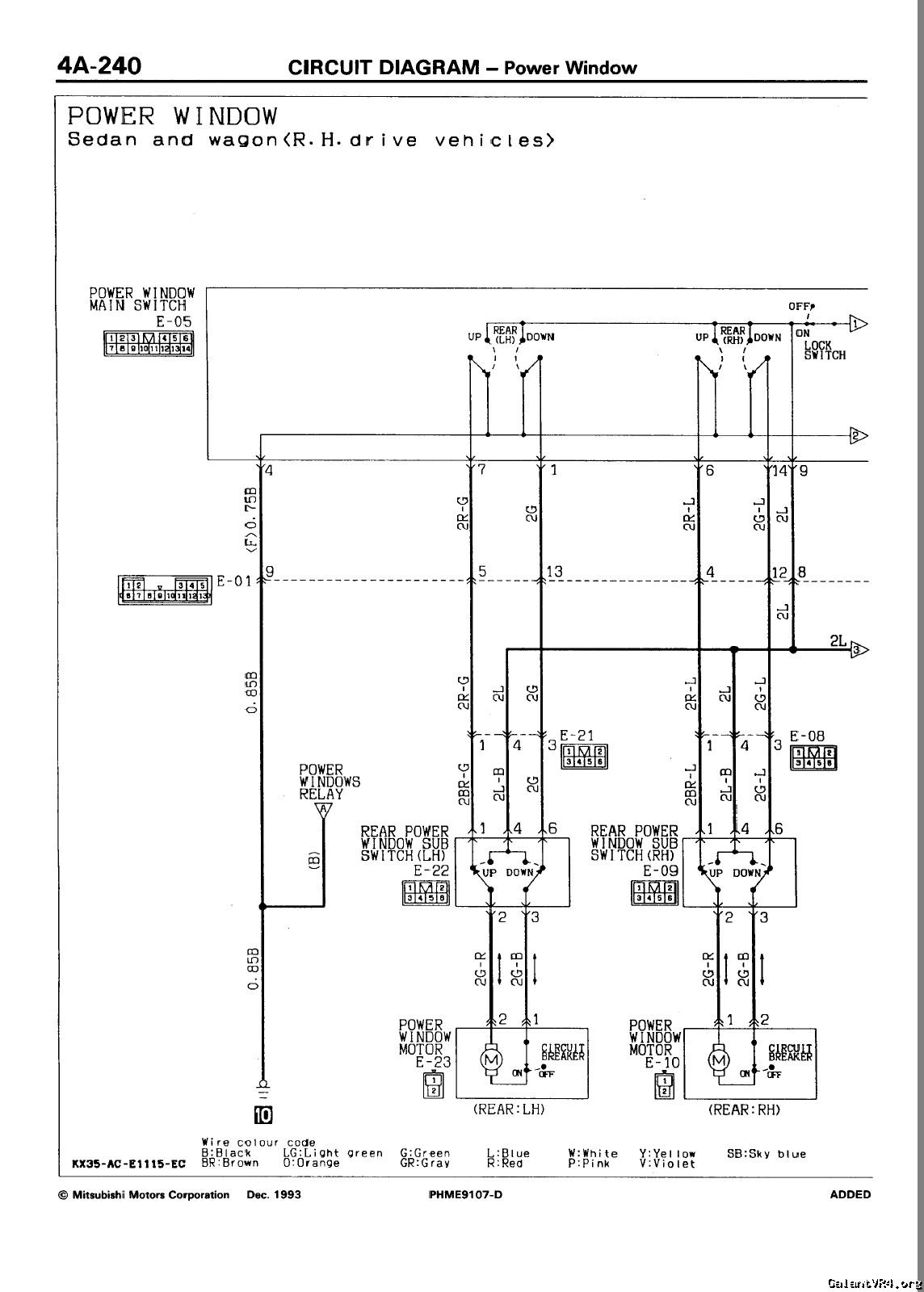

You are Lucky as my car here is a CB4A lancer and I have all my shop manuals here including the Jap ones.

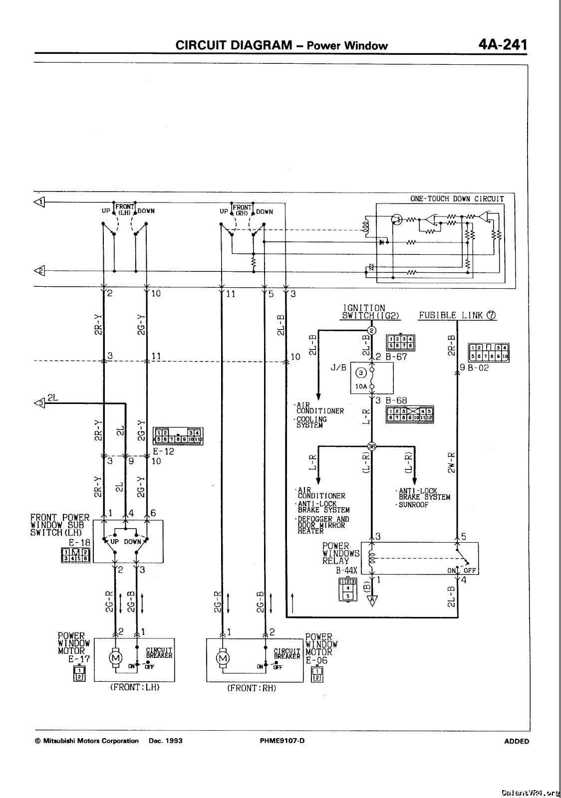

I have reviewed the Japanese, Australasia and the European wiring diagrams and they are the same in terms of power wiring. I Have the European onmy PC too so here is the RHD wiring diagram:
To get to the window switch you need to pull it to the back of the car and lift the front with something dull like a spoon or the like.
You may find the randomness is down to the switched 12v ignition feed to the signal side of the relay (your shared feed). If this is the case then change the rotary switch on the back of the ignition switch. I had to do something similar to my CB4 when I was preparing the body systems to accept the engine because a contact was burned out.
