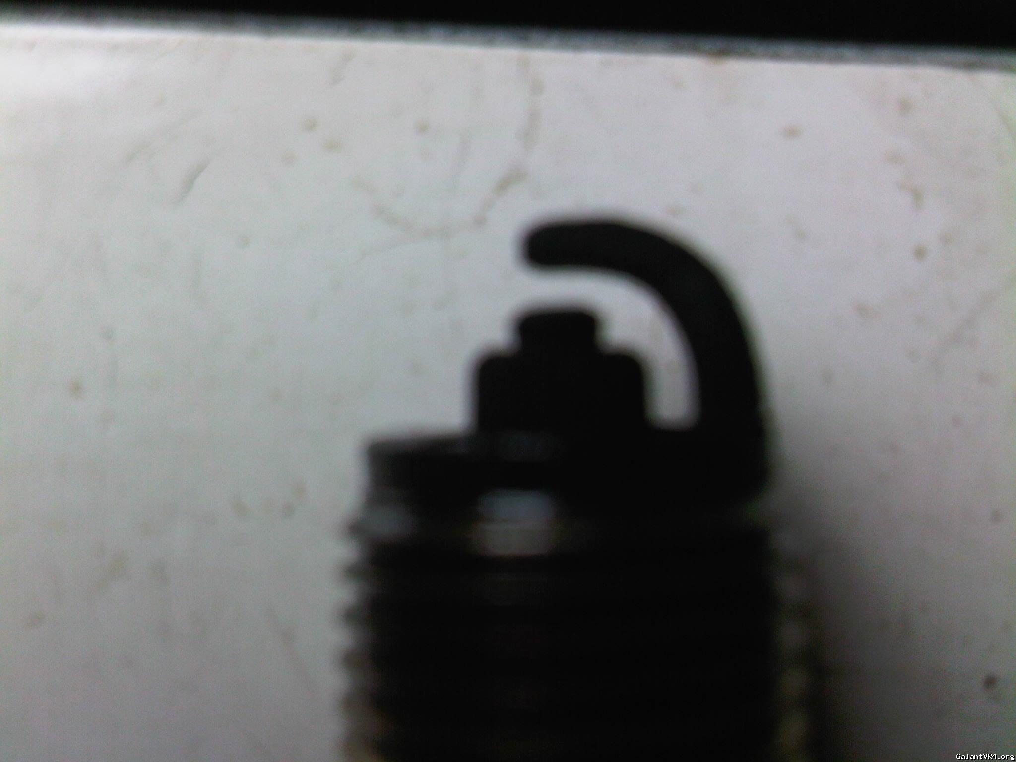

Re hooked up the tester to cylinder 2 again today. Left the plugs in the neighboring cylinders so i could listen better. Still gave me about the same reading, but this time I was able to pip-point the sound to the dip stick tube. /ubbthreads/images/graemlins/mad.gif /ubbthreads/images/graemlins/frown.gif
Doesnt look like a good situation.
Here is a picture of the plug from cylinder 2.
