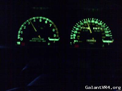

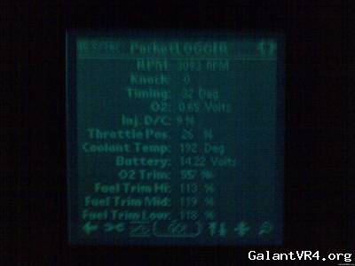

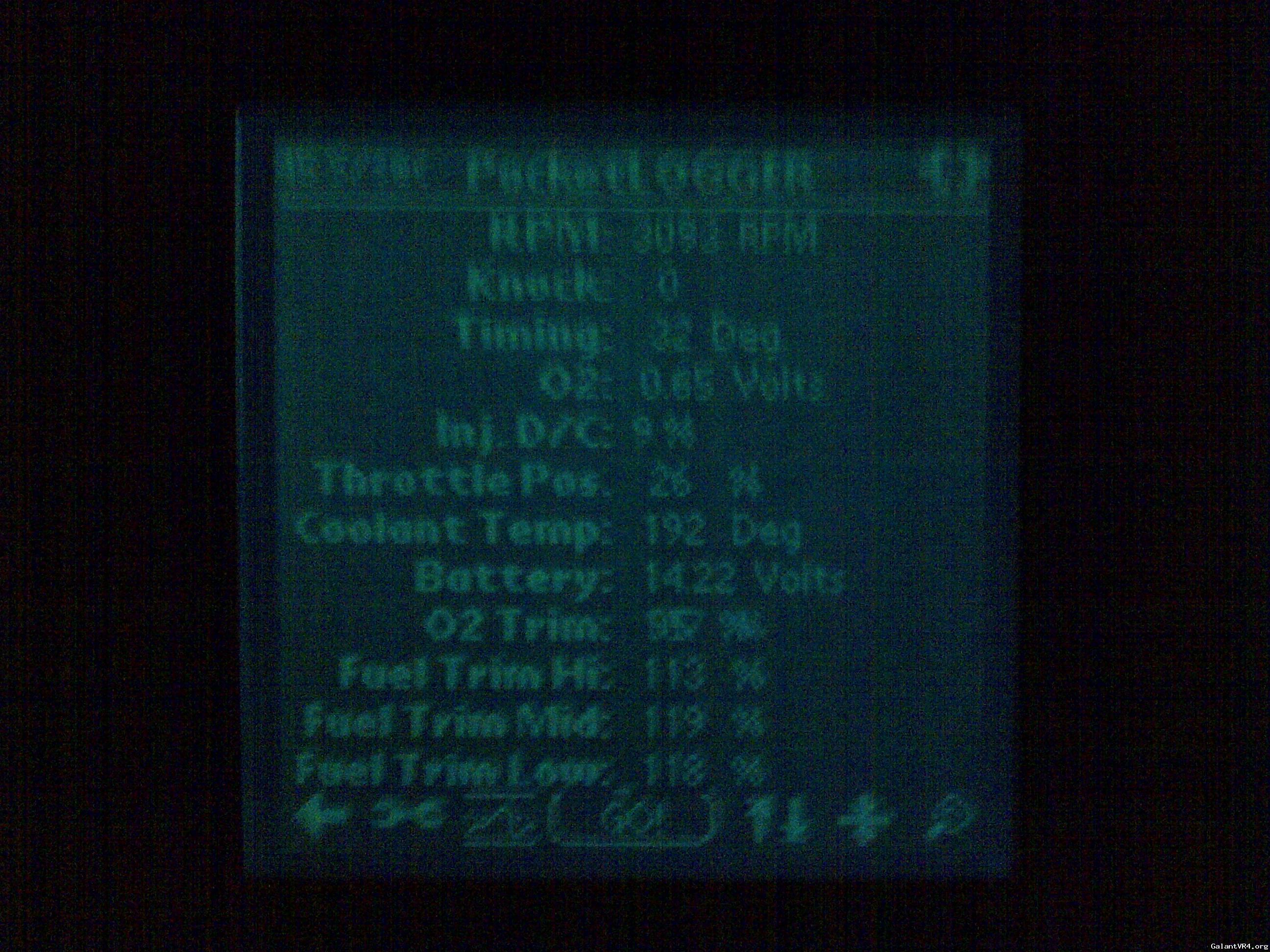

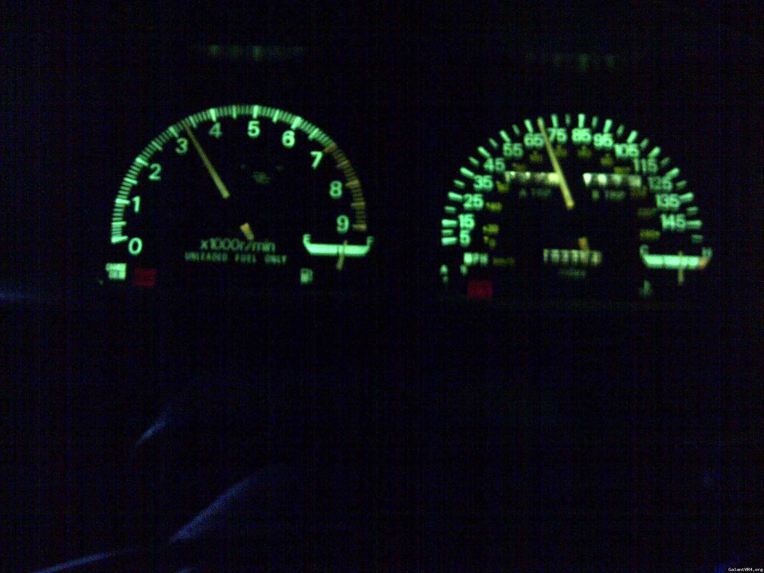

Tonight about 20mins into the trip home, the brake and battery idiot lights came on super dim. Normally I would assume alternator failure so I shut off anything electrical I didn't need and turned on the pocketlogger. To my surprise, the battery voltage was showing 14.2 volts, meaning the alternator was still throwing out a good charge. Those lights stayed on for a good half hour and then I noticed they shut off at some point. About 15mins later, they came on again. I figured screw it, and turned my radio and foggies back on. The idiot lights came and went a couple times for the rest of the trip. No other issues though. Car has all heatshields intact around the turbo, BTW.
After I got home, I broke out my multimeter and checked the battery voltage with the car off. It was 12.55 volts.

I snapped a couple pics while driving to show the dim idiot lights and the voltage that the pocketlogger showed. Anybody else had/fixed this or know what could cause it?
Sorry about the pic quality. I had to use my BlackBerry and it was obviously dark.

If you pull on the e-brake handle, does the light get brighter?
You may have an issue with the flexible "board" on the back side of the cluster. They have been known to fail after time. See if you can spot any corrosion on that flexible membrane. it will look like darker spots on the traces (usually on the edges creeping toward the middle of each copper trace).
11,982
Yeah, if you pull on the e-brake handle, the dash light gets nice and bright.
