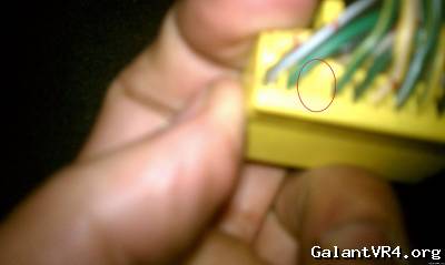

I tried to hook up my new PLX M300 wideband a few hours ago, but for some reason I was not able to get the device to turn on. I connected the power source to the accessory input for my stereo and grounded the black wire. I tested the accessory input with a multimeter and saw 11.x volts upon turning the ignition.
Also, the harness for my ECU does not appear to have an EGR input connector on it. It just has a space with no wire in the plastic clip. The picture is poor because it was dark, but you can see there is nothing there. Is this normal? If so, is there a way to still use that input? Thanks
11,985
EGR input can be used. You need to find another wire harness and steal a little pigtail wire to stick in there. It is normally empty as you see. In fact, I think I had to get one from Barnes back when I needed it. He may still have an extra harness laying around that you can nab a single pin/pigtail from. It's been so long I don't even remember what I'm using the EGR input for. /ubbthreads/images/graemlins/uhh.gif /ubbthreads/images/graemlins/rofl.gif

Oh sweet, that will work perfectly. My buddy has two 1g turbo parts cars at his place in Prosser, so I can grab them on my way through to Yaki-Vegas. Thanks Mark. Now I just need to know whats going on with the WB.
