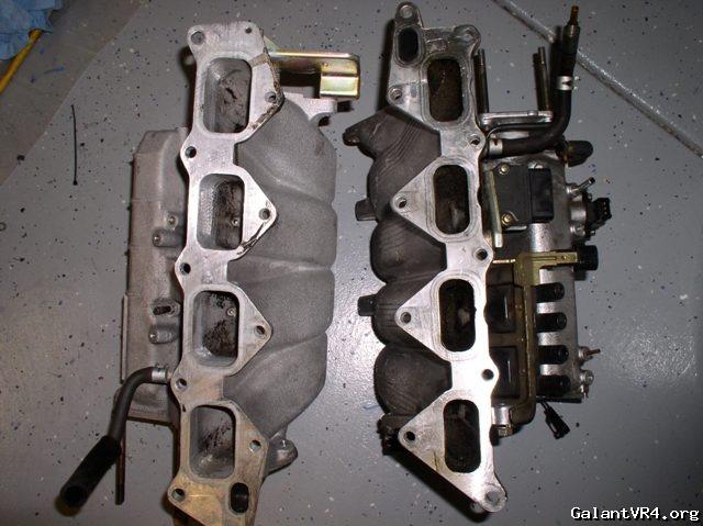

did you port out the intake manifold to suit the vr4's big intake ports vs the small evo ports? wether or not this would make a difference im not sure

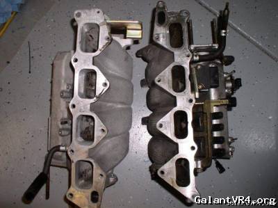

Do you have an Evo head on it? If not pull the Evo manifold off and reinstall the vr4 unit. I'll bet it runs perfect again!
There is a large difference in the port sizes. I'm amazed that you even got it to start.

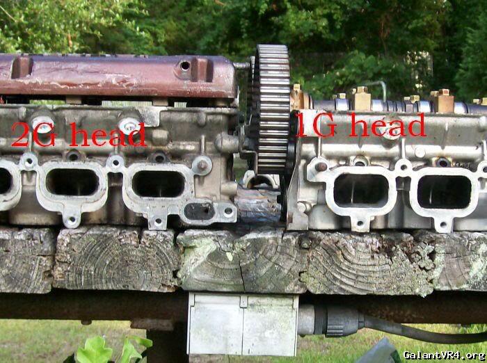

Thanks guys this really helps /ubbthreads/images/graemlins/worthy.gif , I also read that maybe a 2g intake manifold would work better without having to swap my head, is this true? My little brother has a 96 GSX and mite sell/trade him if so

One time my friend accidentally put the washers to the intake manifold nuts in between the manifold and the head.
And don't try using the 2g intake manifold with a 1g/gvr4 head. Just get one from a 1g. They're very easy to find.

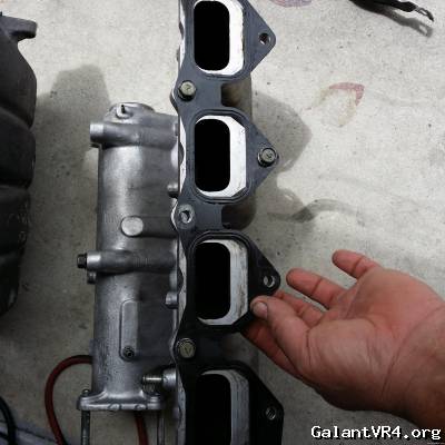

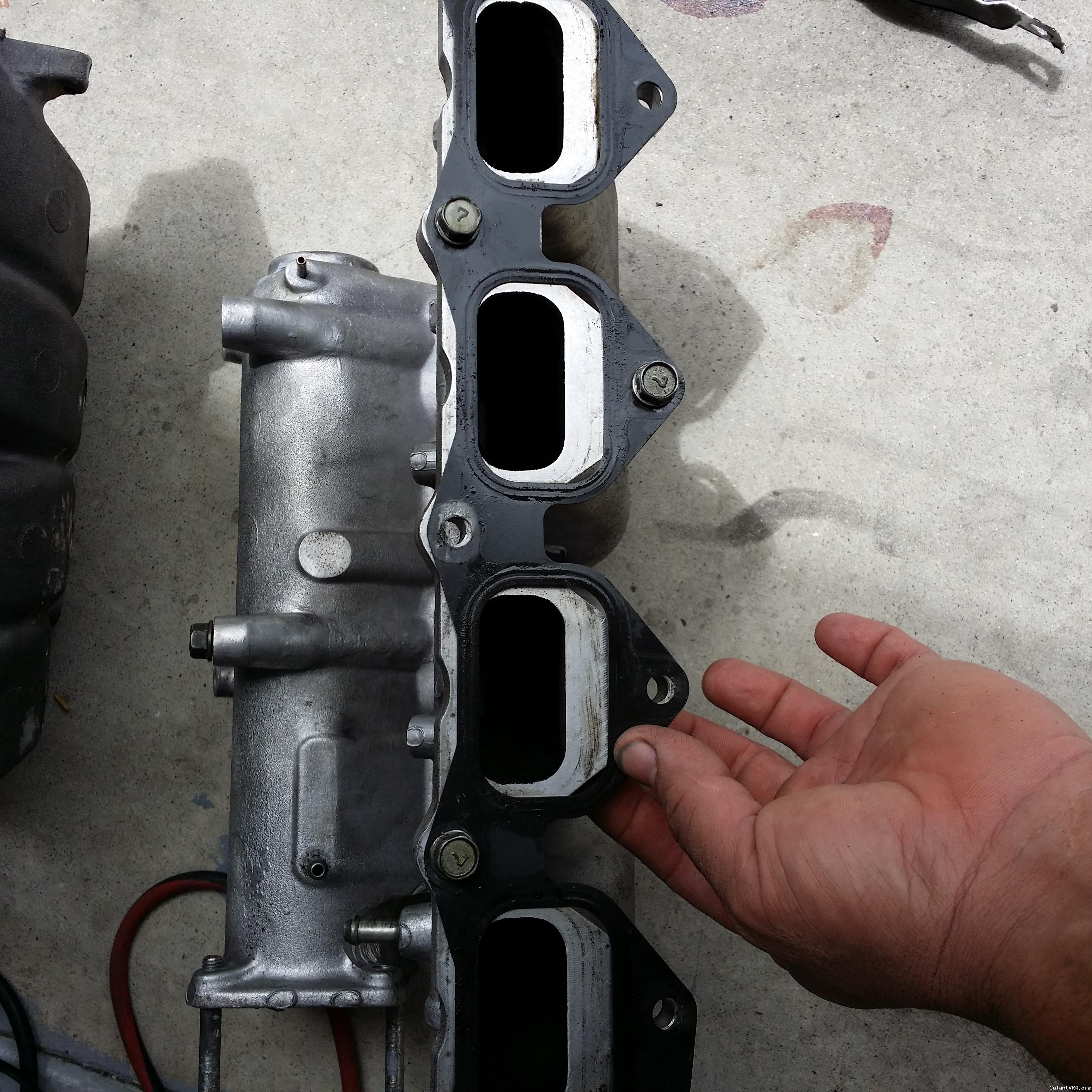

Got it!!! Thanks for all your help here are some pics showing the problem, the VR4 head intake port is too big for the evo 3 IM, I'll sell it and look into a different one, thanks again
FlyingEagle
Mar 5, 2005
1,635
THE Ottawa
Quoting iceman69510:
Did you use that gasket?
Nice built in vacuum leak.
With a proper gasket, it should run decently, assuming no other sensor issues.
Grab the proper gasket, fixer up and you'll be trucking in no time.
