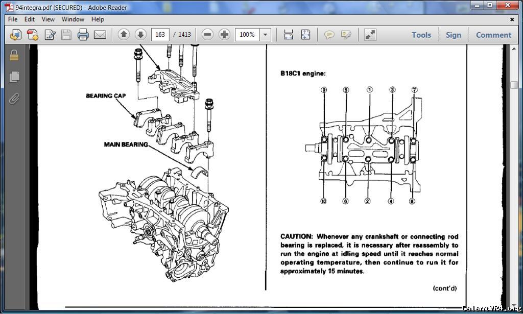

Honda lists that as the break in procedure for new bearings.
i do the same. i fire it off, keep eye on AFR's, check for leaks, knocks, etc. let it run till the fans cycle a couple times (usually the 30mins or so) probably dialing in my idle AFR's along the way. once thats done ill move on to driving it around and starting my tuning. it will see boost before the end of the day thats for sure.

It say let it idle till operation temp, then continue to run it. It doesn't say continue to idle, but then again it is pretty vague.
My assumption would be the intent is to make sure the bearing expands as much as they can so they are seated firmly in the journal and there for less likely to spin on the next cold start.
It's hard to make ever new part happy at once but it does not seem like a good idea to idle for 30 minuets with brand new rings and hone.
