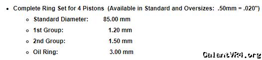

This is what the website says for the rings I ordered. I didn't see this page until after ordering them. If .50mm is .020", then that means 1.50mm for the second group is .060"???? Why is it so massive?

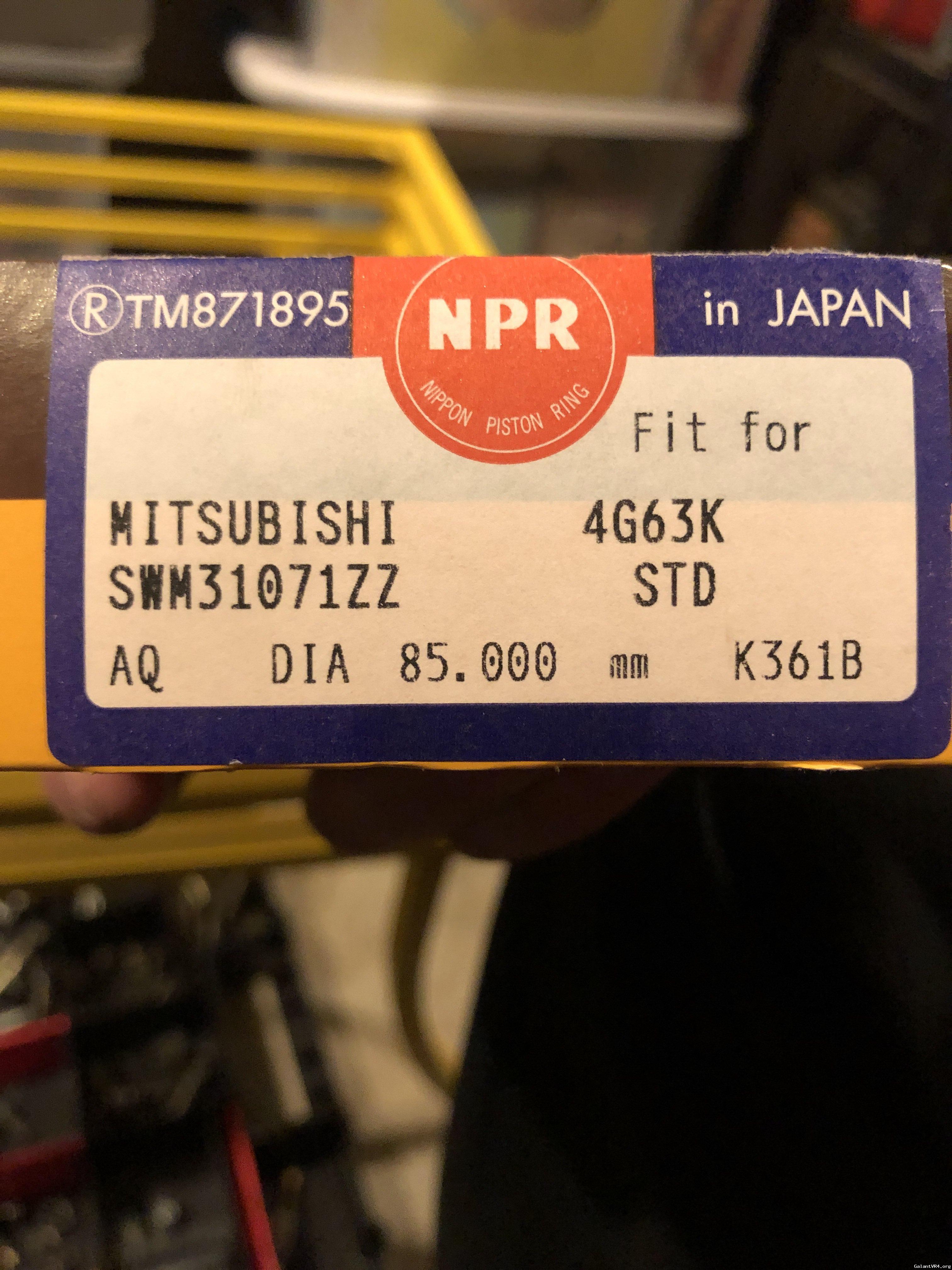

Here's the box, if it helps.

Those group measurements are referring to the thickness of the rings. First group is top ring at 1.2mm, second group is second ring at 1.5mm, and then oil control rings are 3.0mm in diameter. However I believe these rings are for the 7 bolt engines, as I am sure the 6 bolt E39A Galant VR-4 rings are 1.5mm, 1.5mm, 4mm respectively.

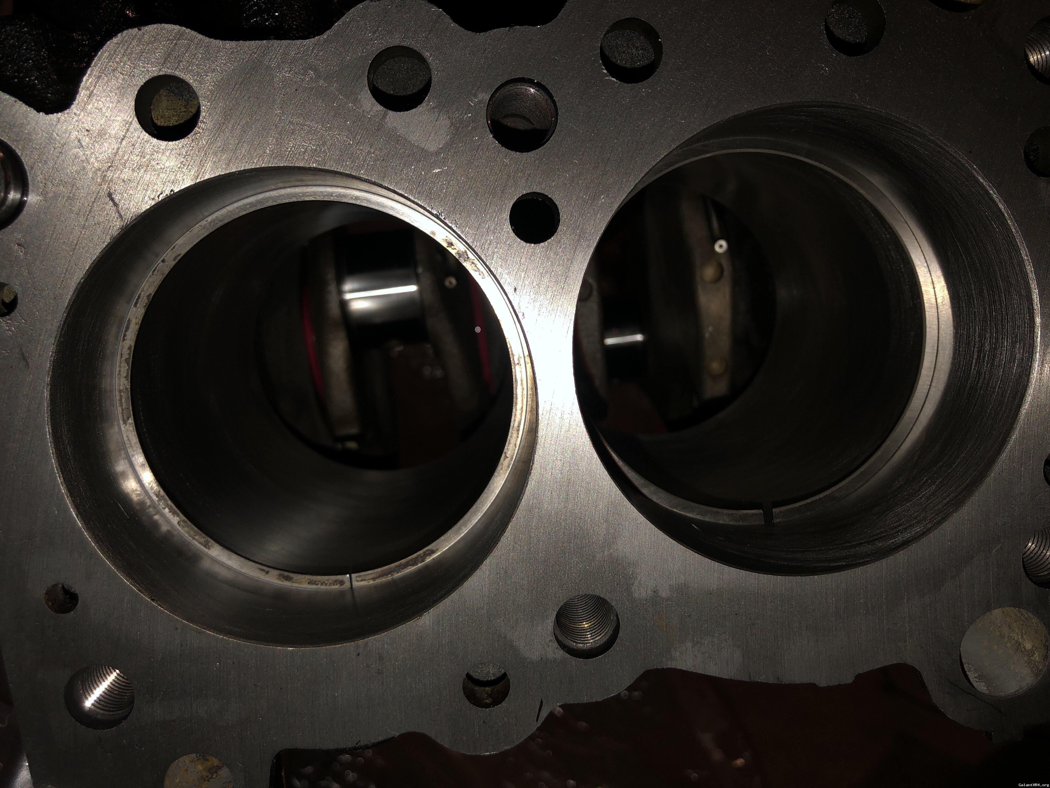

Some more feedback on this (from another board member experienced with machining who mentioned it to me):
Machine work looks a little questionable, both on the right bore and the deck. Deck looks inconsistent on the surface finish.
The bore should probably be checked, because judging by the lack of crosshatching and a very rough surface finish, the excessive ring gap may be caused by the wrong grit honing stone, run too slow with the incorrect lubricant, and now the bore is oversize for stock rings. A rough finish would eat that ring set in less than five minutes, and probably collapse/break a ring land when they seize up and weld themselves to the bore from the friction.
That block may need to be re-machined at a better shop.

...sh*t. That's the worst news I've gotten in a while. I'm confused though, as the original rings still have correct gaps. If I switched around the rings in that picture, then the ring on the left would have the bigger gap and the right bore gap would be correct. It's the new rings that are the problem. Also, I'm new to machinework so I'm probably wrong, but isn't that finish in the bore the crosshatching? I'll take a picture with a better angle.

Perhaps the photos are not clear. And your additional feedback does sound like the rings had an issue. Do you have bore measurements?
