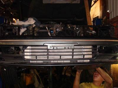

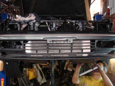

so bought a JDM bumper today tried mocking it up and my damn ETS core hits it... any tips on how to install it? i dont want to cut the slats in the middle... and ive seen some people here that have the ets core installed with out those middle slats on the bumper cut... can you guys chim in on what to trim?

Its hitting in the bottom and it seems like the core sticks out too much for the bumper to be pushed ann the way into the bracket... You guys are right i need to re position the core itself
