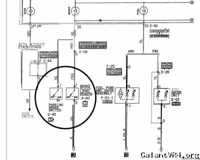

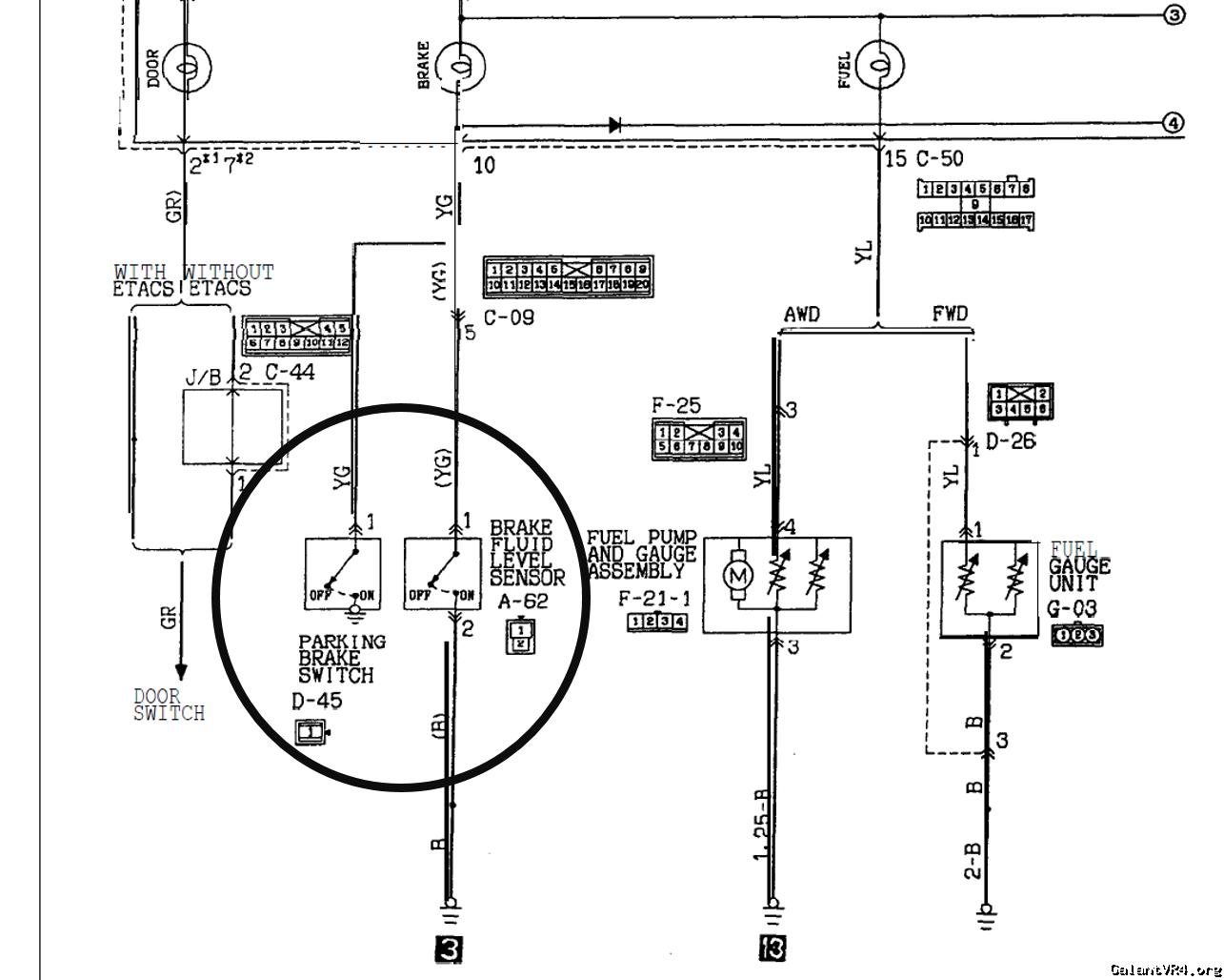

Here is the service manual schematic. I do not have my reservoir plugged in and my light does not come on. I guess you can use that as a troubleshooting tool though.
Good luck
-Garrett

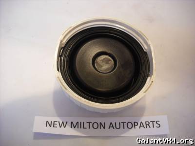

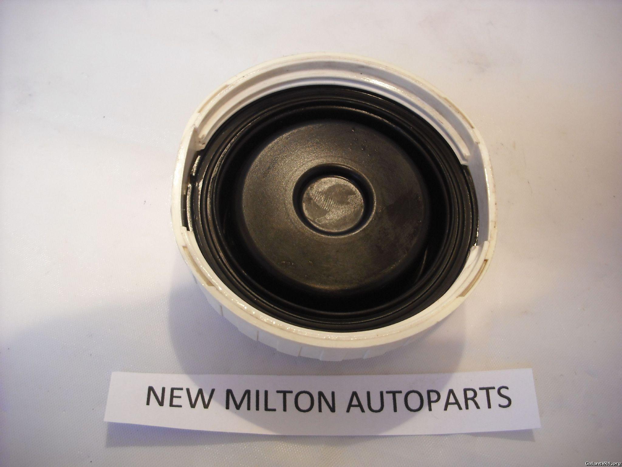

Check the rubber gasket under the cap of the fluid reservoir.
Shape should be like this:
If not, will make the dash brake light stay on always...just massage it to bring it back to this shape.
