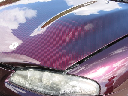

I saw someone on dsmtuners who just sprayed over his cf hood with candy paint. It still shows the weave and it looks good IMO.
mitsuturbo
Jun 2, 2008
3,551
Near Seattle, Washington
That looks amazing. I like it a lot.
The car is all painted the same color, yet you can see a little hint that it's not stock, and has been upgraded. Rather than ALL UP IN YO FACE, LOOK YO I GOTS DA SEE-EFF HOOD DAWG!
