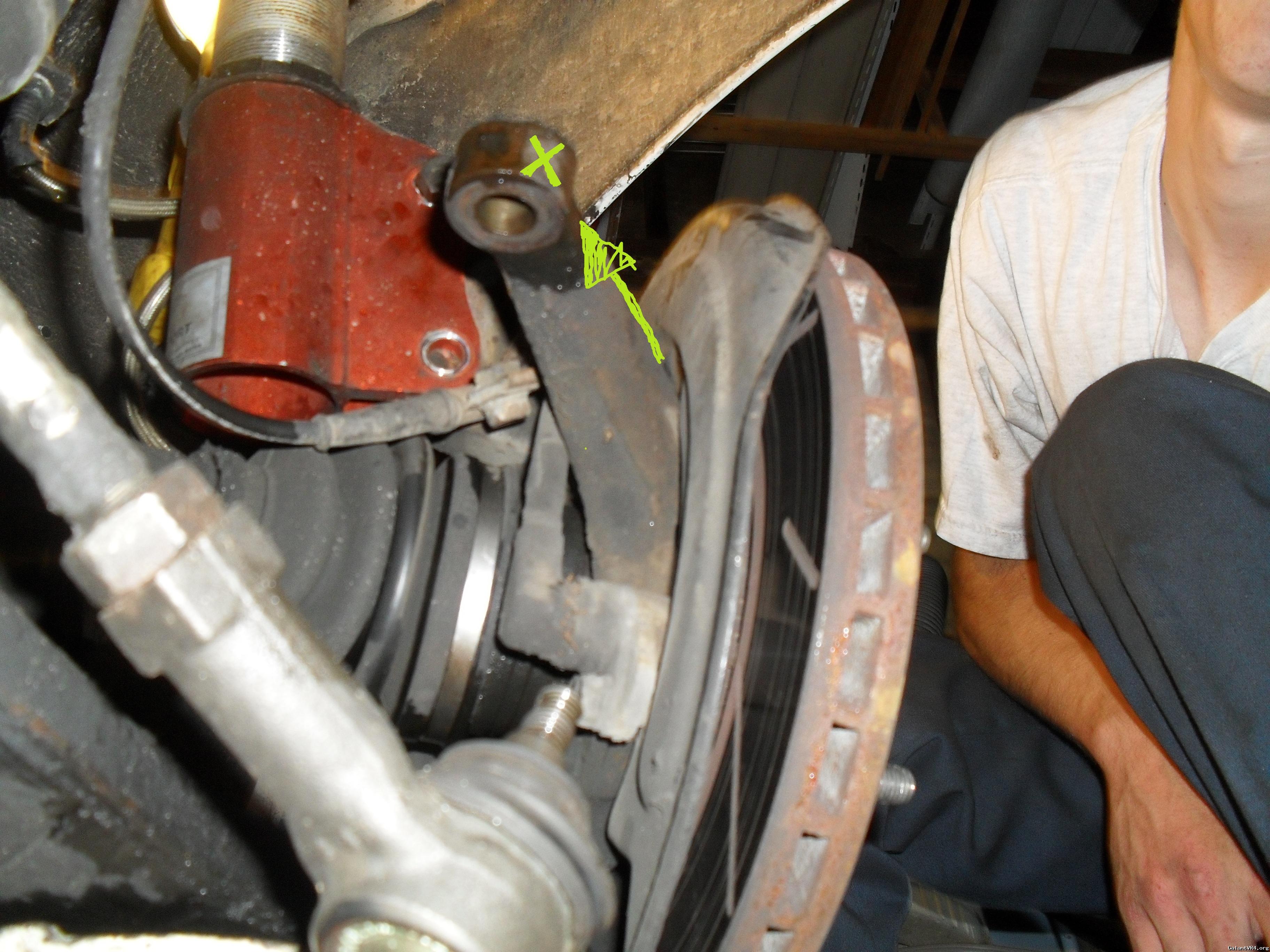

Try what JSchleim18 said, and for anyone trying to get the outer tie rod out of the tapered "thru" hit the hub assembly a good amount with a ball pien hammer, and it will come out. Be cautious of the noise, where some earplugs or muffs whatever you got. Right where the green X is.

The above works great! Also works for lower arm ball joint to hub, but is slightly more awkward to swing the hammer.

Definatly a bit akward for a hammer, luckly you get new boots when you buy new ones.
