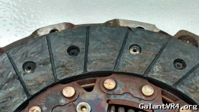

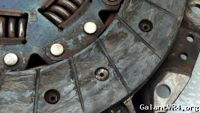

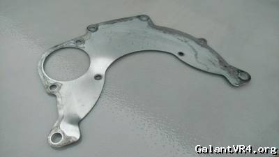

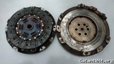

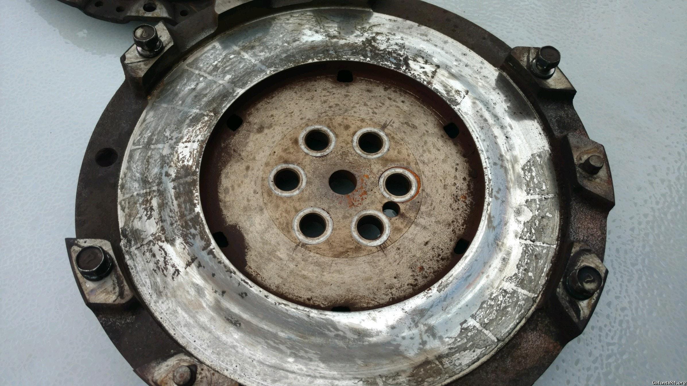

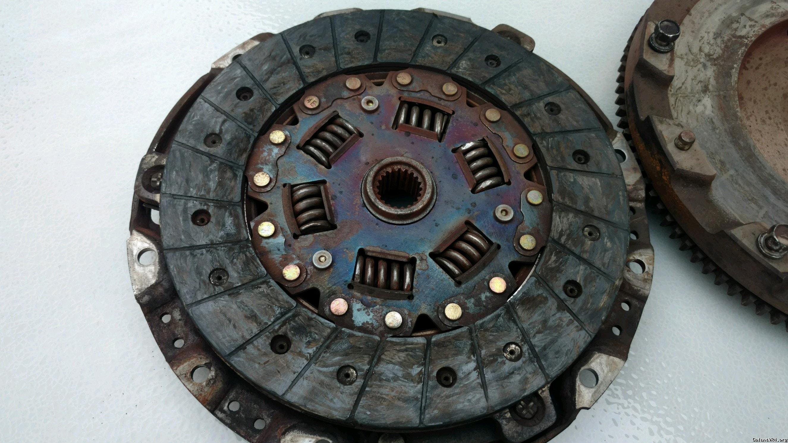

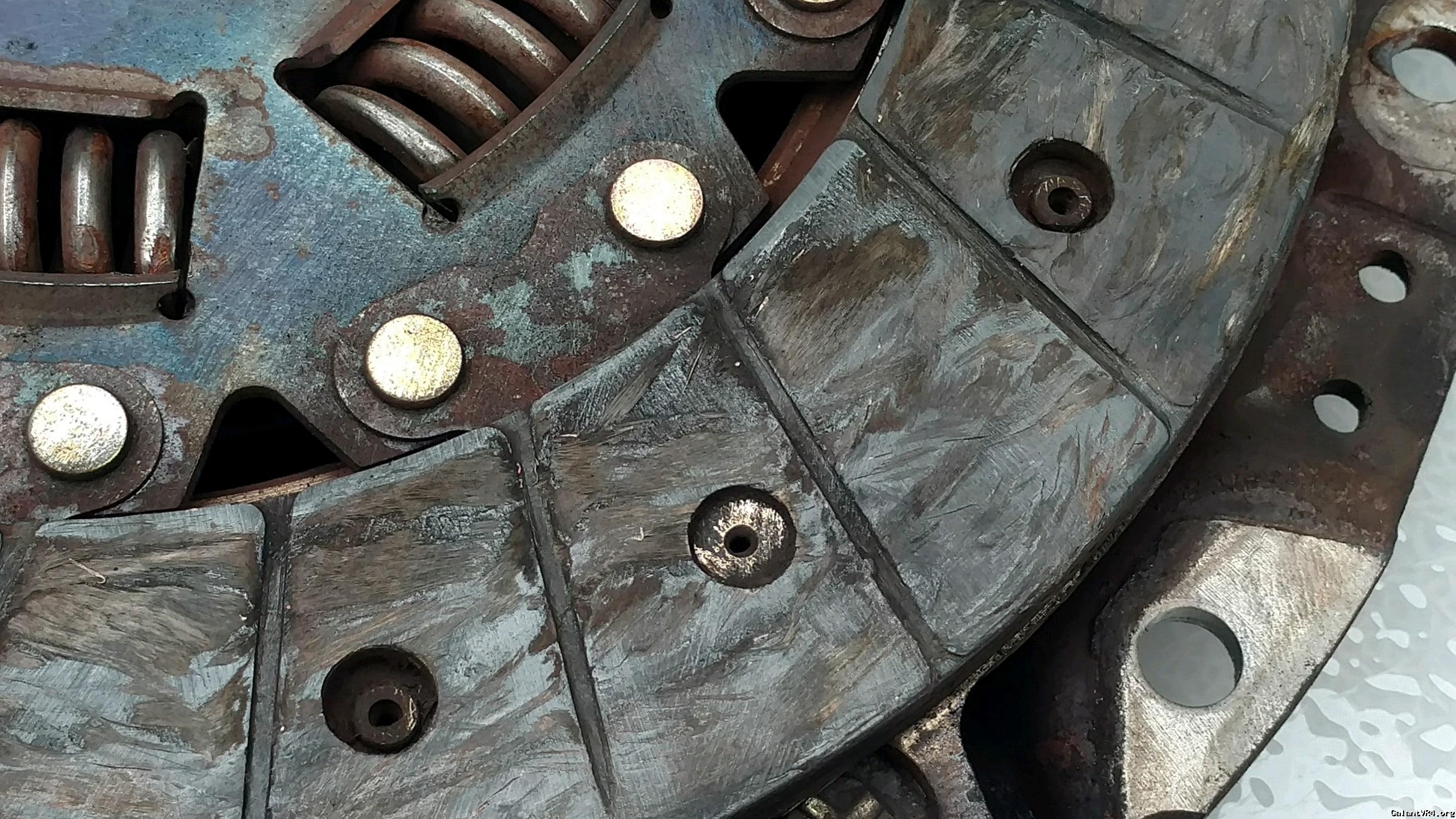

I'm such a sic pup... A cracked bell housing has ended up leading me to not only fix that issue but to basically tear the entire car apart and fix EVERYTHING. So basically I have torn #1607 apart. Just pulled out the clutch and wanted an opinion if I should replace it. I'm guessing the answer will be yes but just wanted verification from those of you that are far wiser than I. Clutch does not slip when I drive the car but the disc is looking a bit thin and the flywheel is pretty glazed. Also on a side note does the starter backing plate normally have some bend in it or it supposed to be dead flat? Mine has some subtle undulations that look Factory. Thanks for any input... I want to take care of crap while I have everything apart.

That clutch and flywheel look okay to me, just a bit dirty, but no real bad heat spots or chatter marks and the meat on the disc looks okay.
It's a big job to take the tranny out though so if your thinking about turning up the boost at any point in the future I would replace/upgrade it and get the flywheel machined at the same time.
It's your call though and totally depends on your plans for the car.
IIRC my starter plate was dead flat, no bends or kinks like yours.
10,992
That starter plate has been tweaked by the movement from your broken block. Certainly fixable or usable straightened.

First, check the step height on the flywheel and ensure it's in spec.
Regarding the clutch, personally, I'd replace the clutch while the trans is out. But, I hate pulling the transmission. The one pictured looks like a stocker to me, which are fairly cheap. Even if the disc looks good (and it does) I'd still replace it. The problem with those discs is the springs pop out, which will leave you with a clutch that won't disengage. If you look at your disc, it looks like those damper springs have already taken an impact or two. If I were you I'd throw a whole new clutch assembly in, but replace the disc itself at a minimum.

Agreed. Not only did the engines cast iron transmission mounting tab break off (where one of the pins passes through the starter backing plate) but the bell housing itself had a 14 inch crack in it. diambo4life saved me by offering up a new bell housing and I was able to weld up the engine block tab cleanly but the starter plate does not line up anymore with where the pins on the block are located. I am certain that the pins are in proper alignment so the backing plate itself is actually spread out from the forces involved (as you stated) with the broken engine block and movement of the cracked bell housing. I ordered up a new starter backing plate for JNZ.

Thanks everyone for your input. A new clutch it is... So I read and read for hours about all the clutch options. I have only a mildly modded car... prob around 240hp... maybe someday might turn that up to 300 but not likely to bump above that. So from all the reading I did on this forum Centerforce and Southbend seem the have the least bad to say about them for DD use. So that is the direction I am leaning. The option of using a Kevlar disc is tempting.

To update this tread: So I ended up buying a brand new starter plate because the one that was tweaked was not really saveable. (The transmission bolt holes in starter plate would not line up with transmission.)
