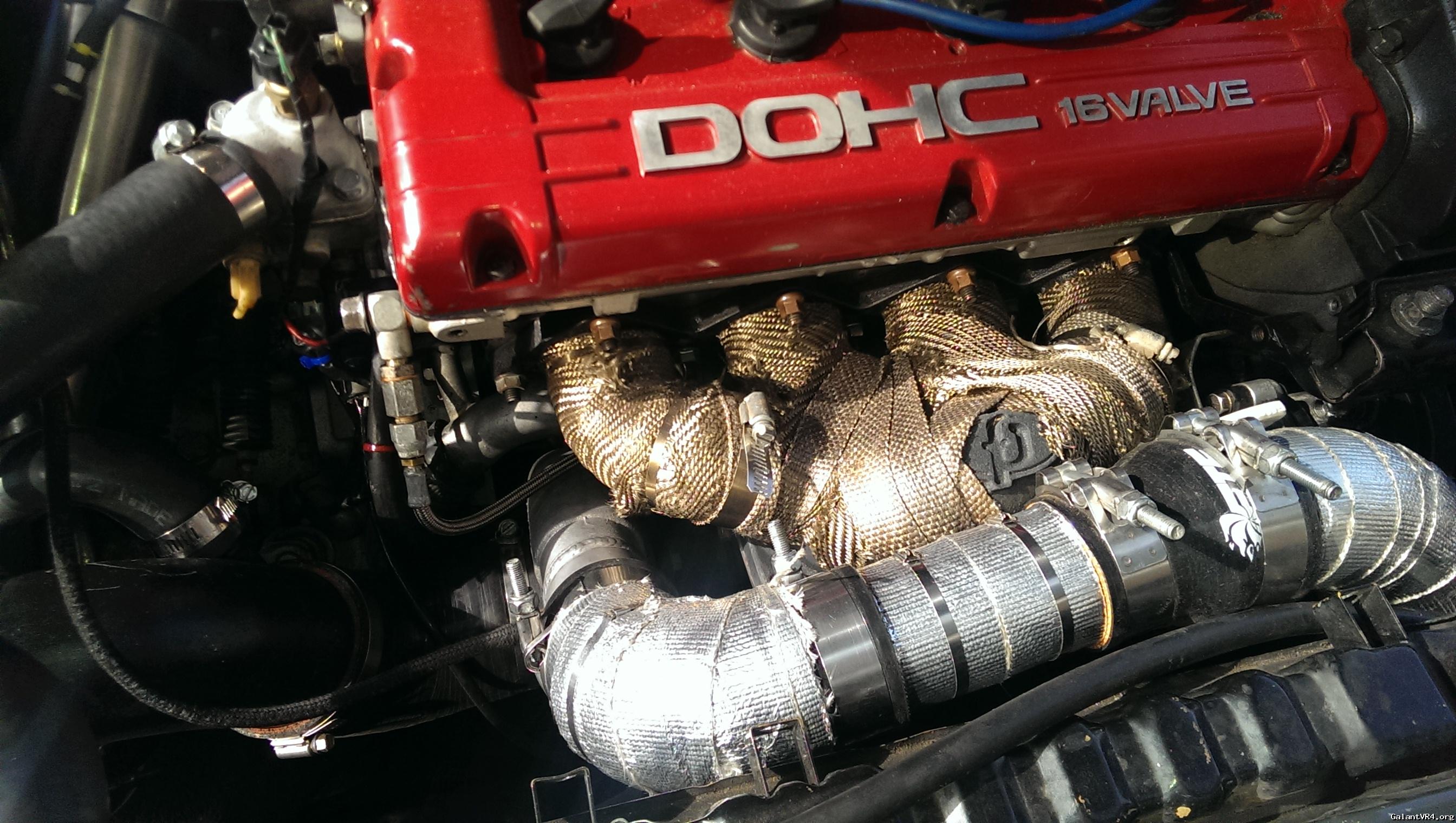

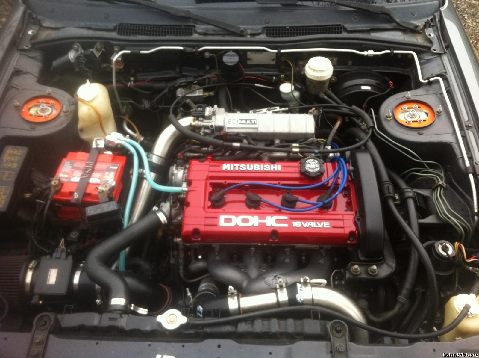

I had this:
Beautiful to be sure, but there's clearly going to be a heat-soak potential with the intercooler piping running right over the top of that sexy FP racing manifold. Now ever since I had my ETS FMIC kit installed, I was plainly aware of a loss of overall power when negotiating stop-and-go traffic. So long as I was moving, things were better, but once I would sit at a few lights, there was a noticeable loss of power. Not much, but come on; we all notice even a little bit, right? It's what keeps us coming back.
Anyway, I got the new motor and such (see my build thread), and in the process, put in this beautiful FP manifold. The performance increases with the new motor were quite nice, but the heat-soak power loss was more noticeable.
So I wrapped it up.
After wrapping the exhaust in titanium heat shielding, and wrapping the IC piping in Thermo-whatever tape, the difference was quite impressive.
My car doesn't stall when coasting to a stop anymore. Like ever. I'm not calling heat-soak mitigation a panacea of idle problems, but for me, after going through everything else with EHMotorsports (and even replacing my TPS), this is what did it. Now it wasn't happening every time I would coast to a stop. Maybe 15% of the time. But now, 4 months on... not once.
And performance dips during stop-and-go are much, much better. That's to be expected, sure, but it was tangible.
So yeah, pretty neat.

Looking at your setup EfiniX you might be good about not melting the coupler but I would keep a close eye on them. I had a aluminum radiator that put my pipe closer to the manifold, I see your on the stock radiator so you might be better off.

One thing I would change right away because astetically it bugs me is ditch that coupler and weld those two IC pipes together so you have one pipe going from compressor outlet to the IC. Then of course rewrap the pipe. I don't see any reason why there should be two pipes there.
As for heat soak causing a bad idle and stalling, I would look into vacuum leaks and electronics. Have you tested your IAC lately? Have you had your ECU inspected within the last few years?
What kind of coolant are you using? And the last time you refilled the system did you burp it properly?

I'd replace all that wrap with the manifold blanket instead. Cleaner and would be easier to service those manifold nuts that keep coming loose. /ubbthreads/images/graemlins/wink.gif
that has to be one of the cleanest engine bays around though, looks great. and I imagine that elbow isn't welded to the intercooler. just that coupler in the middle looks redundant.
11,982
Mine is one single pipe from turbo to intercooler. Two easy to reach clamps and it's off. /ubbthreads/images/graemlins/dunno.gif
11,982
There is a straight coupler behind the driver's side headlight, and the one at the turbo outlet.

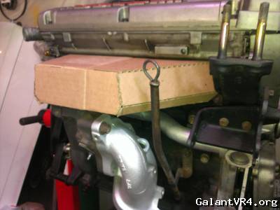

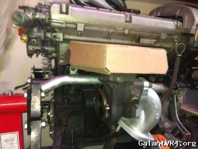

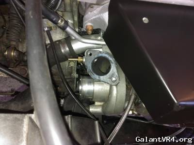

I got my ass outside and made a heat shield today.
Didn't take a great picture but here's the idea.
It wraps around the bottom.
Also tapped my turbo housing today, but you can see the installed shield.
So now I have ceramic coating inside and outside and shields.every little bit helps. Would really like some hood vents next.
