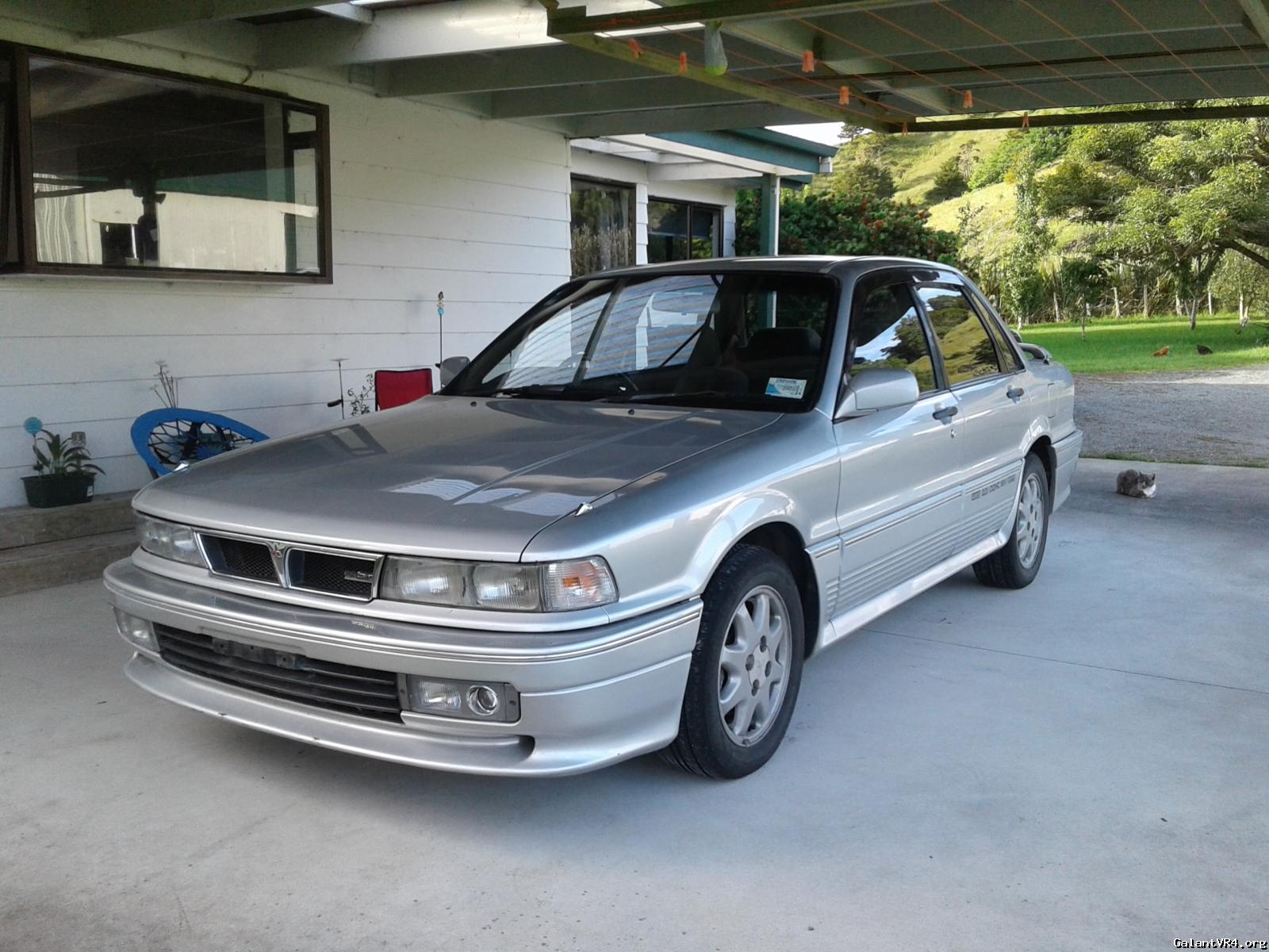

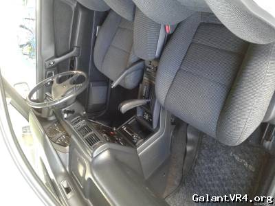

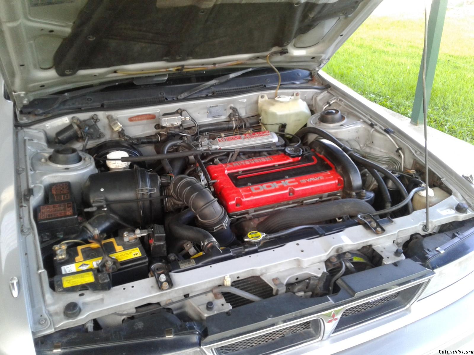

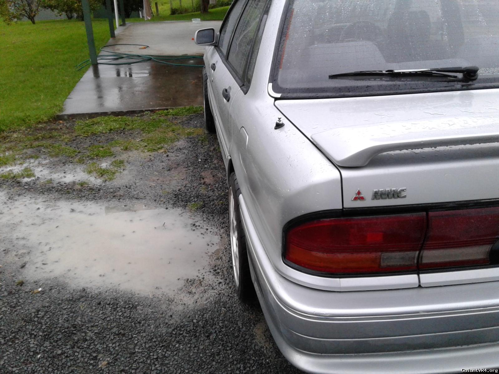

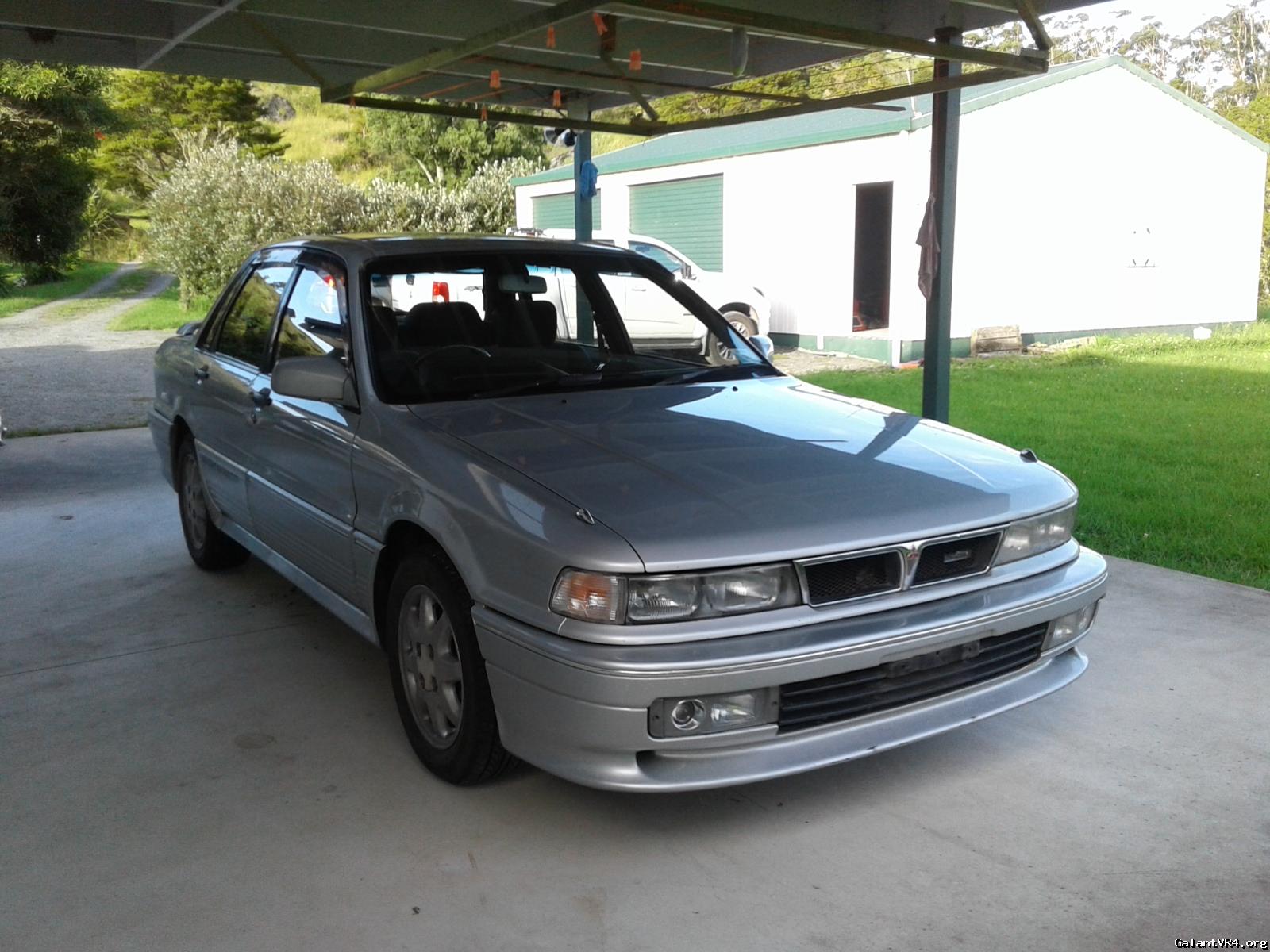

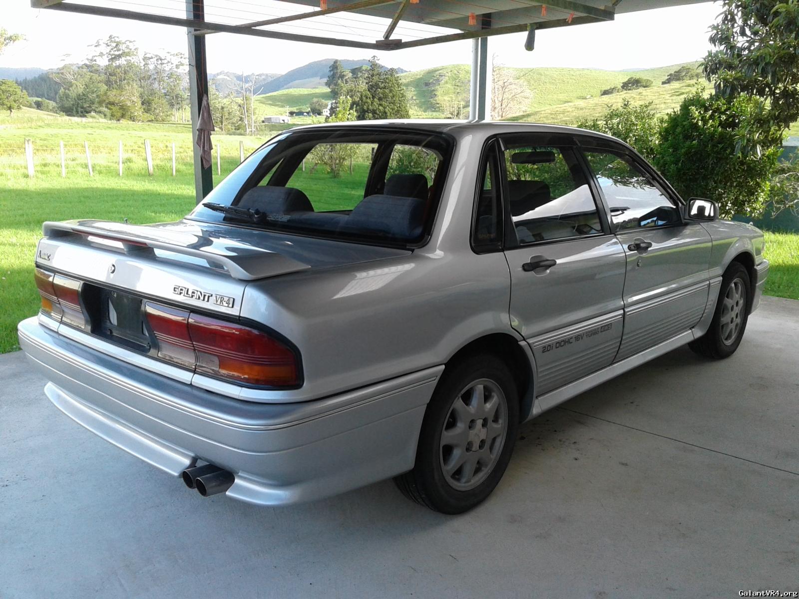

I have spent the last few days going over the car and fixing little things as I can. So far I have:
Replaced the left rear window rubber as it had become deformed, replaced the right hood hinge as the pin had worn out, replaced the rear hood seal as it had been torn, replaced one window toggle switch as it would only work one way, replaced the right front tie-rod end, bled the brakes, did a temporary bodge to the shifter pivot to replace the bushes which had turned to dust, replaced the console lid vibration isolating rubbers with 5/16th blind grommets, replaced the hood strut bush with a grommet (thanks Turbo Tom).

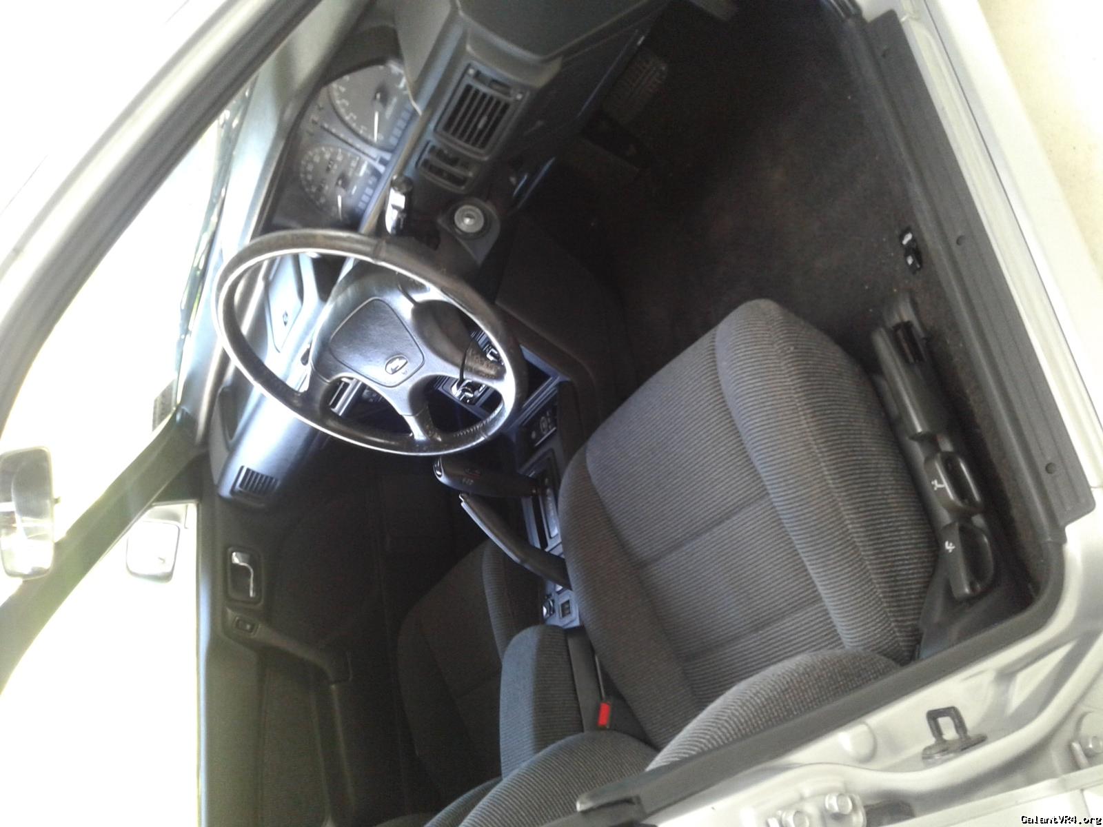

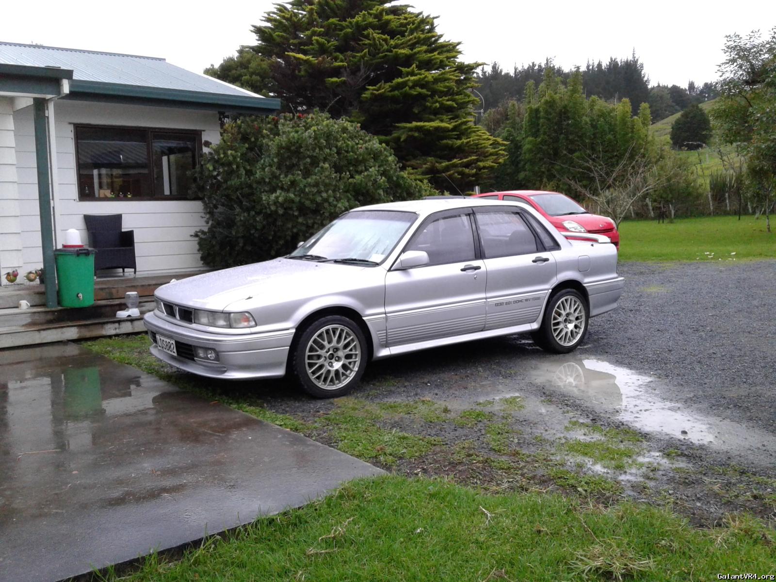

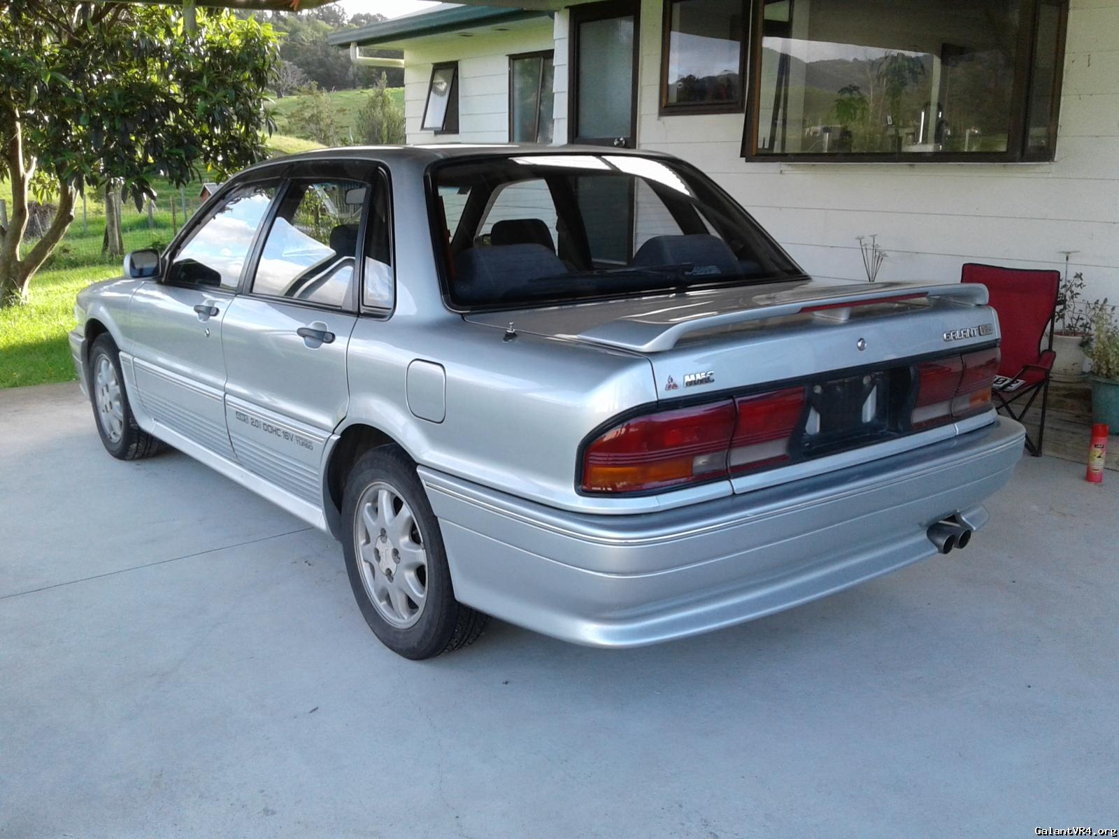

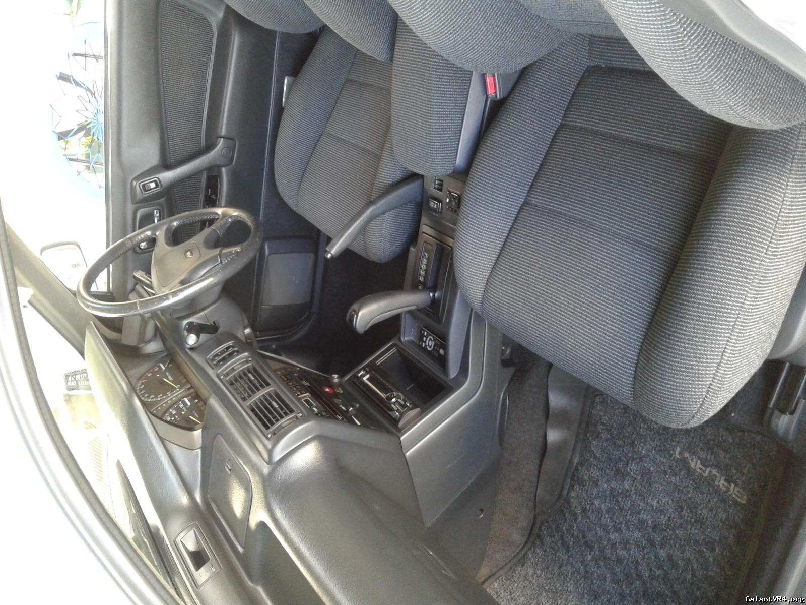

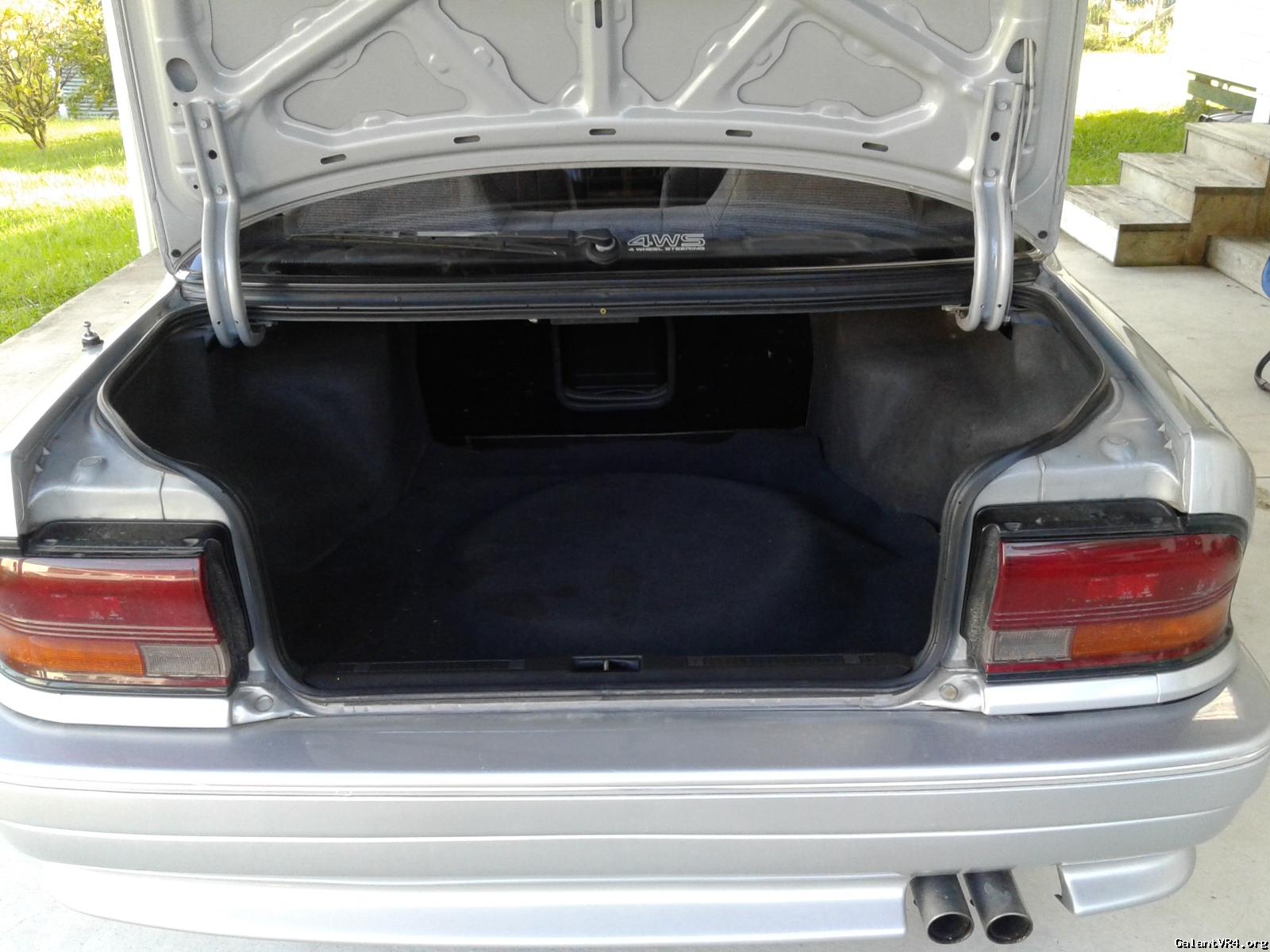

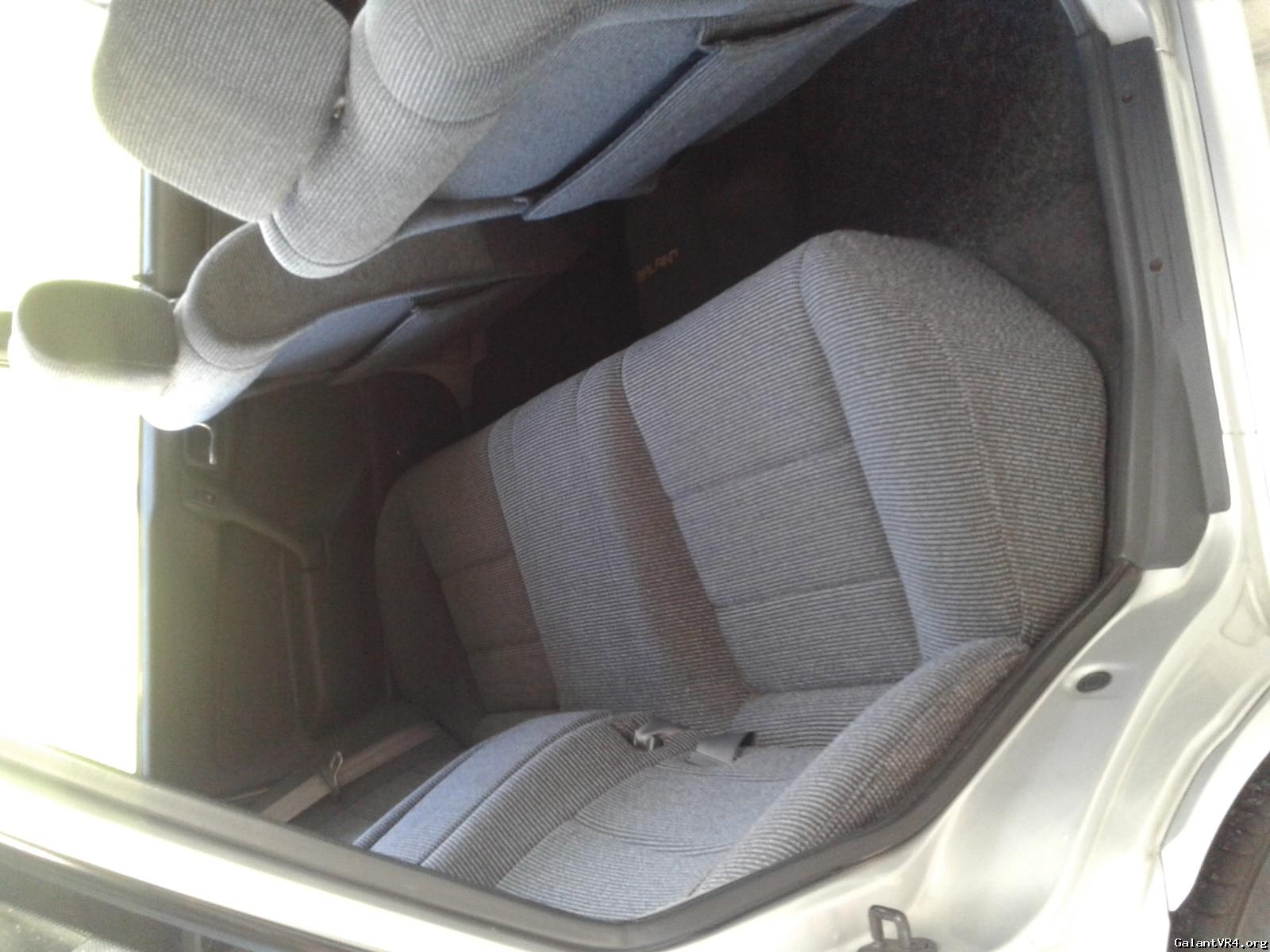

Here's a few photos. Sorry for rotation of the last three, I don't have an editor on my tablet.

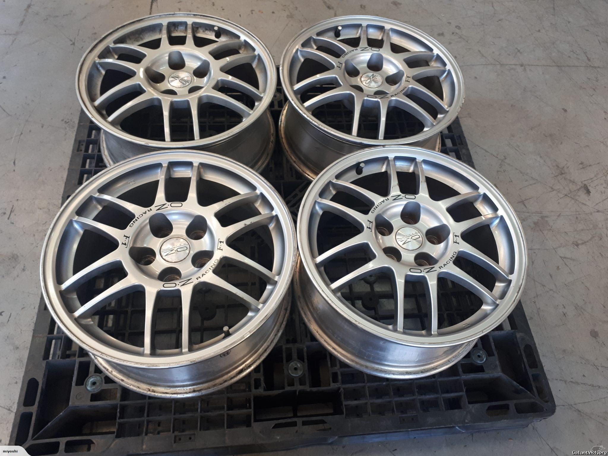

Nice looking car. Wish we got silver here in the states. Also, I think those are Evo VII wheels? Don't believe i've seen those on a 6G Galant yet. Good choice.
91vr4auto
Jan 29, 2018
18
New Zealand

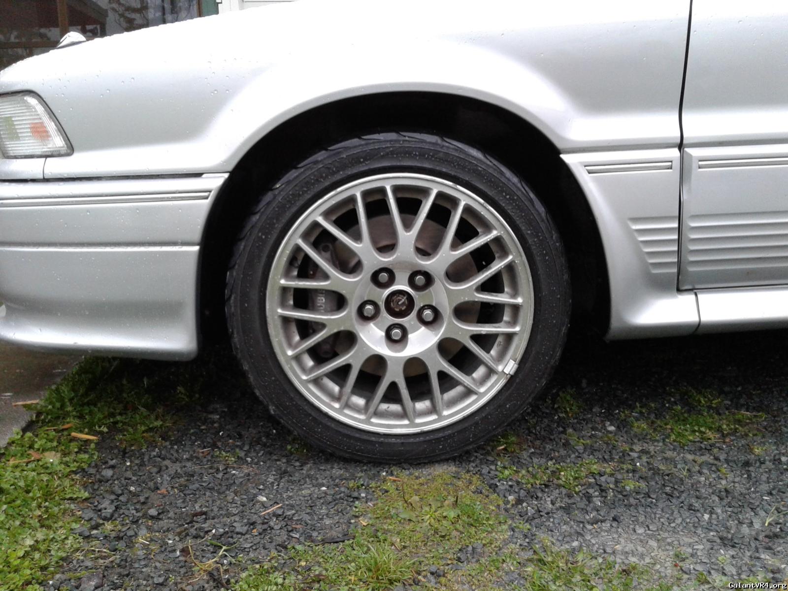

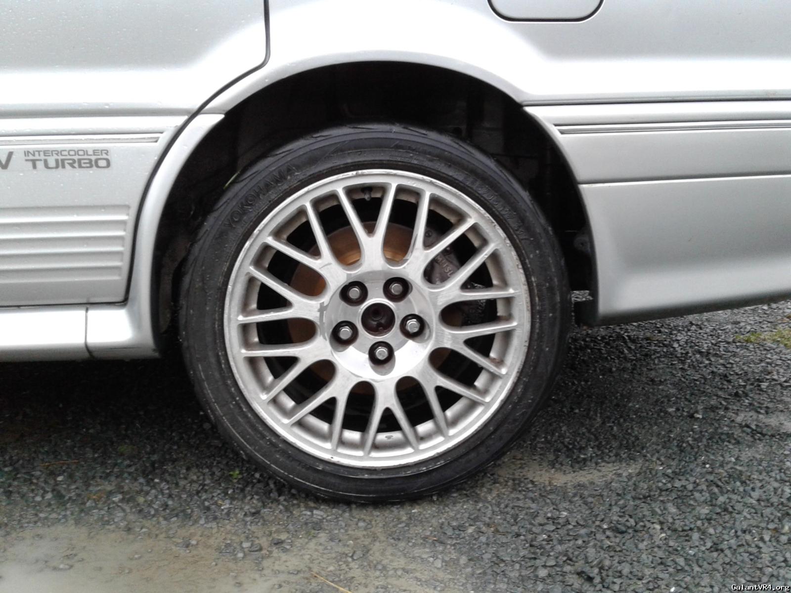

Thanks, yes they are E7 wheels. They weren't my first choice, but they came up at the right price, and they have grown on me. This is actually my second silver auto, the first being a 1990.

The poke from the front is making me think I may have change offset or width, or both. The rear is pretty much spot on to my mind, but the front looks like a deuce coupe without fenders! I was thinking maybe E5 wheels, 17x7.5, although they are still 38p, which would pull the front in 1/4" and then a ~1/4" spacer on the rear to push the outside edge back to the same position.

Same here... I didn't know they had a cloth seat option either... but then I've only seen maybe two other VR4s and they were leather like mine...
