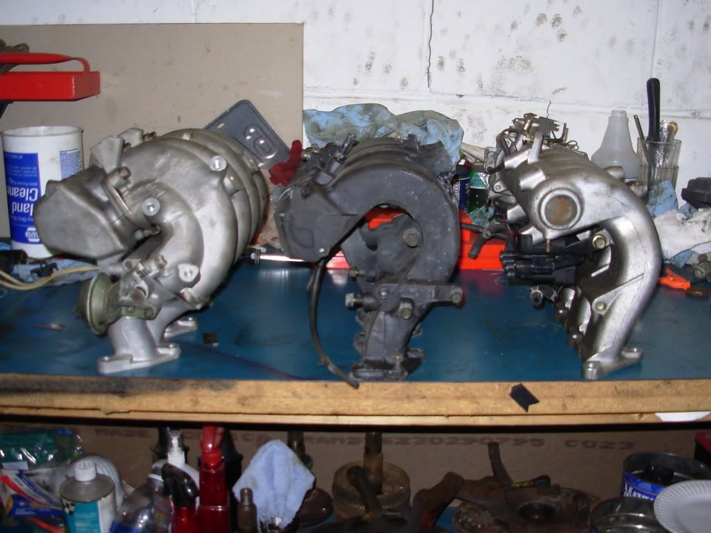

Why do people still not know the flange on a Cyclone intake manifold? It's been around for 20 freaking years, it has 1G style ports.
Cyclone , 1G, Evo 3 manifold.
