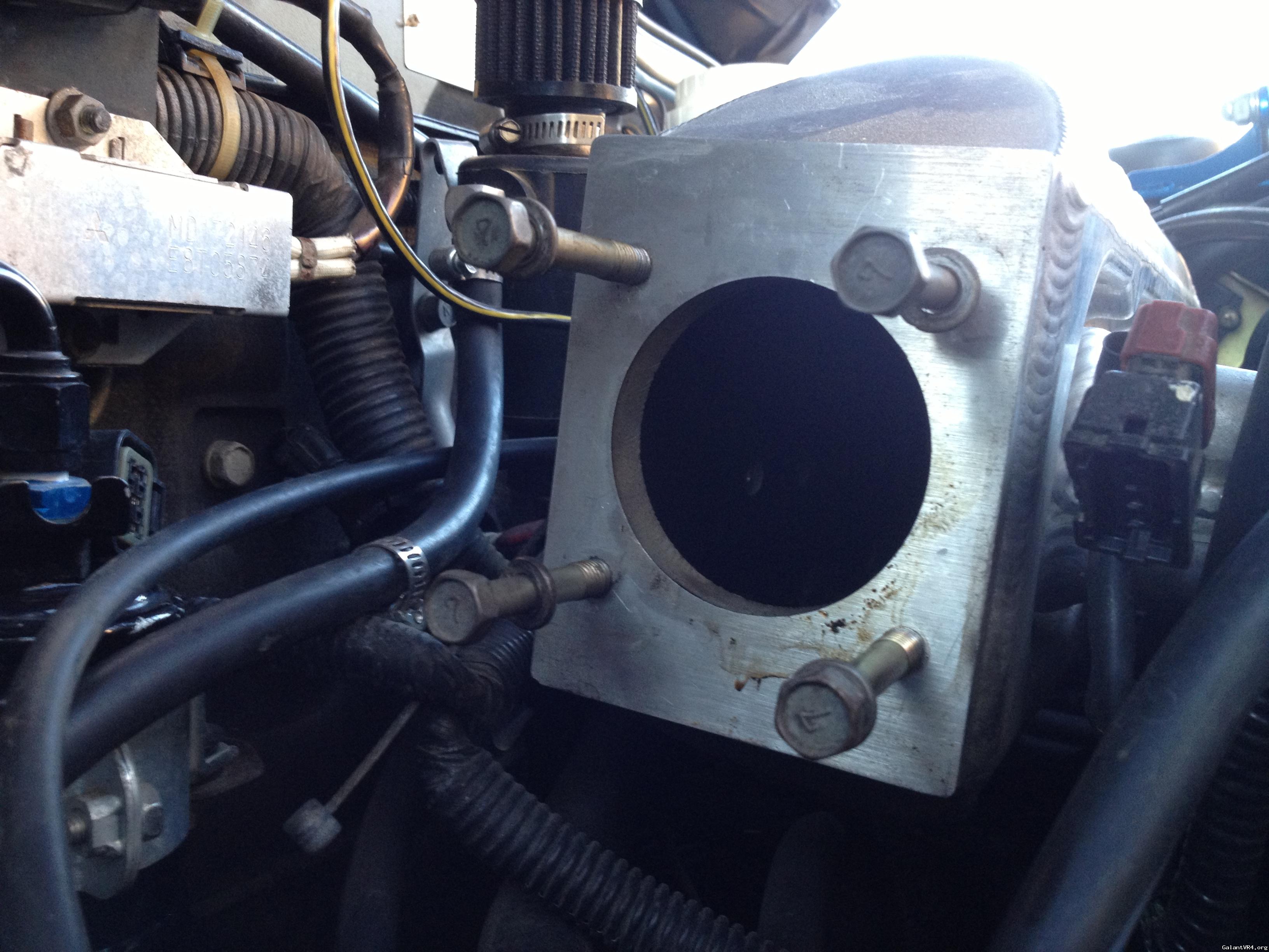

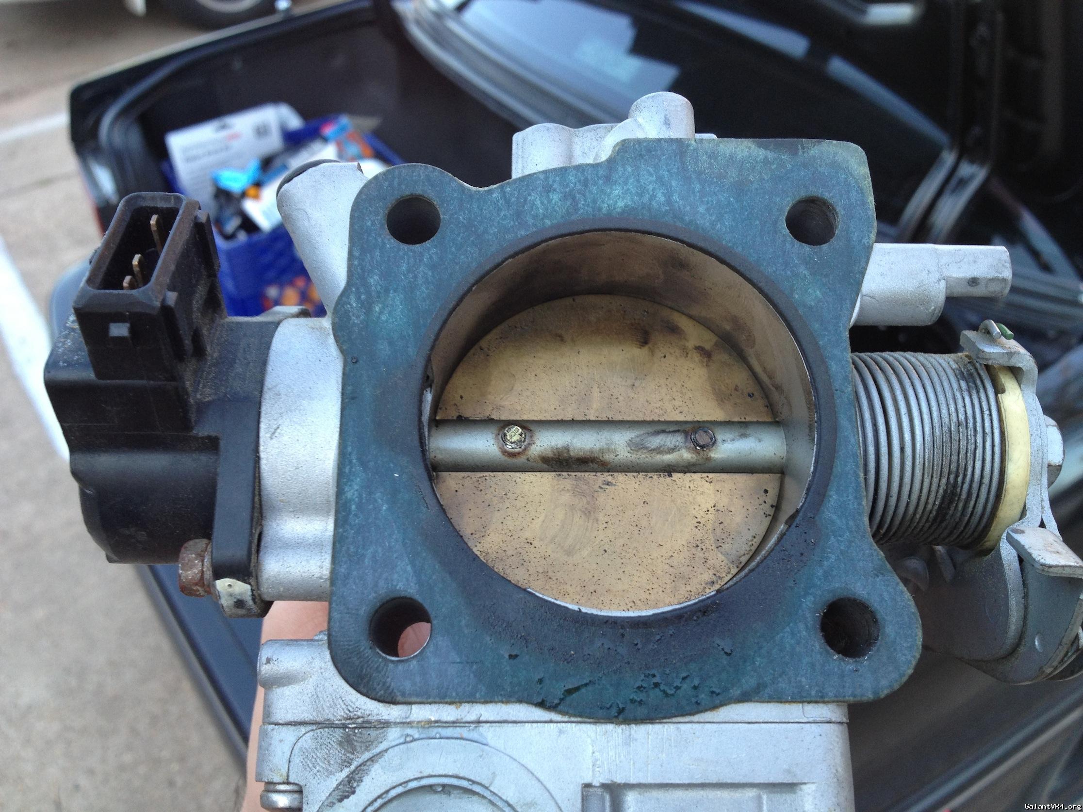

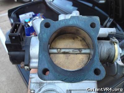

More out of curiosity than anything I'm not exactly sure why I have residue on both the intake manifold and the throttle body. Is this indicative of either:
- poor crankcase ventilation
- worn seals on the 14b
- or perhaps something else?
- leaky valve stem seal on cylinder #2
Any input is greatly appreciated.

Typical. Oil is circulating in/around the valvetrain. At 3000rpm, your cams are turning 1500rpm. That's 25 times per second. You've got 16 valve springs being compressed and released at those speeds. I don't want to say the oil is vaporized, but you know what I mean. And the PCV allows engine vacuum to draw that air out of the head. Thus, oily residue in your intake.
And I'm pretty sure oil in the IC plumbing is a function of old seals on the turbo.
Of course, I could be completely wrong, in which case someone will paraphrase something from Wikipedia or an old Hot Rod Magazine article here in a moment.

Quoting LIV4PSI:
Wouldn't an air/oil separator help?
I have an RRE Catchcan for the PCV. I have yet to add one for the valve cover vent.
11,982
That's probably where you're getting the residue from then. I have both ran to a catch can and get zero residue in my IC pipes or around the throttle body. They're squeaky clean inside. /ubbthreads/images/graemlins/smile.gif

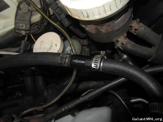

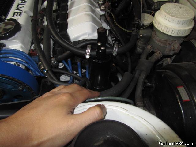

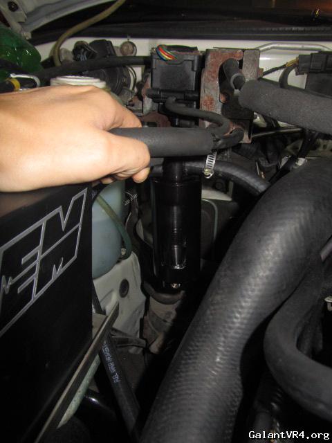

If you read the VFAQ on the PCV system, then it will help you greatly. I chose to go with "Improved Factory Setup". Make sure to get sealed cans. The VFAQ explains why you shouldn't use breathers. I am no expert, but I tried to follow setup #1 to a tee. Open to comments on this as well.
I chose to use Boomba sealed cans. Calan on Tooners makes great cans as well and they are sealed. These have a window so you can see inside and come anodized. One inlet and one outlet at 3/8". Drain is easily accessible. Mounting is done via a horizontal bracket.
PCV to catch can to intake manifold.
Check valve.
VCV to catch can to air intake pipe.
