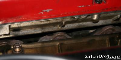

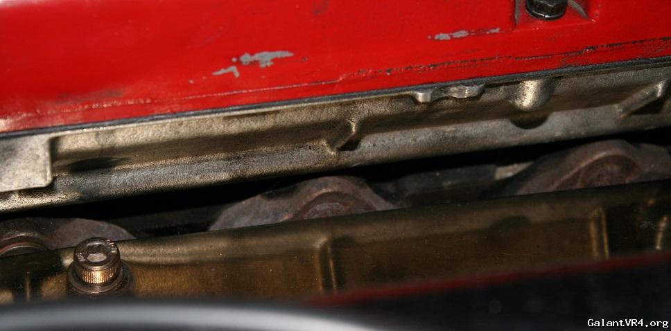

There appears to be oil residue on the exhaust manifold near where the manifold meets the head. By residue, I mean it looks like oil is blowing by/leaking and catching dust/particulate.
At idle I've noticed some nice plumes/clouds of smoke, especially at take off, every once in a while. The motor has been thirsty for oil between changes as well.
So, to me this all points to oil either blowing by piston rings or maybe even a head gasket?
Would a compression test confirm any of this?
How can I determine the root cause?

I agree with WOP but that would explain the oil consumption, not the residue. Your oil is going somewhere and if it's not leaking, it's burning.
How old is the engine, what kind of mods do you have, how much oil does it consume?
As for a head gasket, if your not loosing coolant then I doubt it the HG. It's either the rings or leaking past the valves. If it is the valve seals and you have stock valve guides then they are probably loose too. It's always worth doing a compression test. Either way it's a good way to find out the "health" of your engine.
As for the residue, try spraying some aerosol spray foot powder all over the area where the leak might be. These is a trick I picked up for finding leaks. The powder will change color with fresh fluid so after a few miles just look for the wet spot. At this point I'd be more concerned with the oil loss.

On my turbo colt I had the same problem, but I cleaned the area with a can of brake cleaner and then drove it around a couple days watching the area daily, turned out it was just the front valve cover bolts were loose enough to let some oil escape threw the seal and fall on the exhaust manifold causing "burn" marks like in your picture. A new valve seal and retorqued bolt and it was good to go. So just might wanna try that
