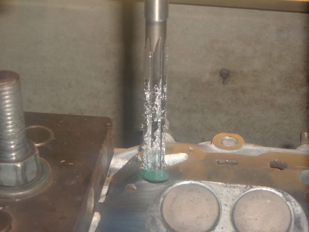

Oil port mod #2 for 4G63T
The head is a 2g head going on a 1g 6 Bolt short block.
This head has had oil port mod 1 done.
The head bolt holes have been reamed for the 1g head studs. To prevent any issues with oiling issues in the head, I have reamed the bolt hole that is in the path of oil flow to .500 the bolt hole was .470 the ARP head stud being used is .465 Leaving only appox. .005 total or .0025 clearance on either side around the head stud. I feel the addition .030 will alleviates any problem with oil into the head.
All ten head bolt holes need to be enlarged to .500

When we did my head we opened up all of the holes up to the stock 6 bolt size and the oil feed hole was made 0.500" up to just above the oil galley. It seems to be working fine so far. I also have undercut studs so I probably have a tone of flow to the head. I am eventually going to get some L19 headstuds so I'm sure I'll need the extra clearance. I have been thinking of getting the Magnus oil regulator for the lifters to try and keep some of the extra oil from collecting in the head. I worry about that when doing track days and having the revs up for long periods of time. Whats everyone's opinion on that piece?
