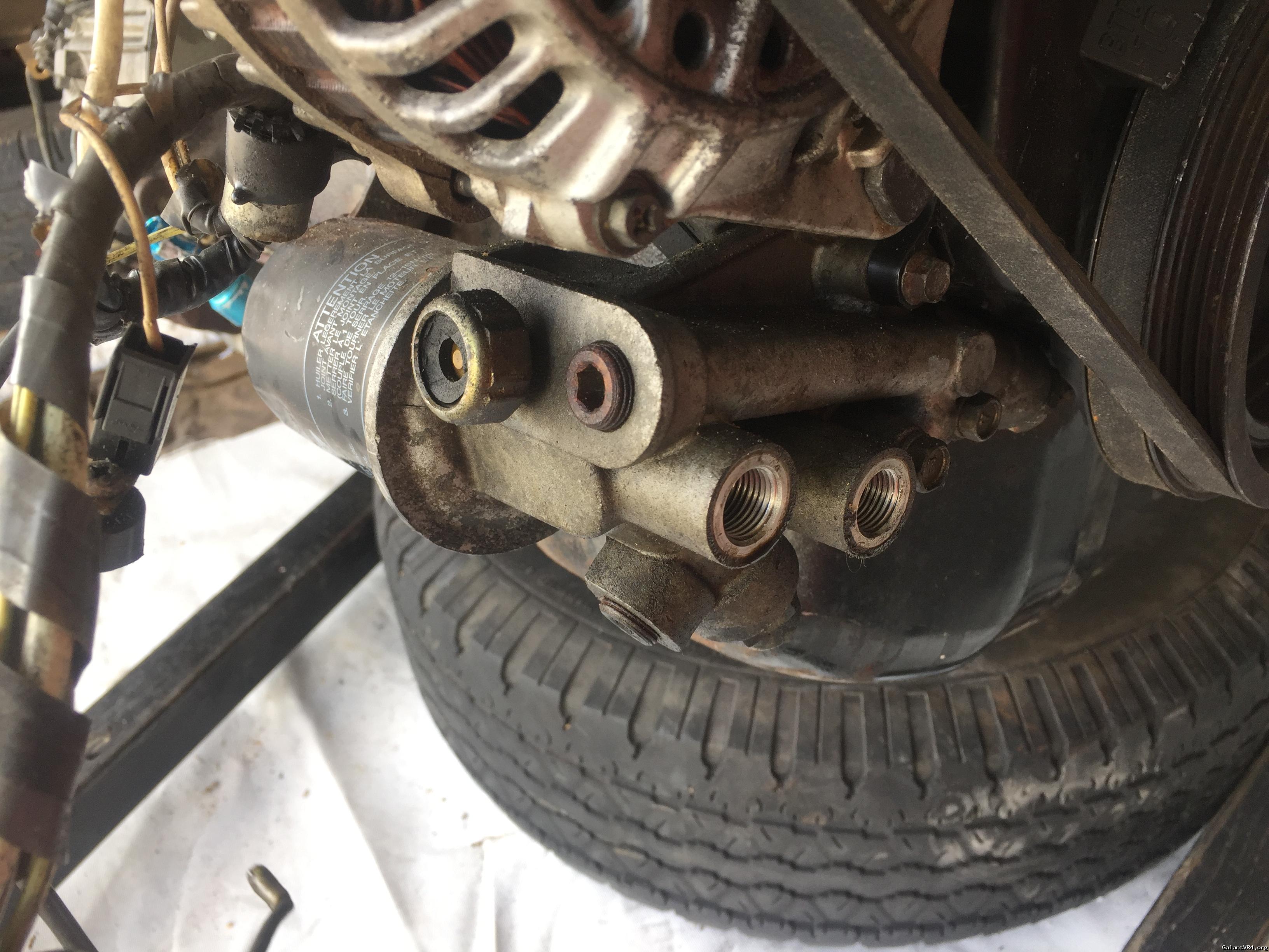

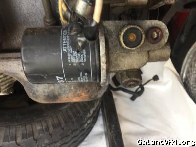

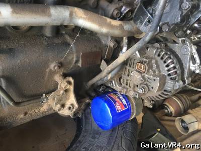

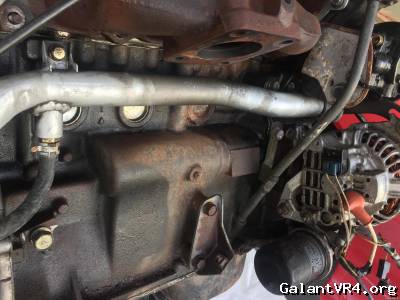

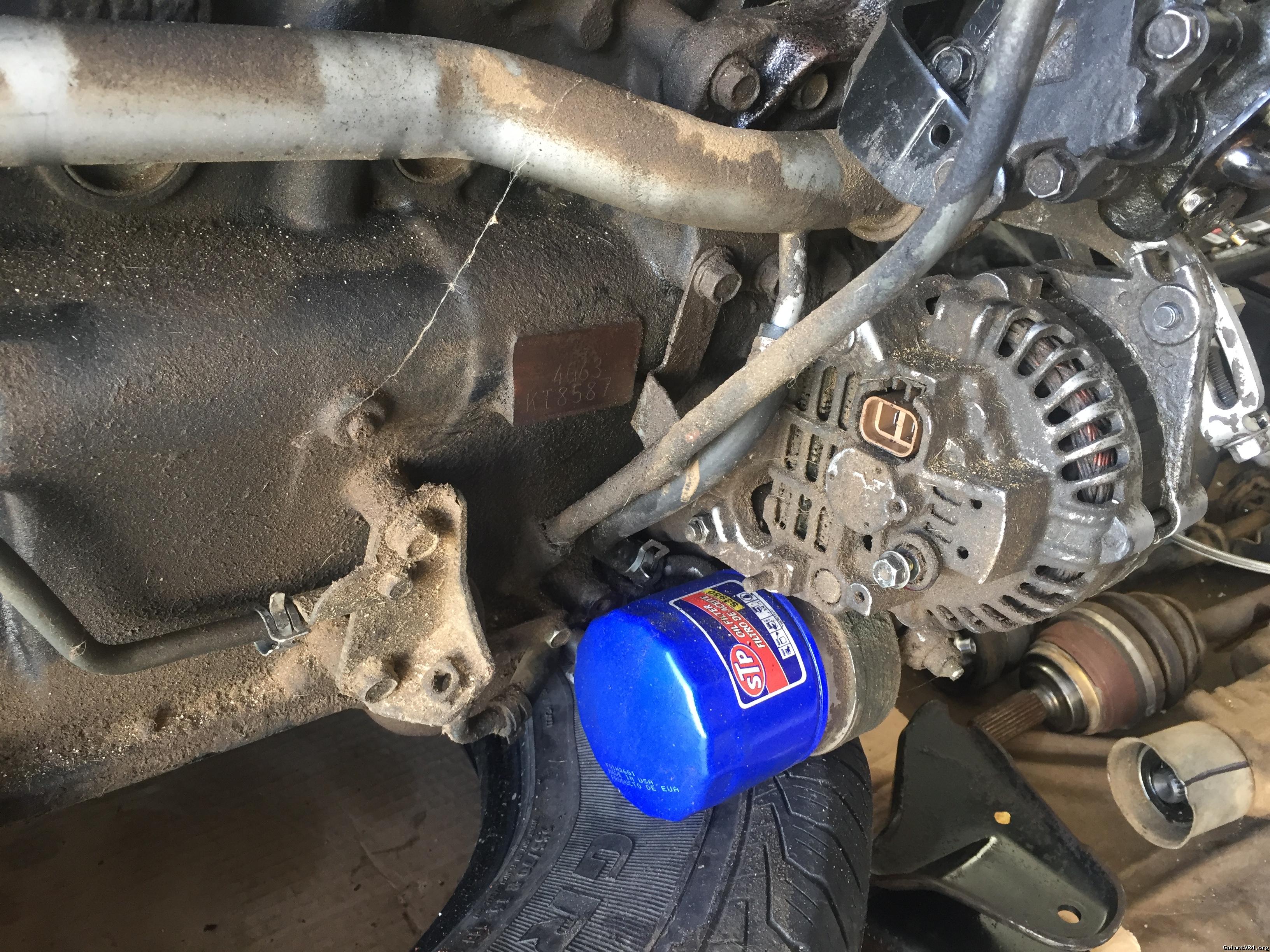

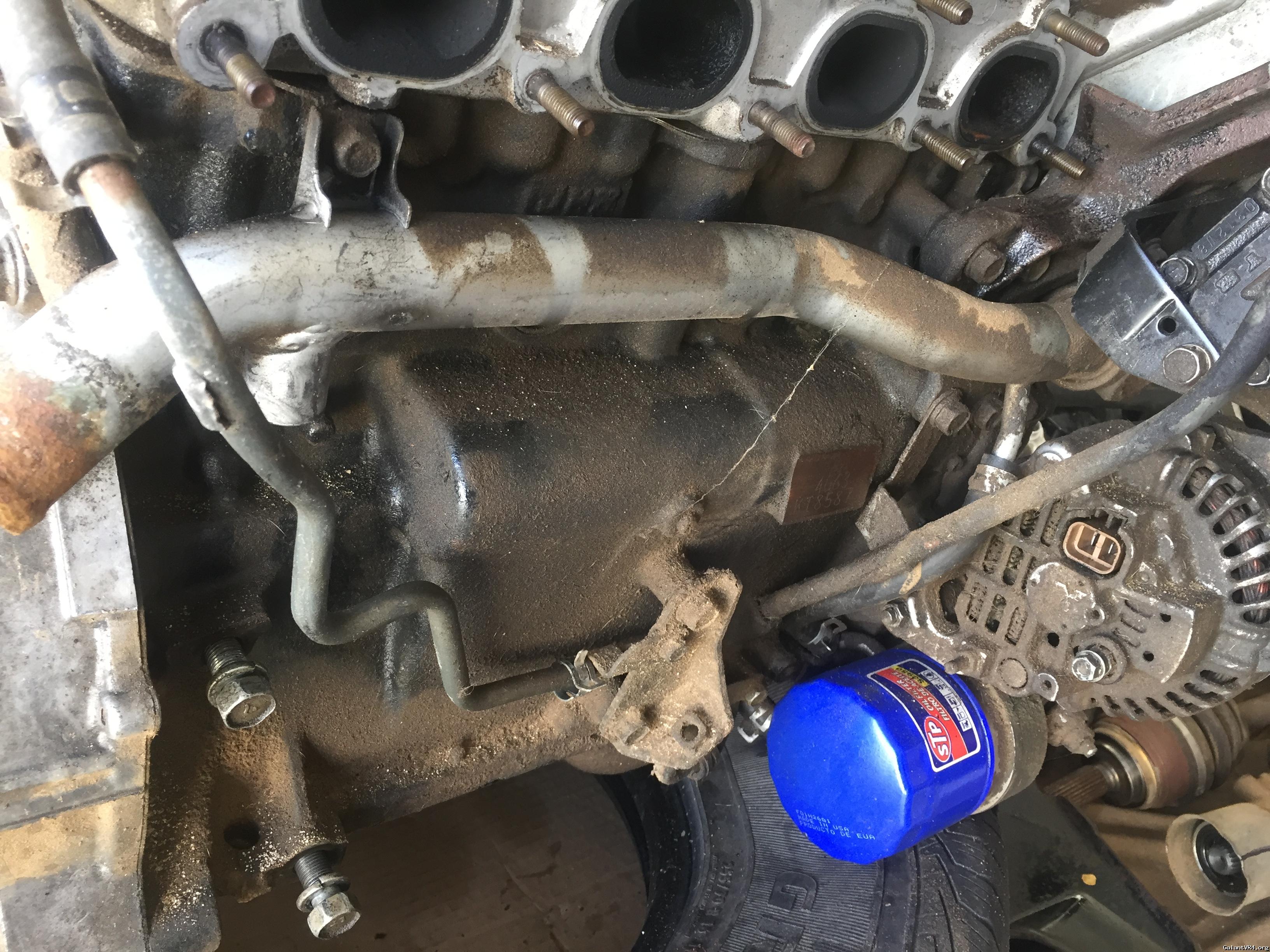

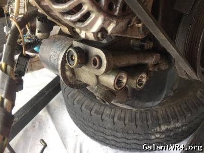

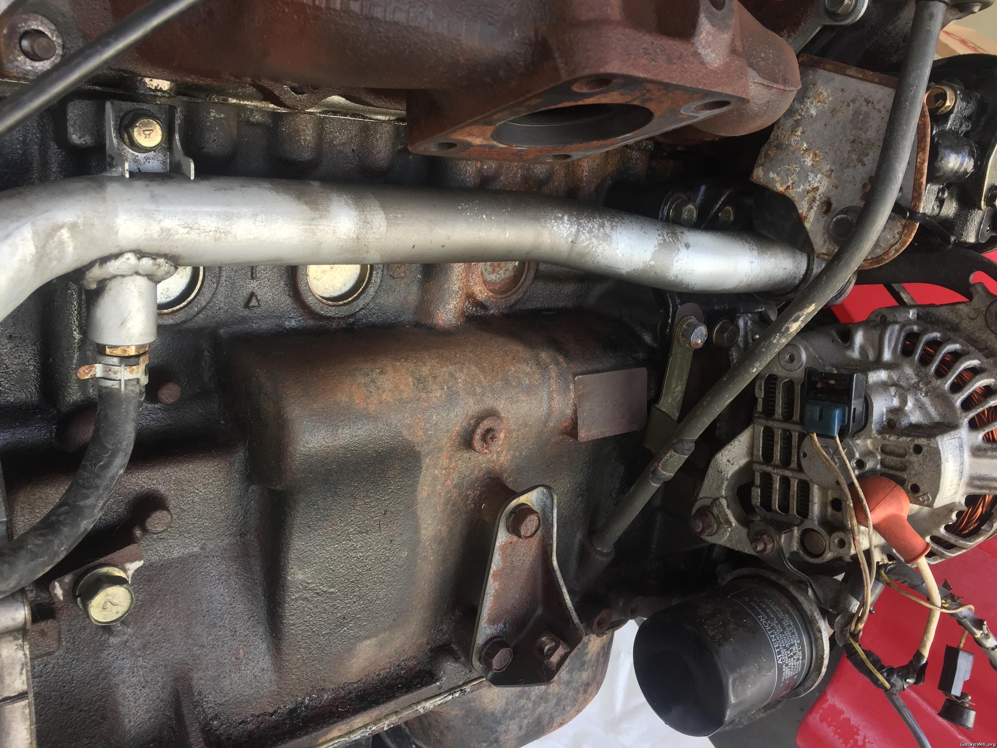

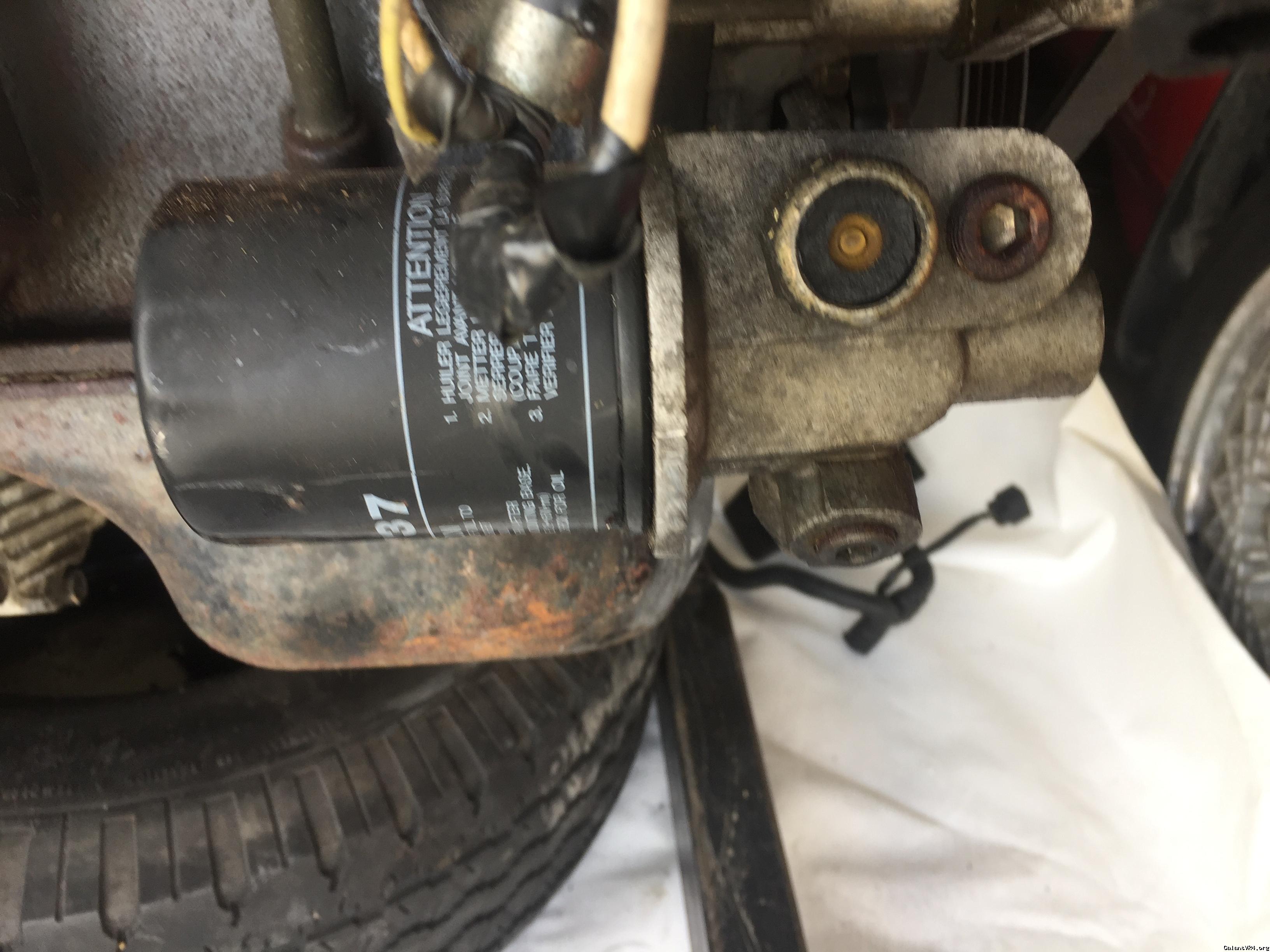

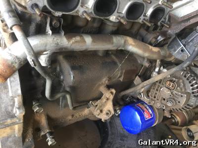

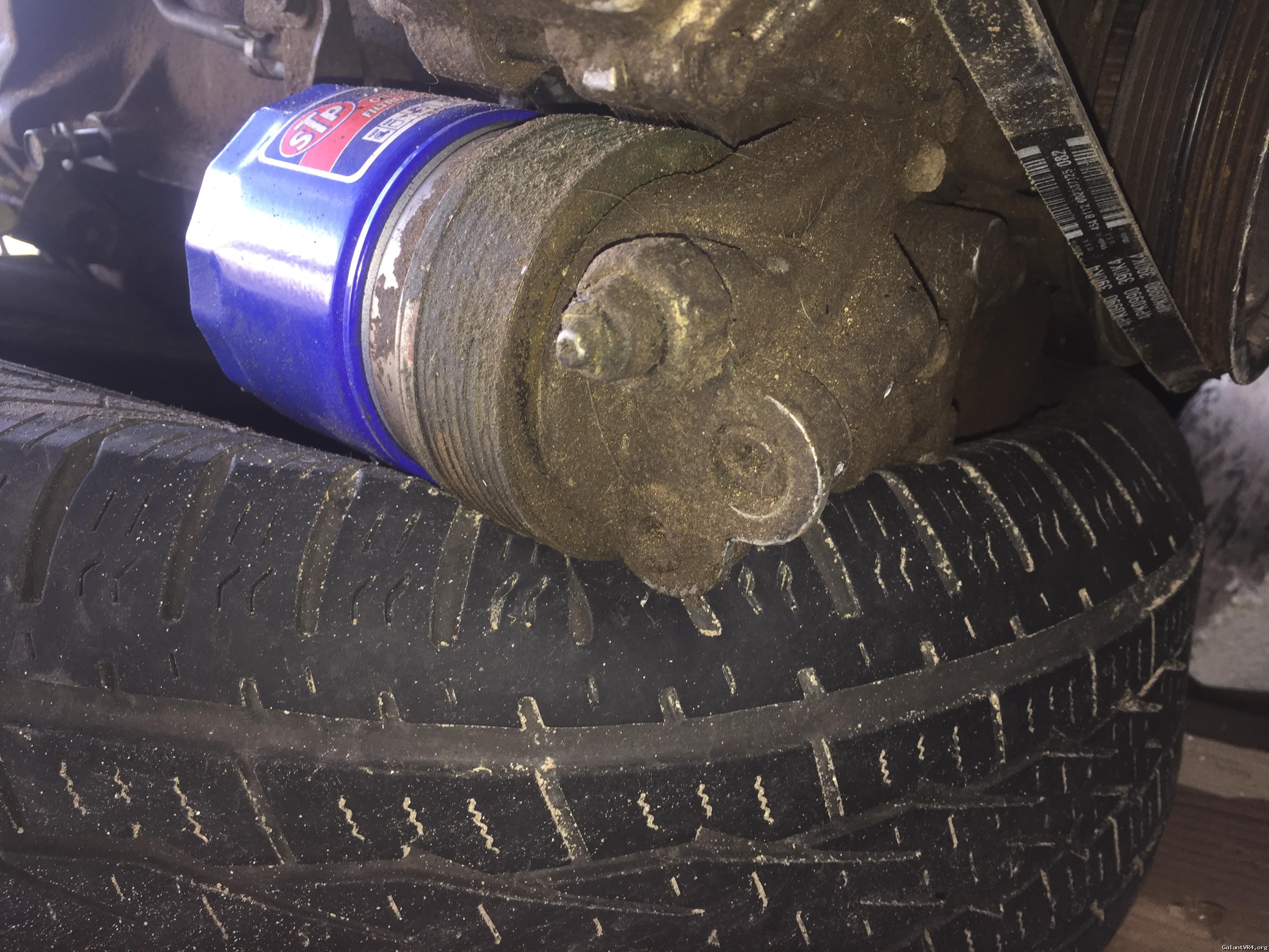

Hey everyone, so I'm putting in a new engine into my galant and it's a "cyclone". My old engine took a crap. I'm seeing a difference in the oil filter housing. I notice that the housing on the cyclone does not have what I think is a water line? Am I able to swap that out with my Housing from my other engine ? Why are they different ? Here are some pics . The black filter is the cyclone motor and the blue filter is the usdsm 6bolt I guess you wana call it lol

The oil filter housing on the cyclone engine is designed for an external oil cooler. That's what those two large threaded holes are for, oil out and return. Your engine uses a water cooler for the oil. If your cyclone engine is a 6 bolt, you should be able to take your water cooled oil filter housing off and bolt it on to the cyclone engine.
10,992
Many of us put the external oil cooler housing on as an upgrade. A bit more work than the water cooled version.

Thanks for the help guys. I started swapping out the parts. Anything else I should look out for on this engine? FYI the engine was included with ECU, complete harness/outer fuse box .. I'm assuming that I'm good to swap out my old harness and ecu correct? I saw on a past thread that there's something I may need to change with the abs? And also I will not be able to use dsmlink ? Is that true?

the water housing is garbage, you're better off putting together an air/oil cooler with the "90-style" housing.

I see, I already started converting over the water oil housing. Hopefully it will hold up. I'll look into after market units if needed.

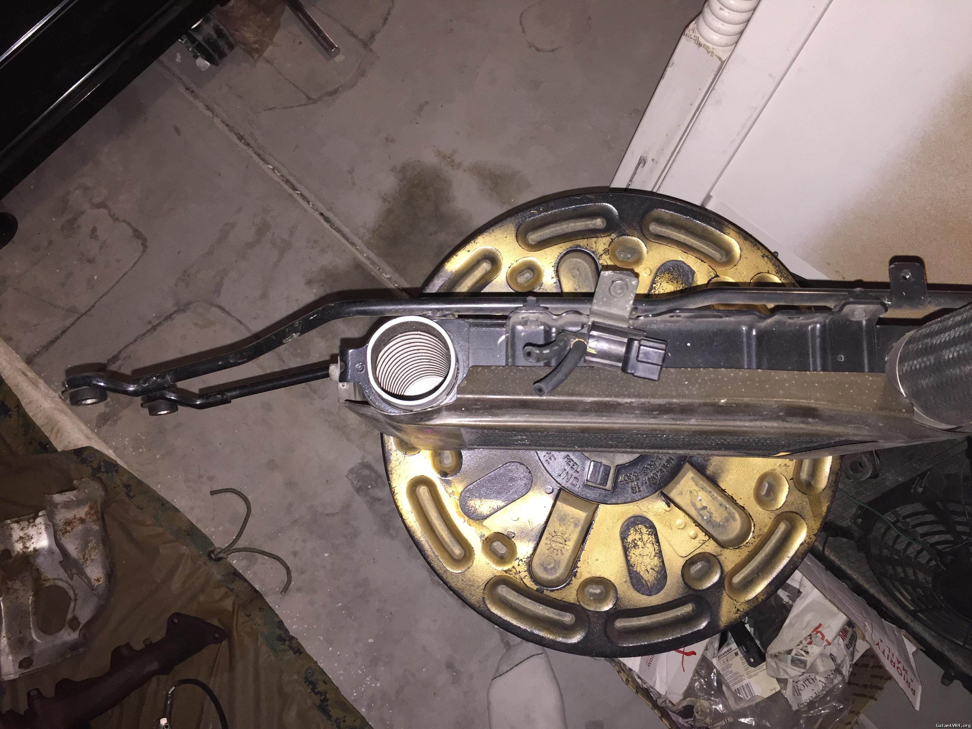

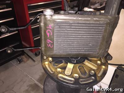

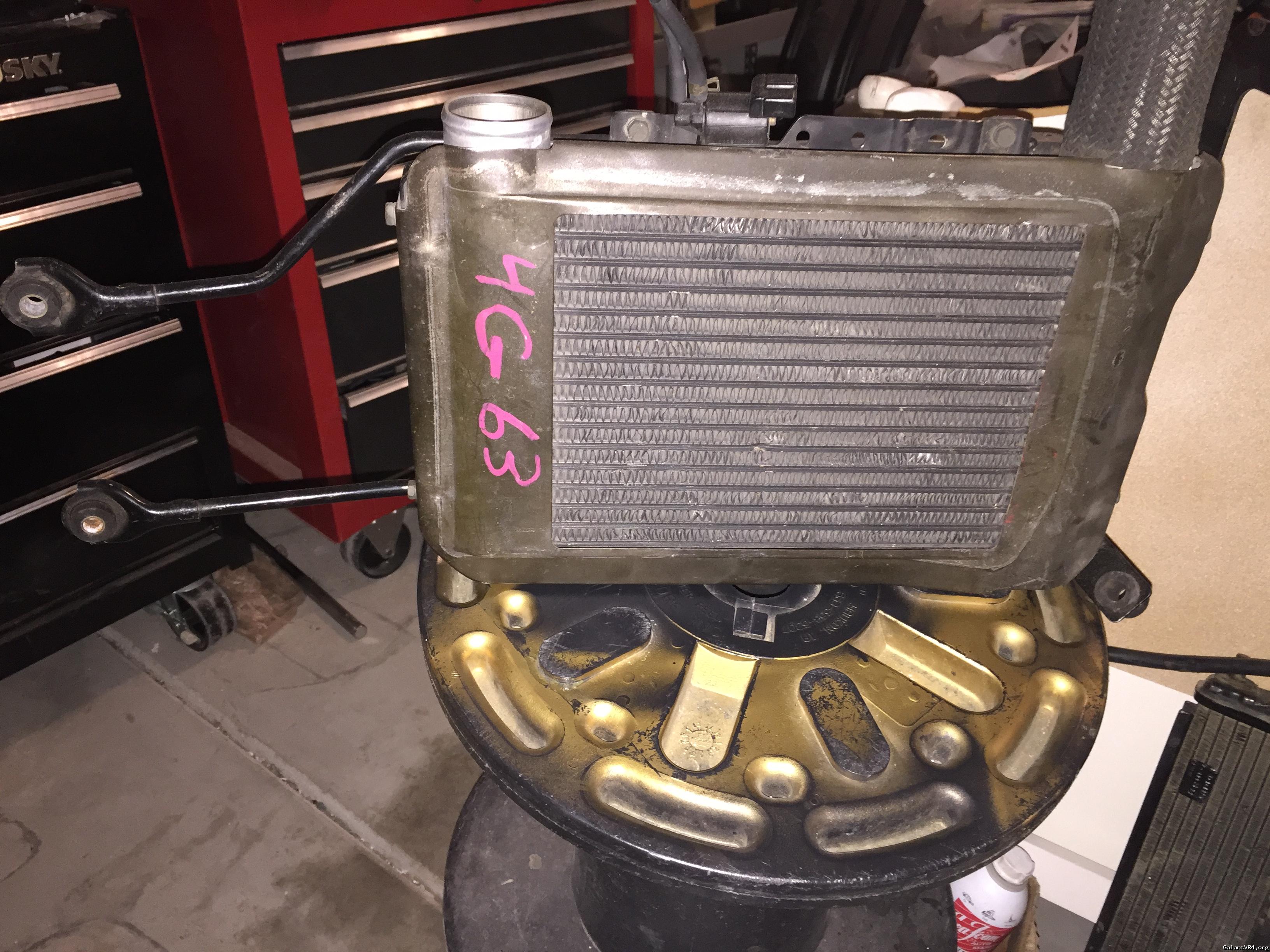

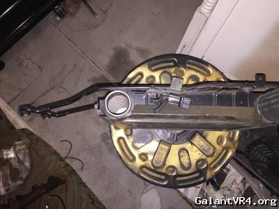

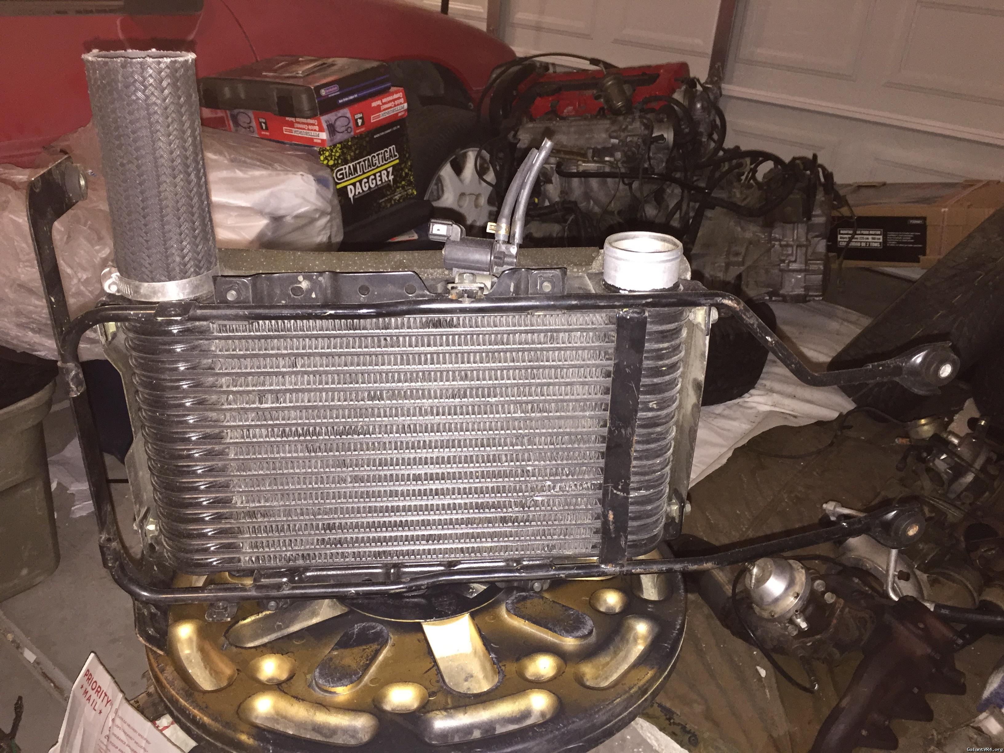

Hey guys so I'm going with your advice, & sticking with external air oil cooler. I did more reading up and yep that's the way to go. So question, Do you know if this is from a galant or 3000GT I cannot find anything close to it online. Yes it does say 4g63 but but I can't find anything to compare to be sure. I'd like to use it if possible. If not I'll go with the STM kit, open for other suggestions also.
Thanks
10,992
Agreed, I could have been clearer. Those are likely p/s cooler lines (which are still essentially an oil cooler).

It's a top mount intercooler from a jdm RVR. There are 4 mounting points and the gasket around the core is for an air tight hood seal
