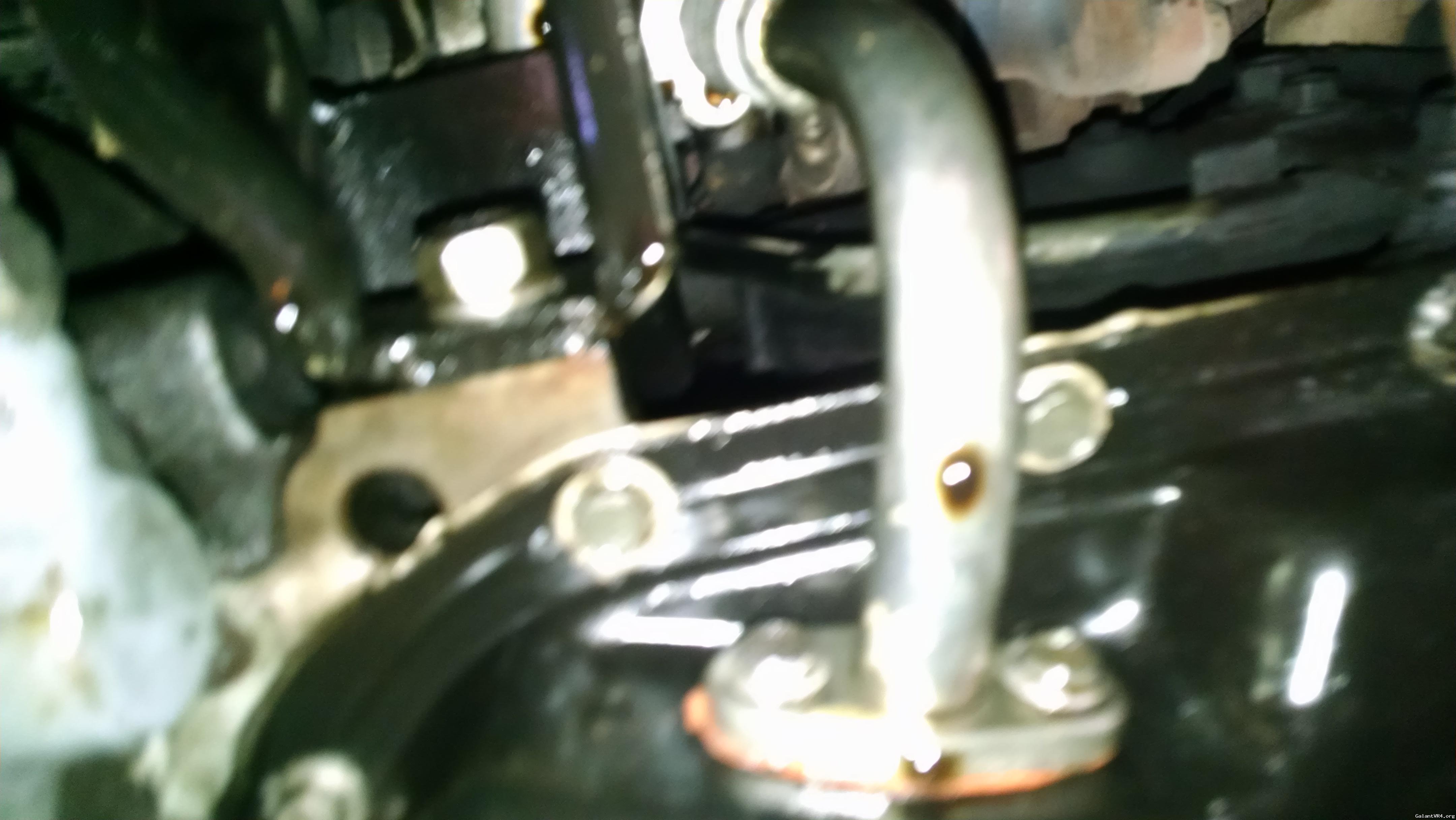

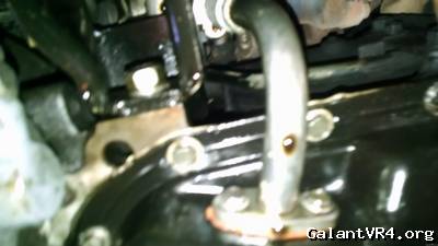

Hey check your drain line from the turbo. I too had no visible oil on the ground and it was not wet under engine except where photo shows.
That was the problem with my car and after a faulty turbo drain gasket repair by FTW, it leaked out within 25 miles and spun a bearing and B16G turbo.
OOOOps 10k worth of damage on a 50K no oil consuming engine.
If it is that gasket it will be no oil in a block of driving and you will lose engine and turbo as I did.
