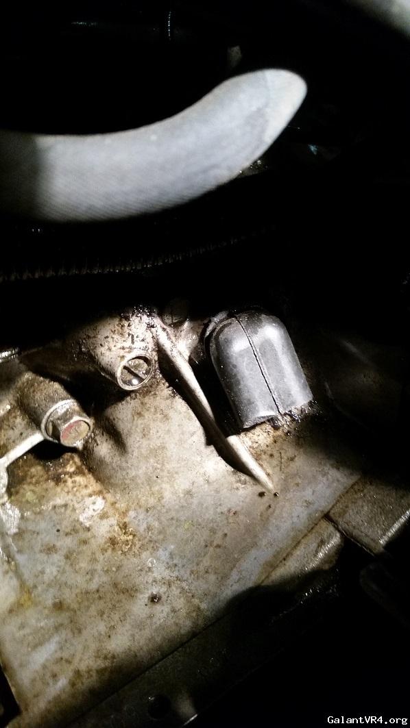

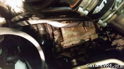

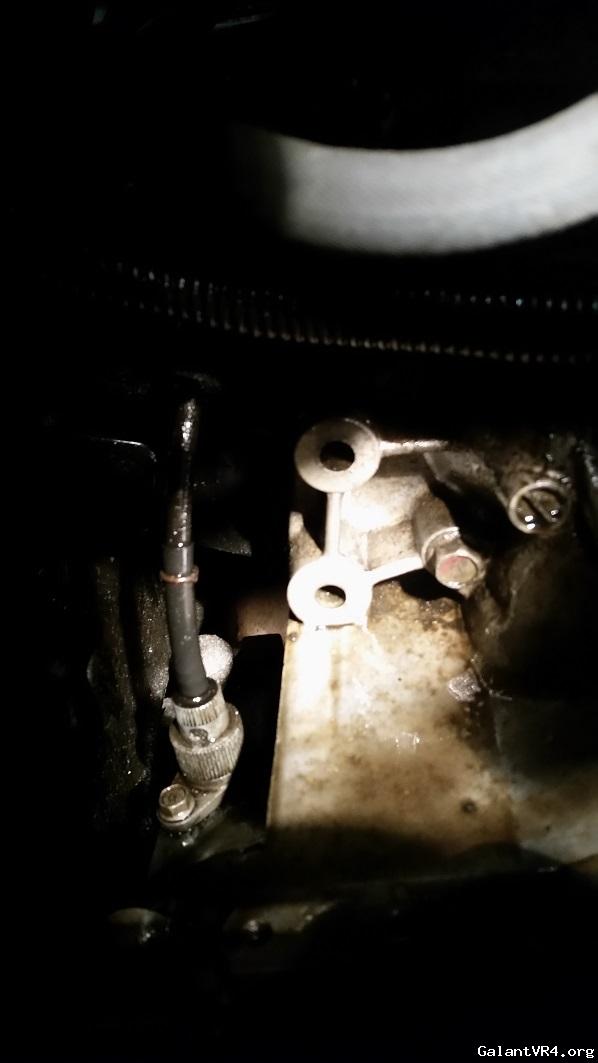

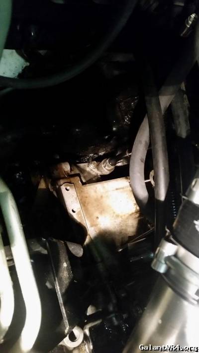

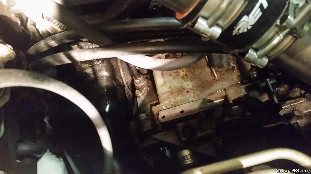

ok ill let the pictures do most of the explaining but basically the back of the trans under the throttle body has a good amount of oil on it after i drive it. I cant for the life of me figure out where its coming from. I even made a make shift catch can off the valve cover bc i thought thats where most of the oil was coming from. Any input would be greatly apprecaited!!

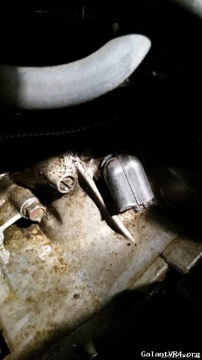

so i did just find that this plug is missing! Anyone know where i can get a new one? cant even find it in the manual. i sure do hope that its the main culprit.
its gear oil not engine oil

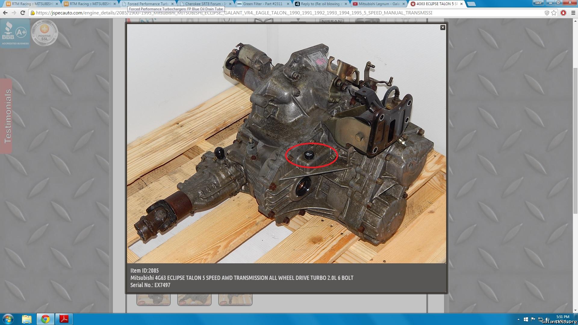

You will need that. It would be a vent for the transaxle fluid.
Jacks transmission is a listed carrier for that part in the thread here:
DSM Tuners thread for missing transaxle vent
Get a new crush washer to replace the one on the end of the 17mm head bolt that is in place for the trans fill hole on the front of the casing, radiator side.
Make sure you are topping up with a specific GL-4 fluid only, not GL-5 grade fluid.
If you don't know as to yet, what is in the sump of the trans, then buy 4 bottles of GL-4 grade fluid. Find a local Redline MT90 GL-4 and call it a day. Consult the manuals, it either takes just over two bottles or just over 3; meaning the possibility of a 4th.
If you are placing an order for parts from a vendor, they may know the capacity off hand.

thanks for the help! ill prob just order it from the dealer on local monday. i really do hope that this is where its all coming from. but i have a strange suspicion that there is something else leaking it out. I say this bc that breather was on there 20 miles ago.

i changed the fluid last night and went on one drive. the oil was burnt and smelled well like burnt gear oil. didnt seem to puke out as much fluid as it did before. only drove around the block
