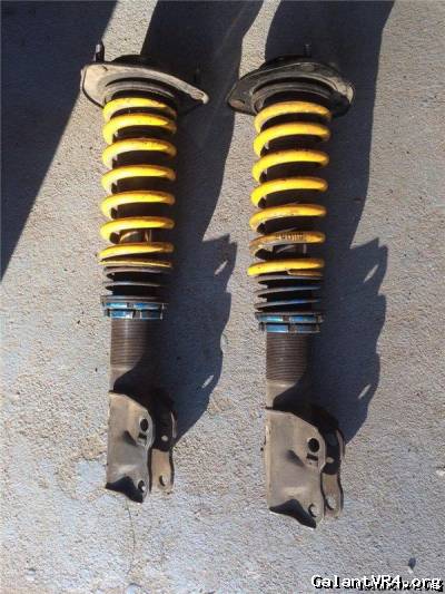

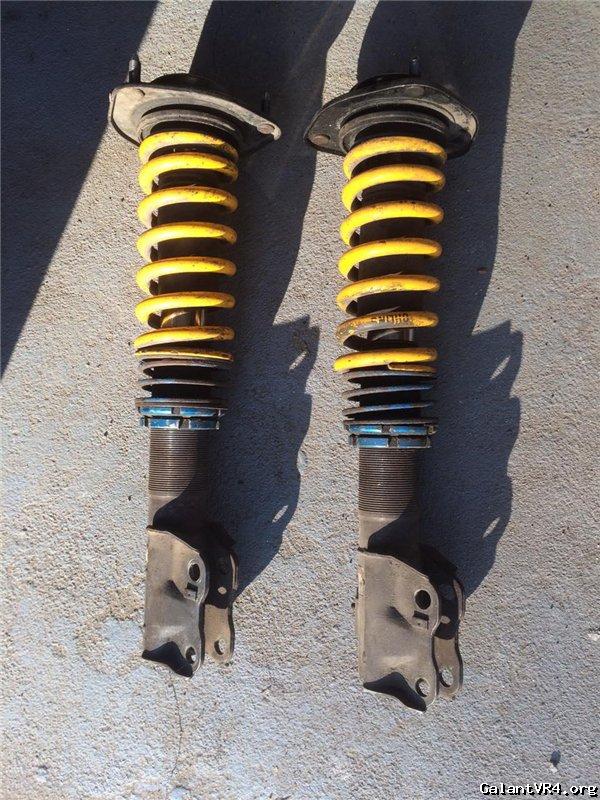

I found the front struts not expensive ohlins rt. Is it possible to install used Ohlins RT struts from Evo 7-9 ct9a in to GVR4
Anybody has already done this set up?

Yes it is possible. You will just need spacers inbetween the knuckle and the Strut ears. I'm running Evo specific KW V3's on my GVR4.
