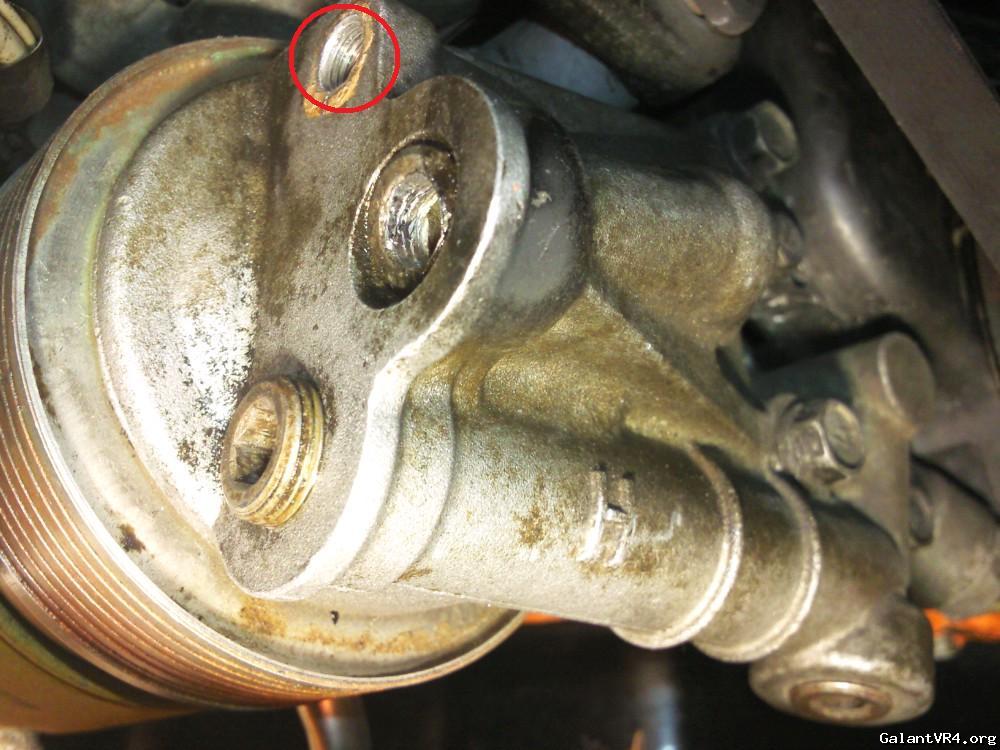

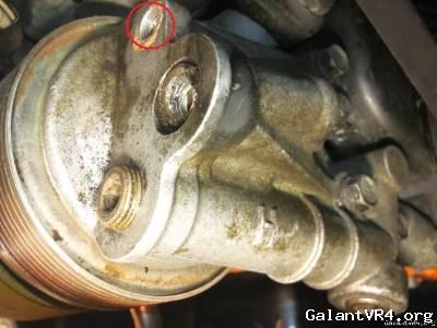

Is the port where the dummy light in the OFH filtered? The previous owner installed the oil feed line to the turbo from that port and I've been running it that way for 6k miles. Never had any problems,no shaft play(side/side or in/out) on the turbo wheel even after my rebuild. I was going to run it to the 3/8 filtered port, but after further inspection...it looked to be stripped. Maybe that was a reason why it wasn't installed there in the first place. Now, it looks like I might have to take it off and do some magic to get the plug out or buy a new housing. But if the 1/8 port is filtered, I might just re install it there.

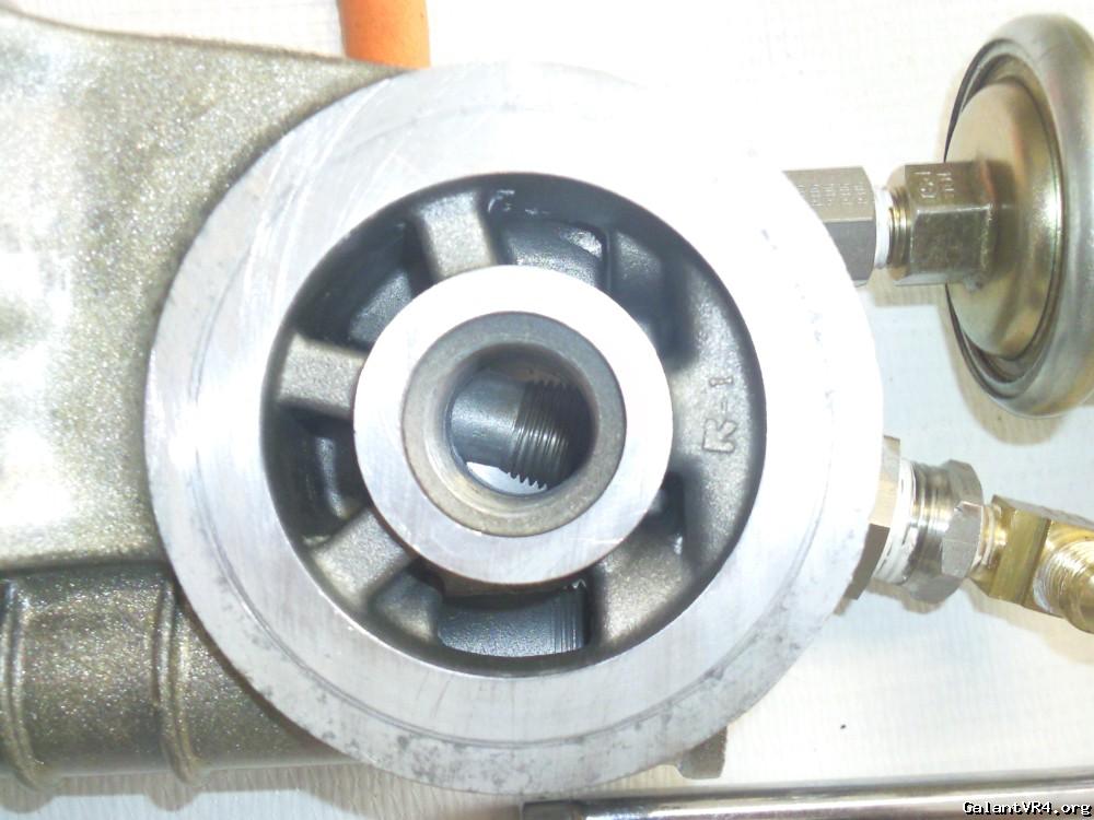

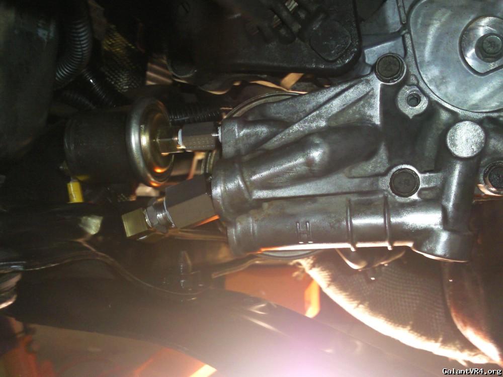

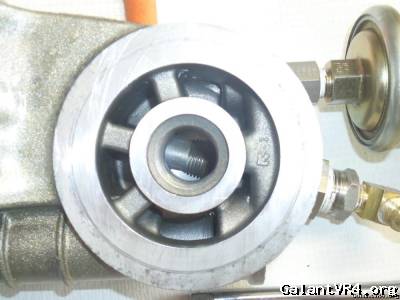

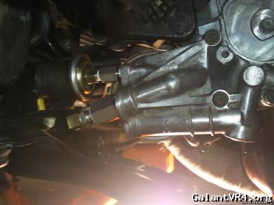

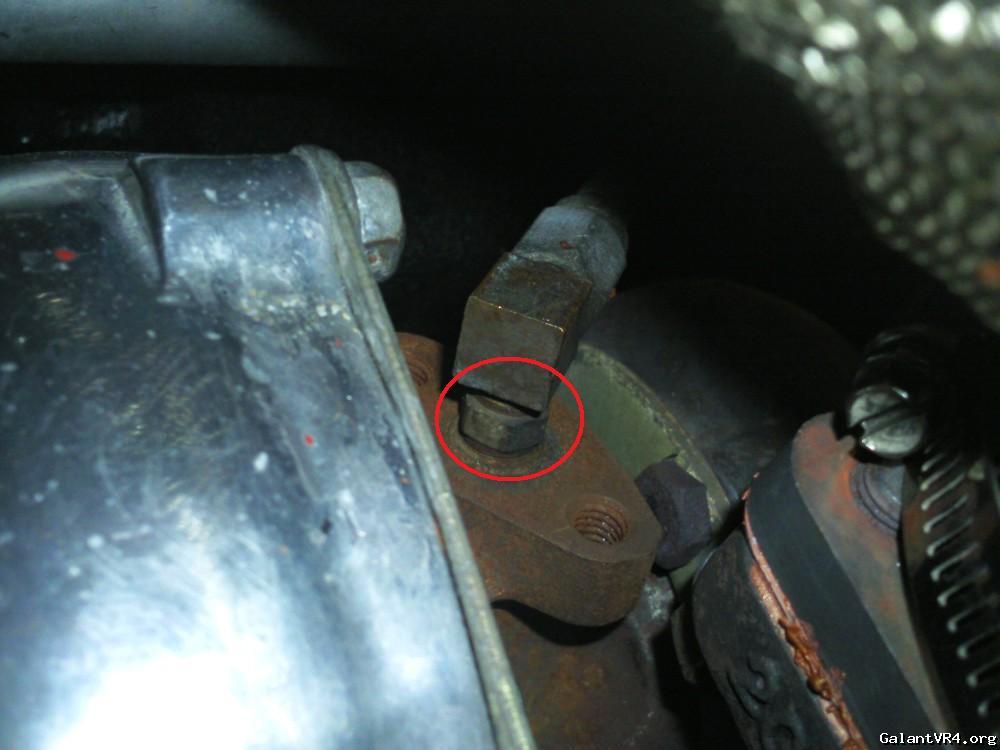

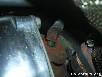

I finally got around to taking the OFH off. My dumbass decided to take the sandwhich adapter for the coolant off and realized afterwards that I didn't have to. Coolant decided to piss all over my arm while I was under the car and I had to call my wife to run and get me a milk jug so I can drain it. /ubbthreads/images/graemlins/banghead.gif
Anyways...I bought 3 stainless steel BSPT fittings from McMaster which was about $30 and a OFH gasket from Satan for another $8. Since the filtered bolt was stripped, I had a guy at work take it out for me. He was laughing at me since it took him only 2 minutes to get it out while I was going at it for almost an hr and I messed up one of my fingers. I`ll try and put everything back together tonight and take some pics...
vtecds1
Jan 16, 2004
1,706
Las Begas
First picture shows which one if filtered(just in case people never seen it). The second pic shows the finished product.
