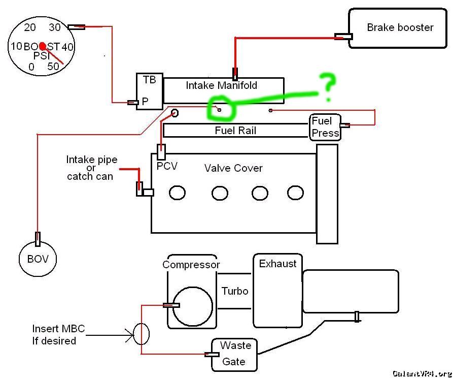

I have a stock (ECI MULTI) intake manifold that doesn't have the vacuum line circled in green.
I never noticed this on my other vr4s. What cars did my intake vs. the ones with that line come from? Does anyone in chicagoland have one with that line lying around by chance?
Barnes
Feb 9, 2003
6,249
Richland, WA
Is the boss there, but it isn't tapped? I'd guess it is from an N/A car. Also, you don't need that specific port for the BOV. You can tap off from the line that goes to the fuel pressure regulator, or the correct port on the throttle body (I don't remember which one). That would be a LOT easier than swapping manifolds.

I'm pretty iffy about tapping the BOV into FPR, or brake booster for that matter. Plus I'll need another line for MAP sensor soon, so sources are at a premium.
For how cheap the 1G IMs go for I'll likely scoop one up, easy enough to change. Plus then I can dress it up a little, shave the face maybe. What can I say, I'm vain /ubbthreads/images/graemlins/blush.gif

Picking up an IM this weekend with that line... thinking back, I don't think my bone-stock 1991 #39 had this line either, I never would have vented the PCV if it did.
Do you guys all have the vacuum line in question?
mikus
Jan 11, 2007
2,763
Aurora IL
anybody else? C'mon go take a peek, I swear this wasn't there on my first (for sure stock) vr4, prove me wrong.
It's the forward facing vacuum line above the PCV vertical line, below the right side of "ECI MULTI", left and parallel to the FPR line.
Take it from me who has many NT 4g63 cars.. its a NON turbo intake manifold.. i started shaving one the other day and realized it was NT and scraped it because of that missing vac port.
vtecds1
Jan 16, 2004
1,706
Las Begas
Sorry, I just got a chance to look this morning. I do have the port and have one right next to the brake booster.
mikus
Jan 11, 2007
2,763
Aurora IL
I'll be damned. Who puts a NT intake on a turbo.... Thanks for sorting me out
