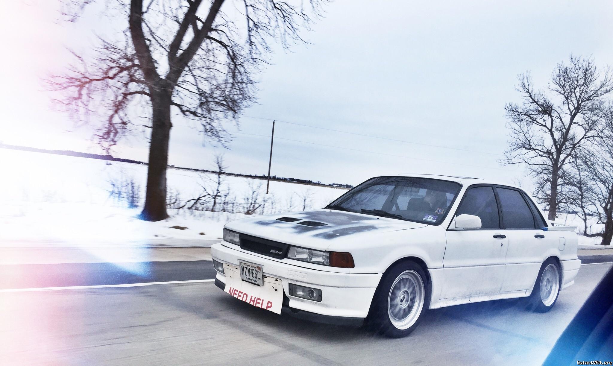

The 30 will work with -2.5 camber up front. You can see my pics. I have 17x8.5 wheels with 245/40/17 tires and are an effective offset of +37 after the small spacer and I run -2.2 camber.
