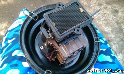

Hello,
I saw this at DSM in stage 0 mod
"Take the whole aircan out of the car, and remove the filter. On the intake side, you will see 2 honeycombs. Remove the lower one. Below it, you will see a large plastic screw set up into the bottom ofthe air canal. Back it out a bit. On the other side of the MAF, there is a star-shaped siliencer, remove it"
And, this at GVR4.org in Free Mod
1.1
Air Silencer
free
Located behind the Mass Air Flow sensor, there is a paper silencer.
This does help silence the sound of the BOV and turbo some but hurts power.
Take this out.
So, I decide to do that.
And.......
When I saw that, I don't know what to do next and put everything back to it's place. /ubbthreads/images/graemlins/grin.gif
Where is the paper silencer in these post mention? /ubbthreads/images/graemlins/uhh.gif
Sorry for being too Noob. But, can someone help me please?

Flip the whole thing around and you'll see it. There's a metal cylinder with paper/cloth vanes folded into it guiding the air out of the MAF. It's been a while but I recall you need to remove the screws holding the MAF to the back of the air canister to get it out.

WTF, guys. Ethan is a newbie from the far side of the planet. Is it that hard to answer his questions? The answer to "How do I hook up a cable to tune?" is not "DSMlink." Just as the answer to "What do I remove to hack my aircan?" is not "GM MAFT." Even though the skills that lead newbies to our community would also help them find the answers they seek with our search utility, when it comes to people in foreign countries, you could at least put a little effort into helping them out. If that's too much to ask, don't even reply, okay? Let the grownups handle the international relations.
Ethan, I'm sorry for the lack of clear answers to your questions lately.
You can totally handle these mods. Pull that air can assembly again and give it another go. This link should help you out immensely. It covers the screw and lower honeycomb. As for the silencer, when you have the air can out of the car, flip it around and look into it from the piping side. If the silencer is still there, you'll see it. It's kind of shaped like a wagon wheel, only more star-shaped. Very similar to an air filter, it's made of a thick paper, with thin metal reinforcements. Check this picture out. (Note: The car pictured is not a Galant.)
Beyond that, if your local laws allow, and you don't mind irreversibly changing part of your car, you can further hack the air can by using a tool (we tend to use a Dremel, but you could use a drill and small hacksaw) to cut away material from the "can" part of the assembly (the part into which the filter and MAF are inserted). Here's an example to give you a better idea what I mean.

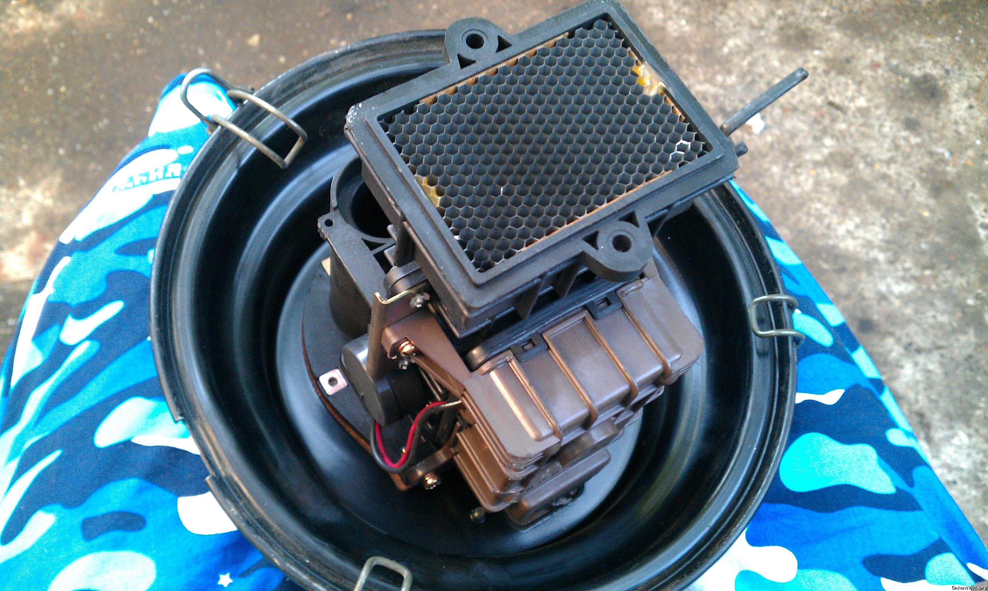

Is your car JDM? Because JDM models didn't come out with the paper silencer part. It's seems only the US models did.

Thz, Holeshotmoe. /ubbthreads/images/graemlins/smile.gif
According to this,
Yes, no silencer in my can. /ubbthreads/images/graemlins/grin.gif
