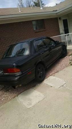

I am looking at a 92 VR-4 this weekend and have been looking for a long time.
What should I be looking for? what would be a "deal breaker" issue?
I'm looking at 448/1000.

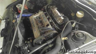

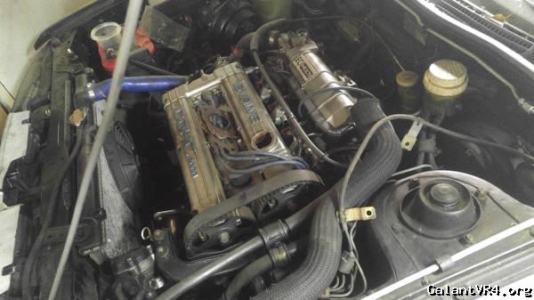

Current owner tells me the turbo is bad and the photo looks like the exhaust manifold(to inspect the turbo?) is not installed. I might have to walk away from this one.
I can replace all that but buying a non running car has always been problematic for me.
The int. looks to be in good shape. I am still on the fence about it.

What exactly did the owner say is wrong with the car? Engine? Turbo? Transmission? Suspension? Price?

I have been pulling massive overtime and haven't gotten to see the car yet. I will see it Saturday. I will post pics then. This is whats on the post.
