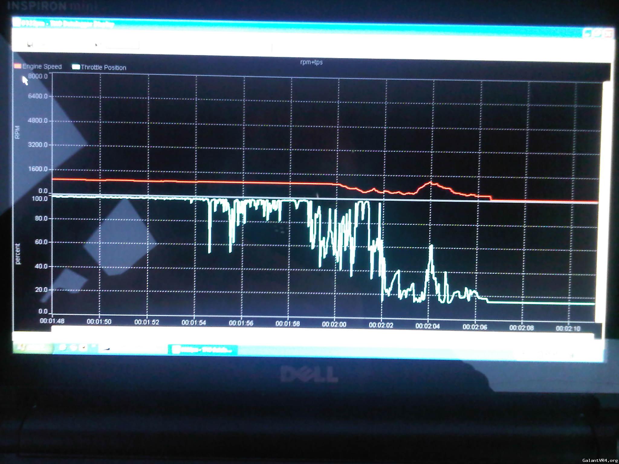

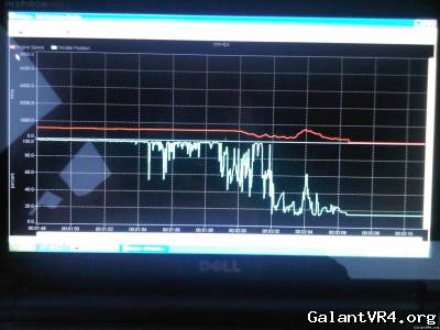

Definitely want to put a logger on that thing. I fought with TPS nonsense for months before I broke down and spent about $30 or so on the cabling to run MMCd or whatever on my netbook. Within a day, I saw this.
This was taken at idle after a drive home. Everything was well up to operating temps (ran fine when cold). What's the ECU supposed to do when MAF reports idle and TPS reports WOT?
You can see my TPS was reporting WOT at idle, changed its mind, the engine stumbled, and then died. I dealt with this every time I'd use the clutch during my 45 minute commute after work in the heat. Fuckery.
