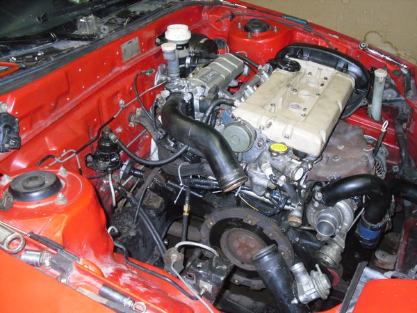

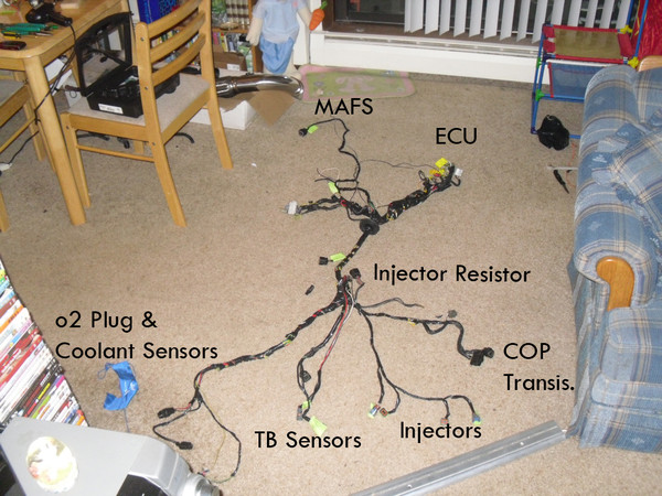

Dunno if this is helpful or not, but when I did the harness in my 1g DSM, this is all I needed for the motor:
Only thing not labeled is the starter wire harness which is the plug not labeled by the firewall plug. I ran my harness next to the shifter cables:

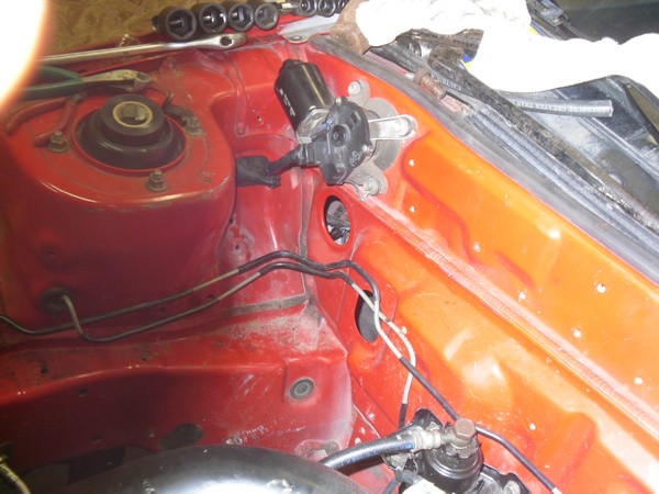

My maf sensor plug was ran inside because I run a translator, and for the wiper motor I ran it through the fender well on the pass. side:
Keep in mind, this is on a 1g dsm, no a/c, no emissions, no cruise, etc.

Excellent! I would love to do something like Strokin4dr (nohomo) did. That's excellent. Right now, I've got a couple spools of the cheap-o plastic wrap, but I think the braided might be better in the long run (without spending an arm and a leg to look cool with mil-spec like the Honda guys do).
And props to you, @abc123, for your supremely clever screen name and sharing a picture of the whole shebang out of the car. I haven't quite got that far yet. Toying with the idea of pulling it and working on it indoors, but also like being able to mock-route leads in the bay.

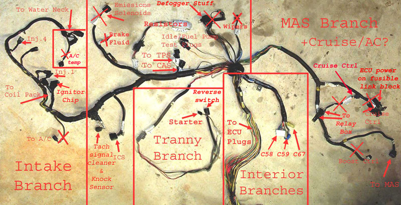

Here's all the wires I eliminated. Now since I'm not going to put the motor into a VR4 or DSM chassis, I eliminated everything non-essential to the running of the motor. You will probably want to keep some of the stuff I sh*t canned. Stuff like the wipers, brake fluid idiot light, etc. Here's the drawings showing what wires I eliminated as well, if that helps any.
I mostly used this diagram though to trace what to eliminate. It's painstaking out of the car so I'm sure it's a cluster in the car.

This a DSM harness, but should still be very useful for identification purposes.
Don't mind the Xs on things, that pertains to a engine swap into a different chassis where those aren't needed. /ubbthreads/images/graemlins/wink.gif
