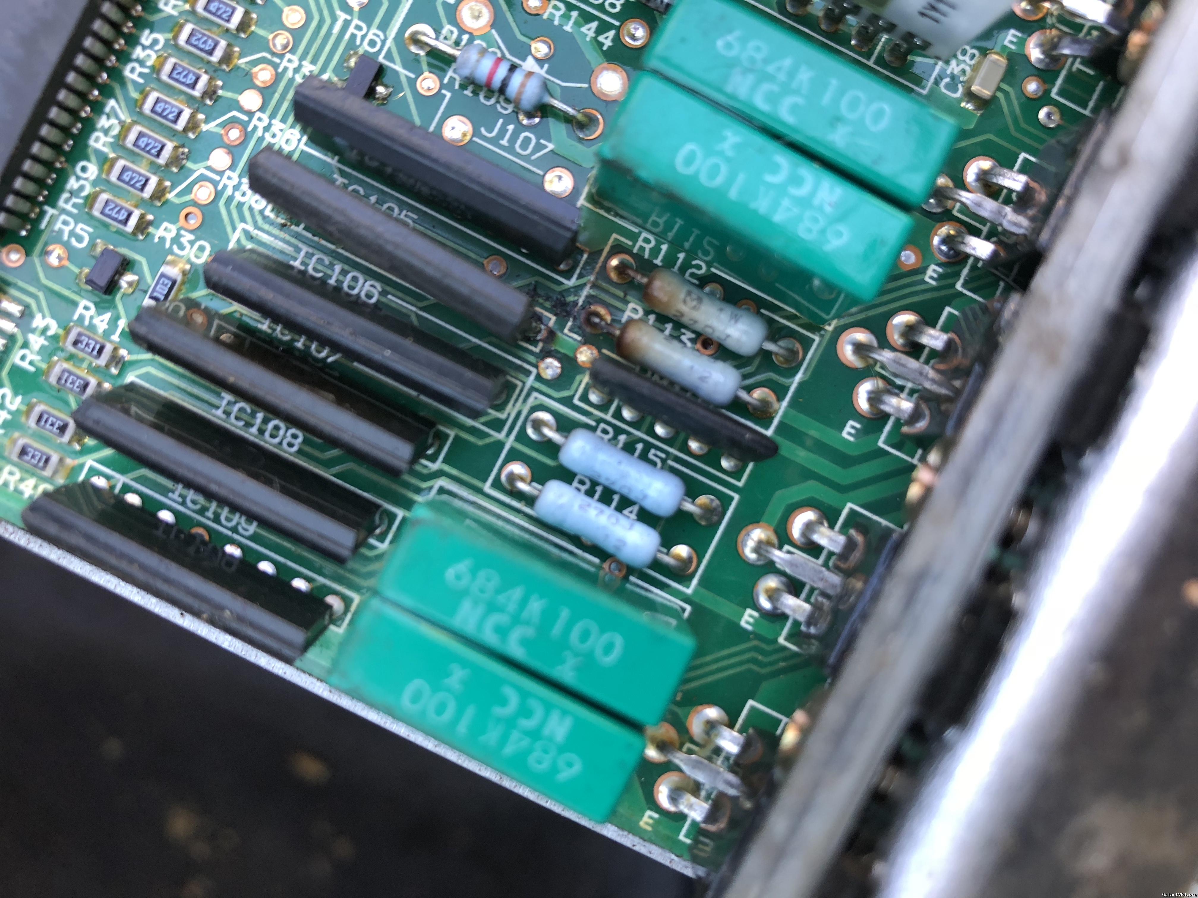

So I haven’t started her up in a year but I’m puttin her back on the road as my daily driver again because I need a new vice for all my time...
I hooked everything back up and tried to fire her up but only cranking away.

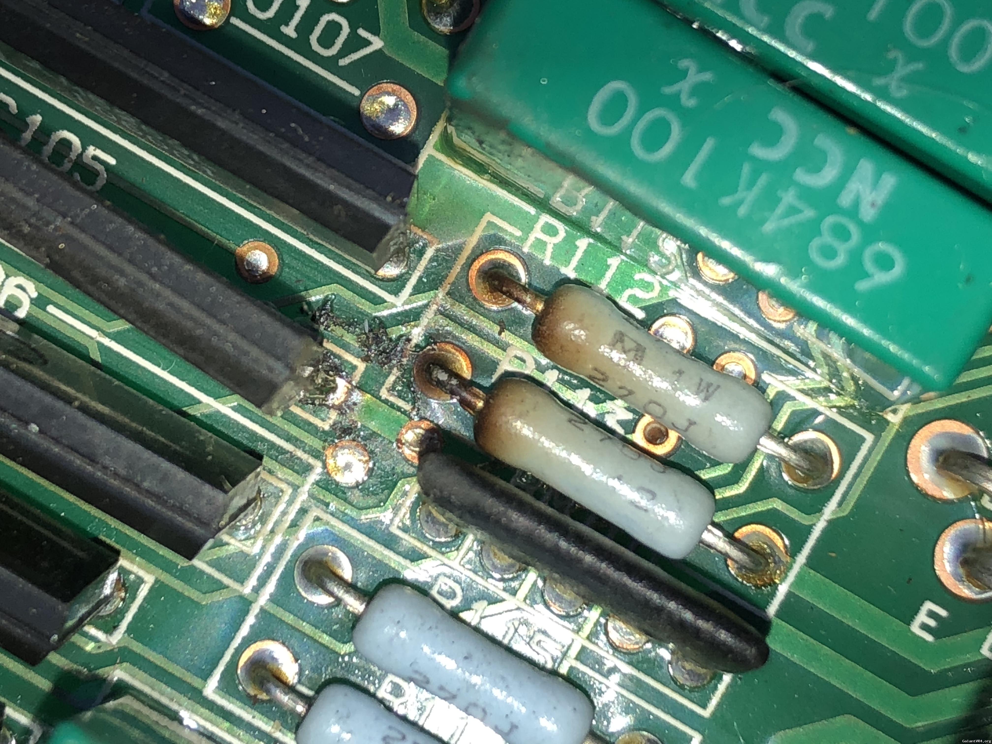

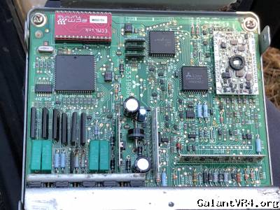

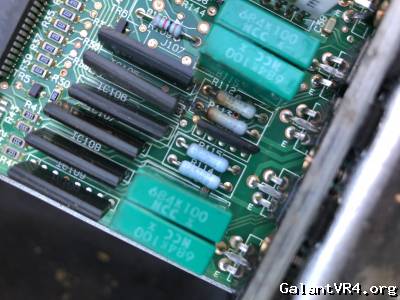

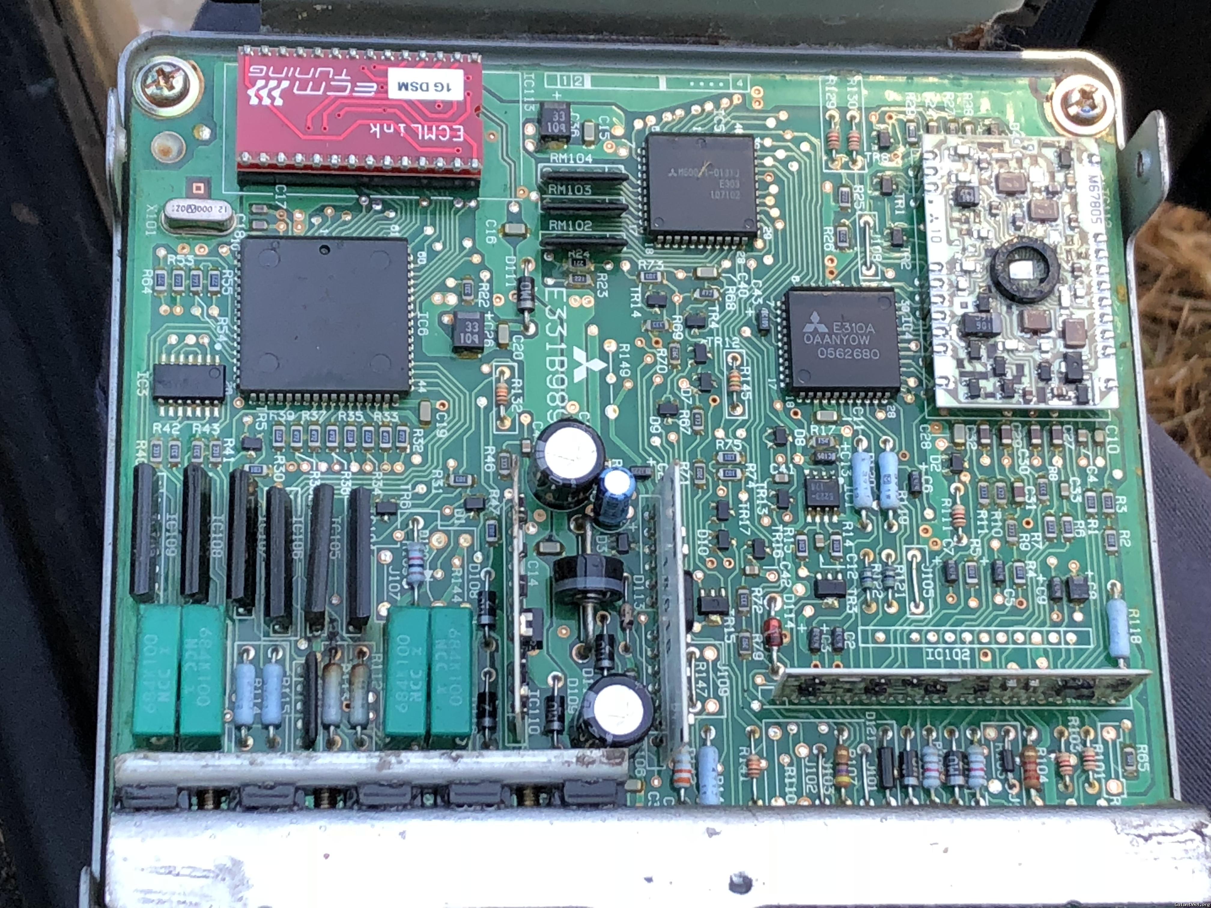

So My guess was that the 3 year old gas is probably bad, but before I drain the gas and replace it, Thought I’d check my ecu out and see how the driver/capacitors were sittin, can definitely see some fry marks but need a second opinion and a recommendation where to send my ecu if it is infact in bad shape.

Get it checked out by ECMTuning. They will go through it and tell you what is needed.

Thanks ya just sent them a mesage with pics to see if that is indeed the problem before I send it out.
Contacting a local buddy with a 1g ecu so I can try it out to make sure mine is bad first

Also so I got a spare ECU how do I make sure not to fry my buddy’s computer.
Should I remove the isc plug or do my drivers not look fried ?
Just wanna make sure not to hurt this computer
