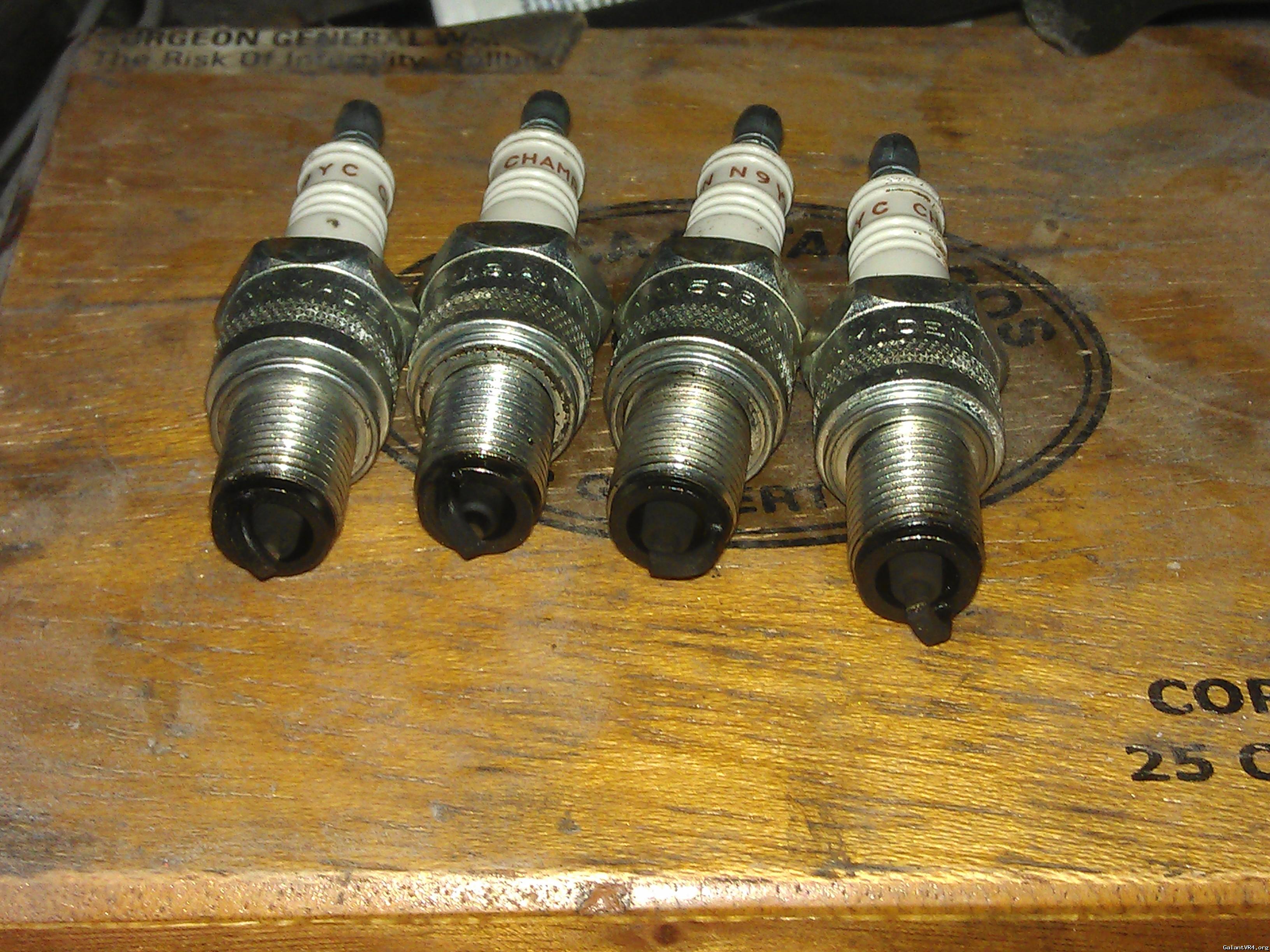

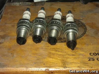

The engine turns over, but won't fire.
Ran previously with starter fluid. Has spark, ignition pulse, fuel, air. Just swapped the plugs. BR7ES.
Ran before on some substitute plugs, and those came out (were in the car for less than 1 running hour) looking like this.
Clearly the car is running rich, actually, not running at all, but I'm at a loss...
