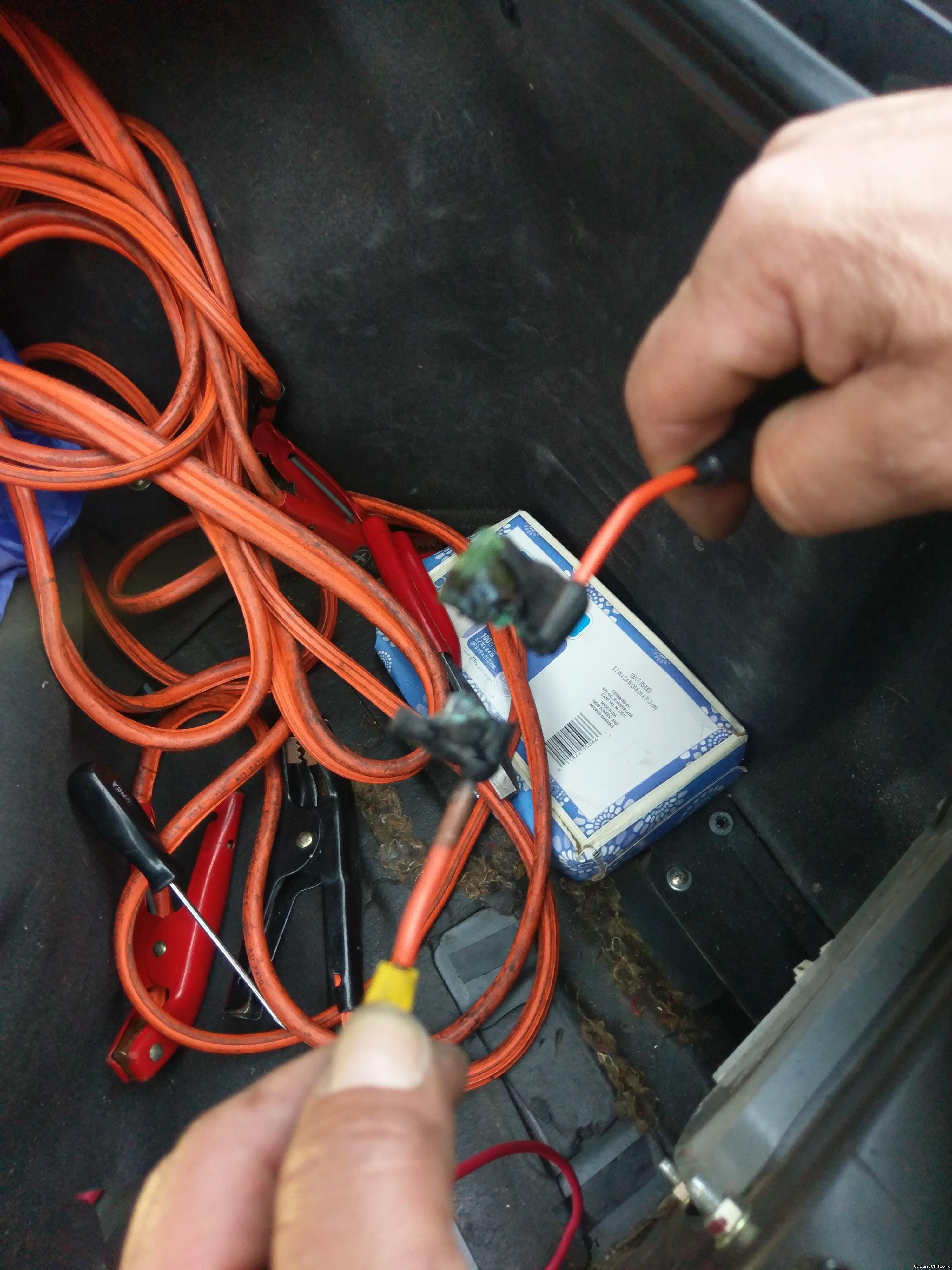

Looks like a blade fuse blown in half? Why is that in the trunk? Isn't even on the side of the fuel pump. All fuses should be as close to the battery as possible.
kdott96
Mar 2, 2016
72
Valley Stream, NY
Technically it was close to the battery (it was placed in the trunk), but when I got the car I moved it back to the front
