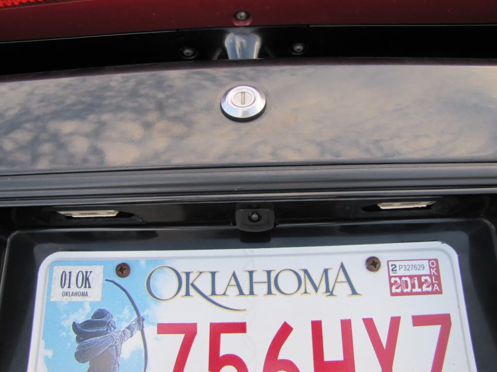

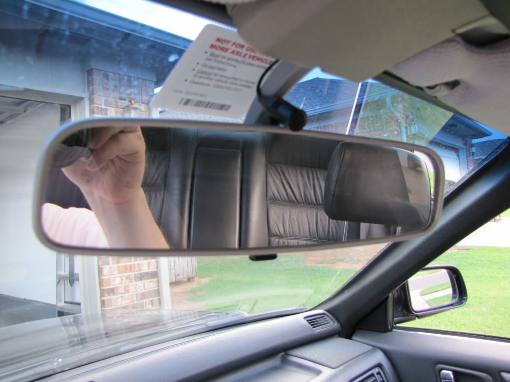

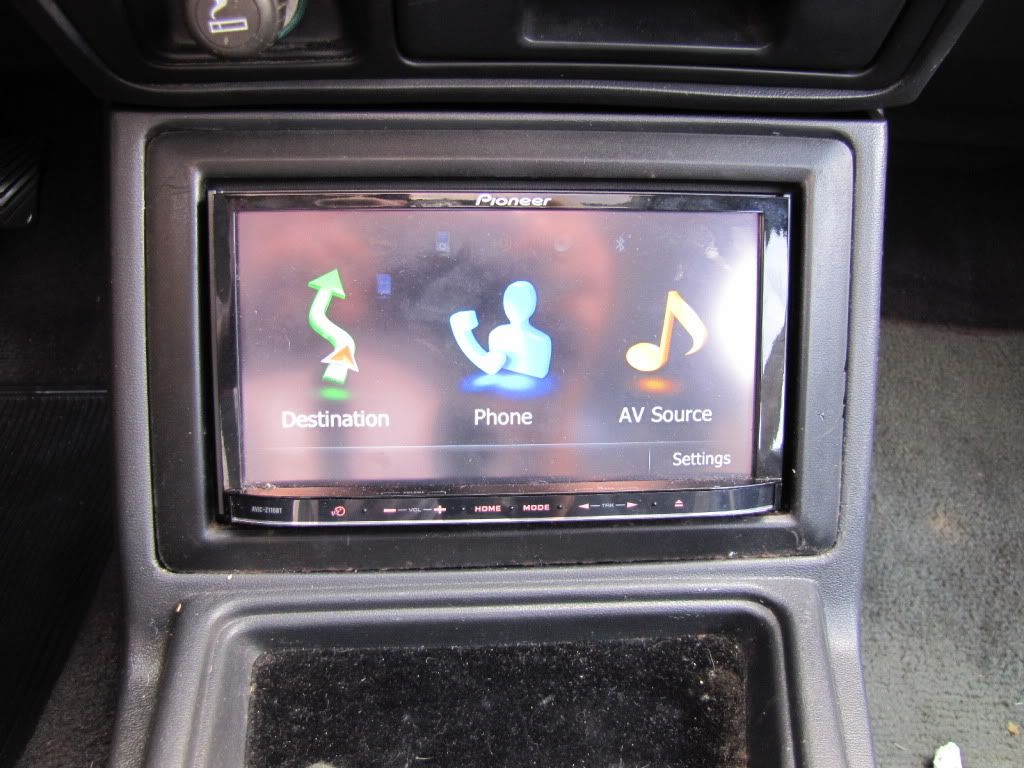

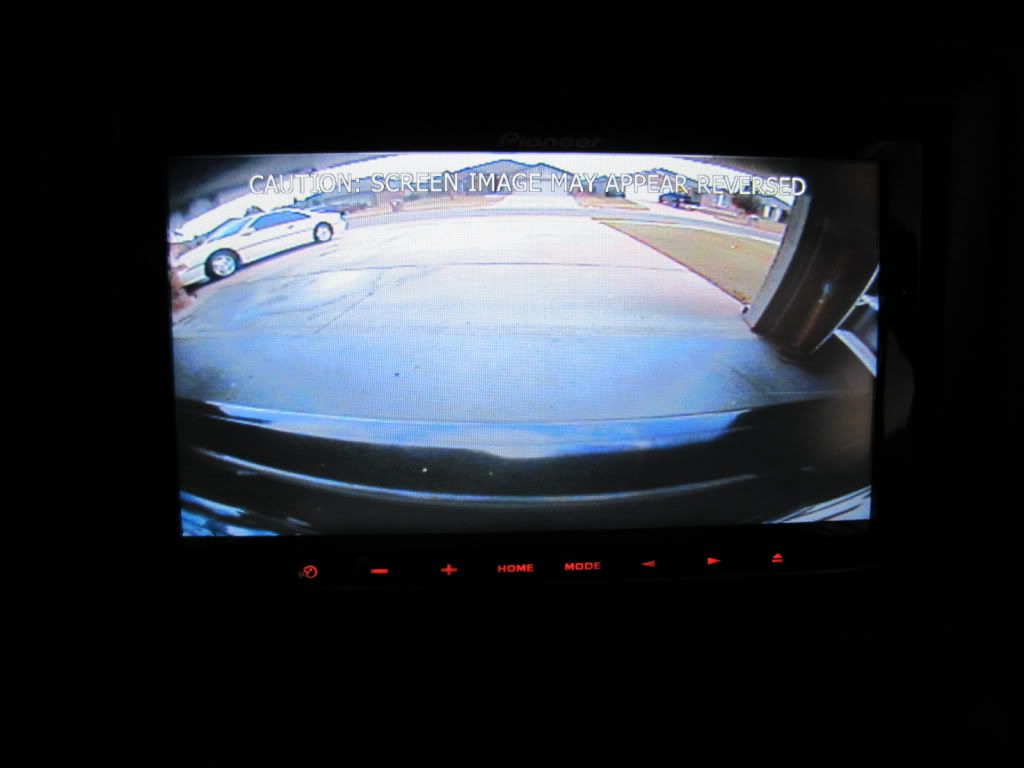

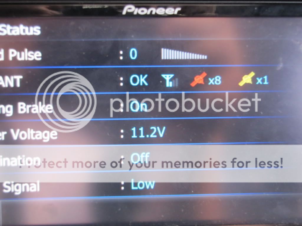

After driving the car with no radio since buying it several months ago, I finally got some tunes. I installed the old system out of my wife's old car. I installed a Pioneer AVIC Z110BT, Pioneer XM, Pioneer HD radio, and Pioneer back up camera. I am so happy to have tunes and blue tooth again. Can't count how many calls I have missed, leaving my phone on silent before now. I installed the camera above the license plate with a little trimming on the plastic. You see a little bit of the bumper, but I did not want the camera to draw any attention. The GPS and XM antenna are installed behind the speedo cluster on top of the metal plate, with no reception issues. I tapped the reverse wire off the red with blue stripe wire at the back of the car between the light and harness plug by the antenna. Now I also discovered, I need to replace some of the front speakers.
SHOWING GPS ANTENNA RECEPTION
REVERSE CAMERA
VIEW FROM REVERSE CAMERA
BLUE TOOTH MIC LOCATED ON TOP OF THE MIRROR
