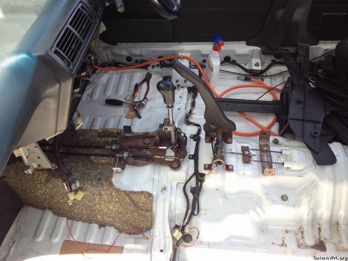

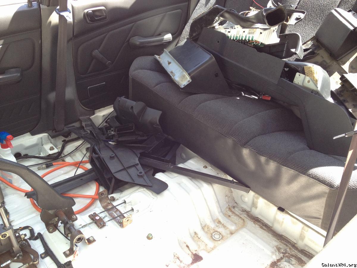

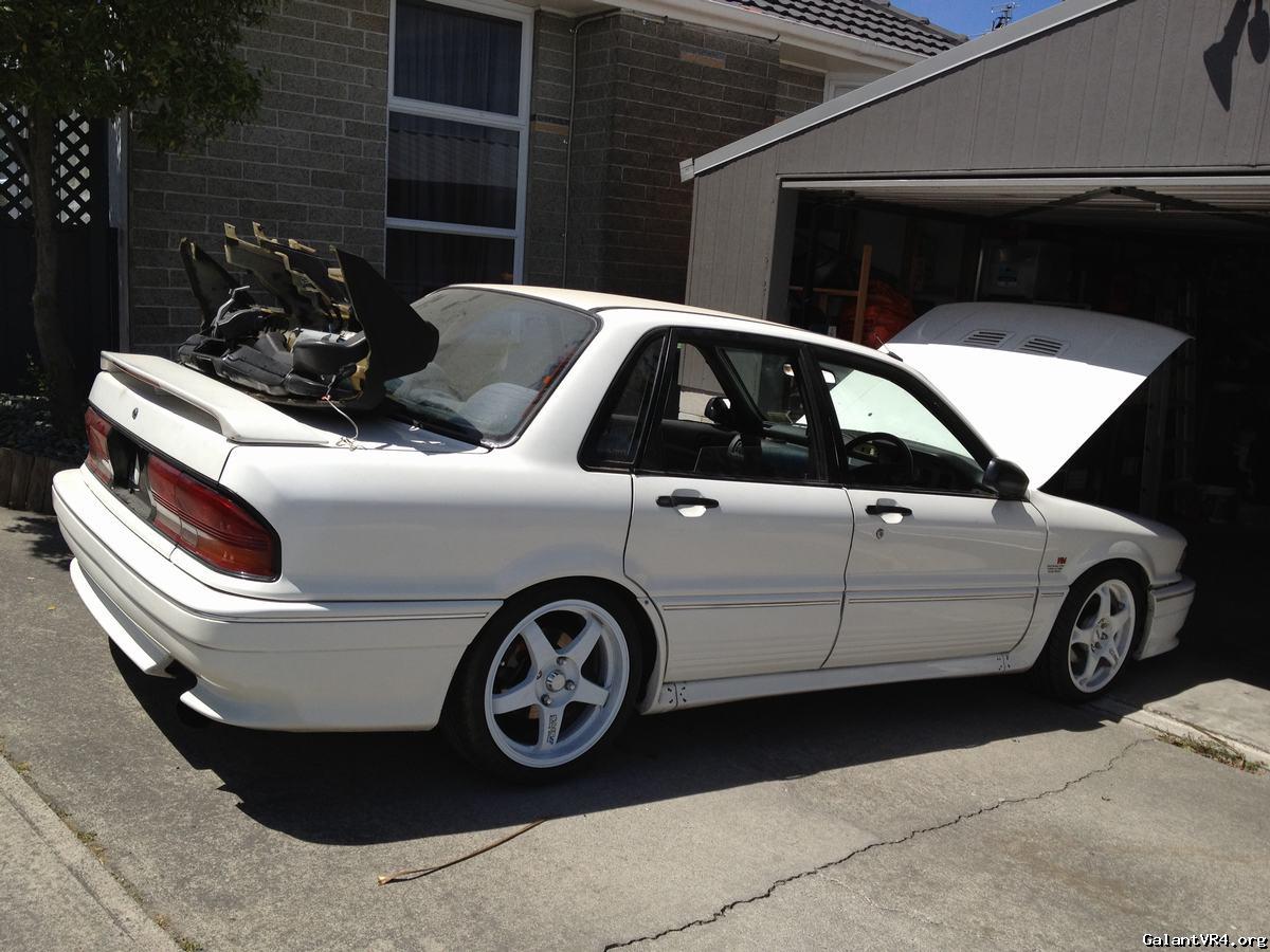

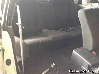

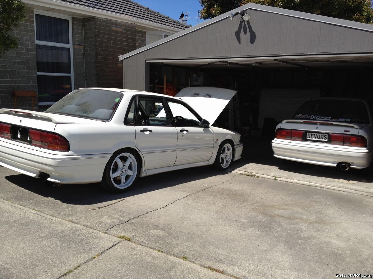

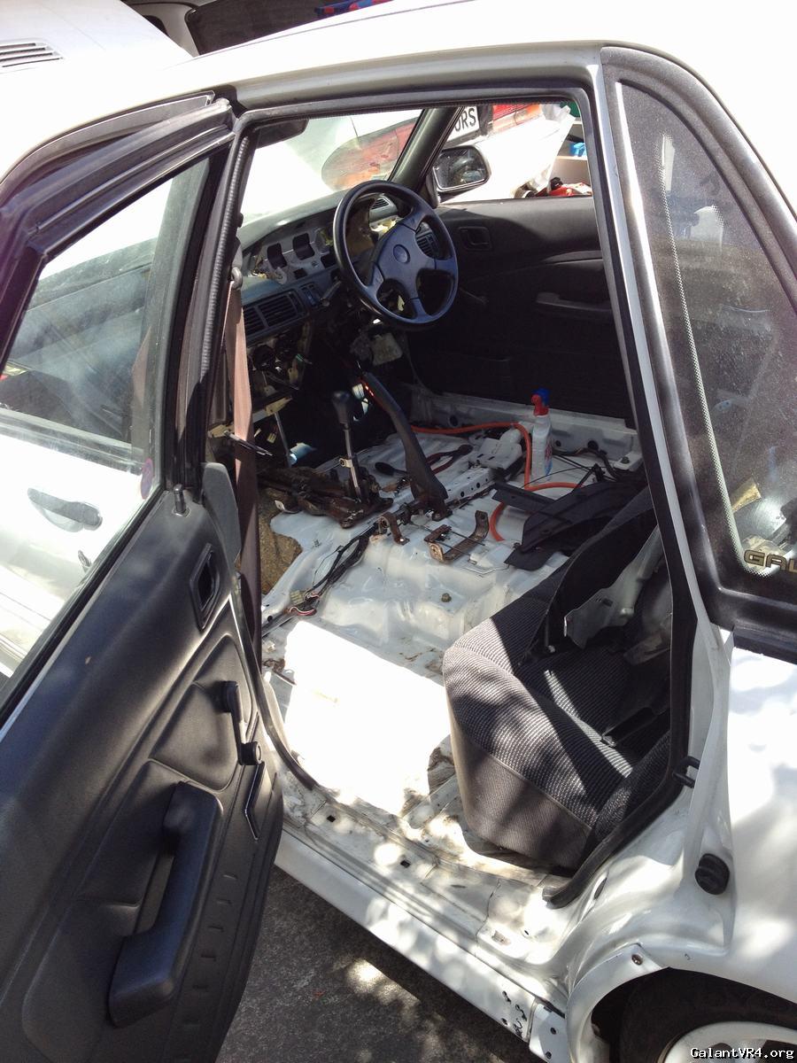

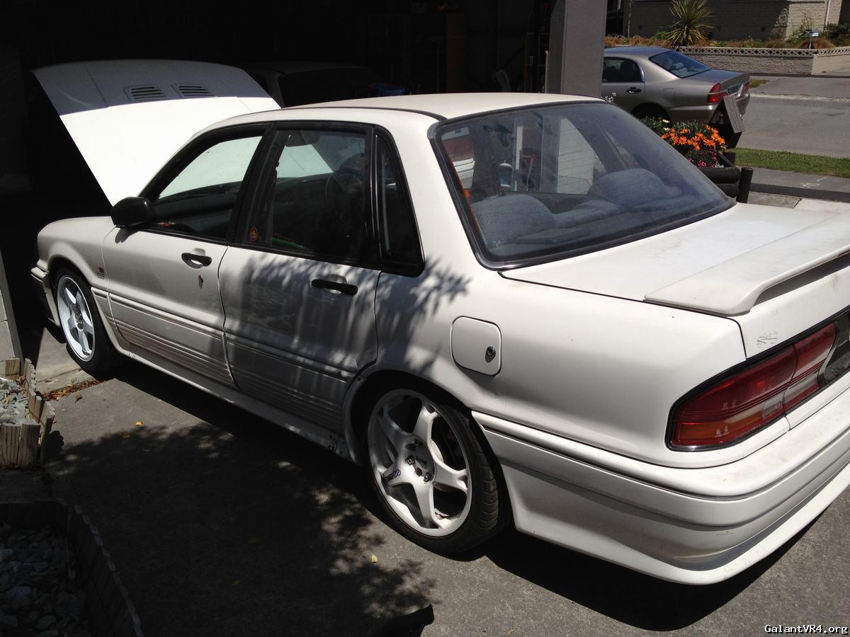

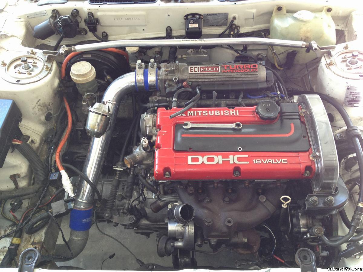

the old rs had been sitting round for a while so i decided to buy a rolling shell to use up some spare parts and bits that are being replaced on the original car. here are a few pics of it coming back togther after pulling it apart to remove a lot of bad mods done in the past.
mistaVR4
Dec 16, 2003
4,768
Boulder, CO
Looks great on the outside,I suppose the inside is nice as well but just needs a lot of work. You have a couple of nice VR4's there man! Keep updates coming with the new roller!
EDIT: I'm always confused, so, are you planing to get both of them back on the road?

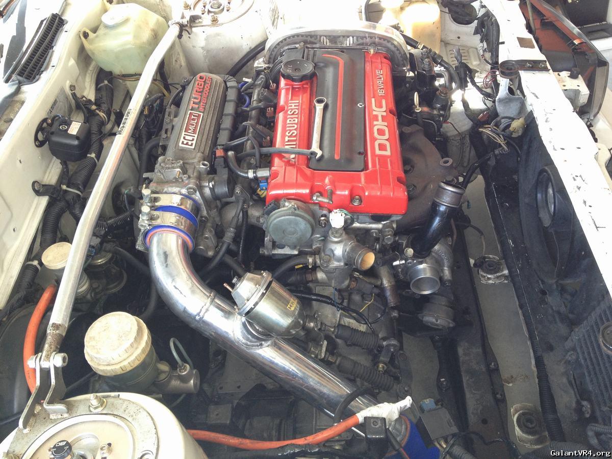

I like!!! Vr4 rs wind up windows and no sound deadening! Looks very nice! What strut brace is that?? I need something like that for the Amg. The Whiteline and ultra racing one doesnt clear the Amg intake manifold.

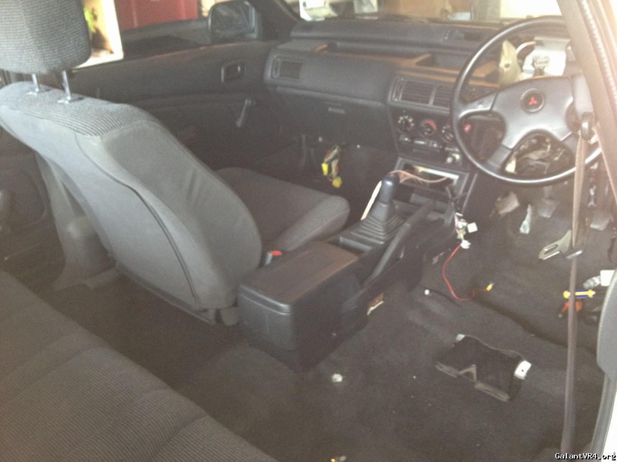

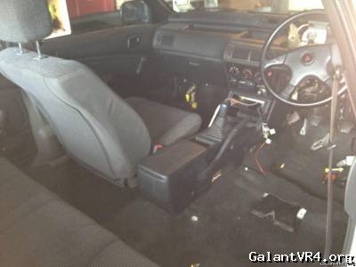

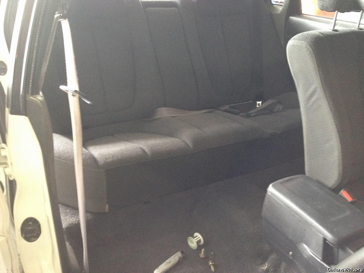

put the new dash in and have cleaned up and refitted most of the interior.
keeping it pretty std in the motor driveline area
motor has
.5mm evo 8 pistons
arp headstuds
steel gasket
looks like std cams
balance shafts removed.
it has the 4 bolt 3.909 diff with lsd std aand i have built up a box with steel forks and rs ratios to suit.
sticking with an evo 3 manifold and turbo
std comp and some 1000cc rc inj
walbro and some 2.5 inch i/c piping and larger cooler should make it a nice daily driver.

Bazeng the strut brace is a Ms one from japan , not sure if you can still get them.
the car also has some BC gold coilovers and goodridge braided brake line
