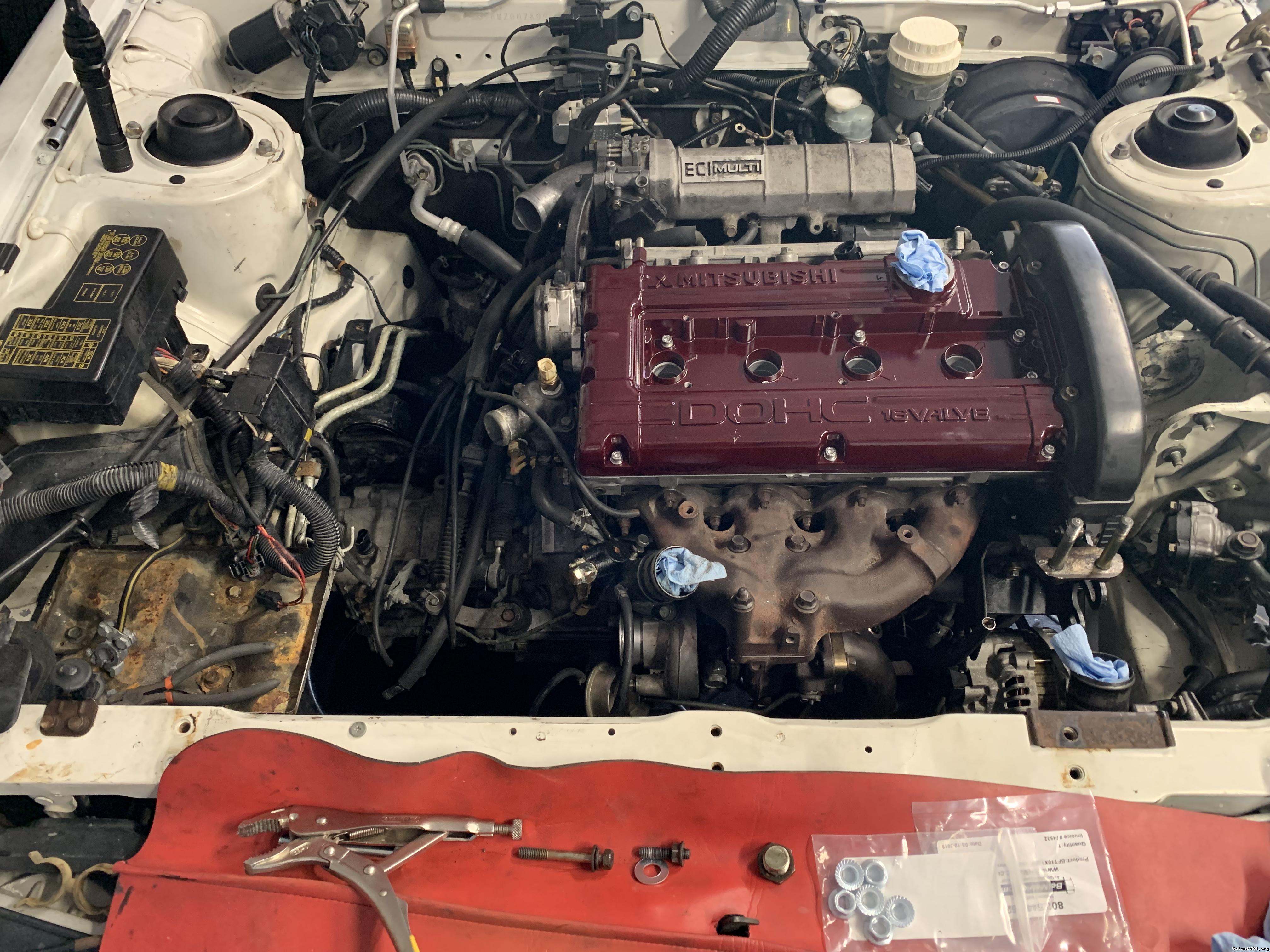

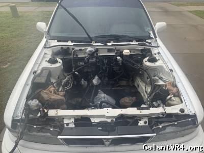

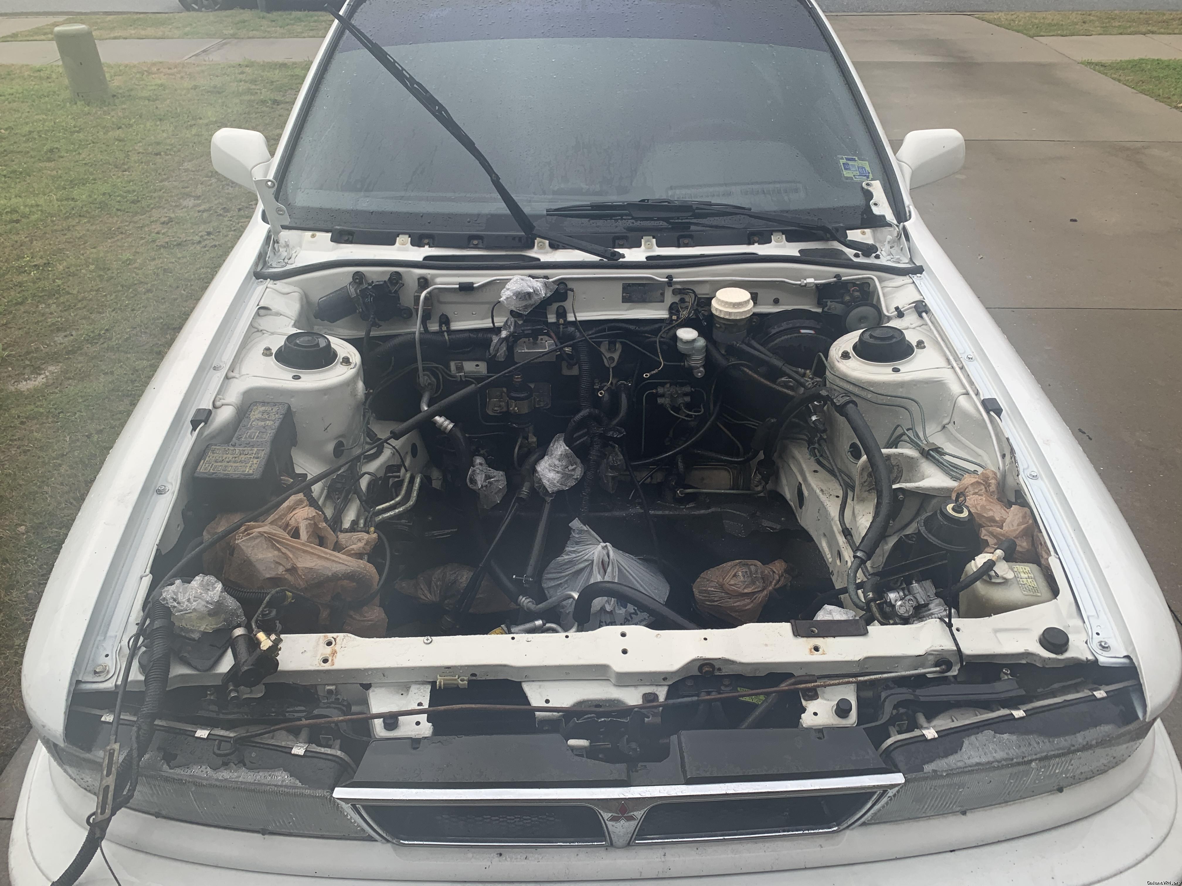

Here is the first cleaning of the engine bay (disclaimer: this engine and the bay at some point will have the whole compartment stripped, cleaned and repainted)

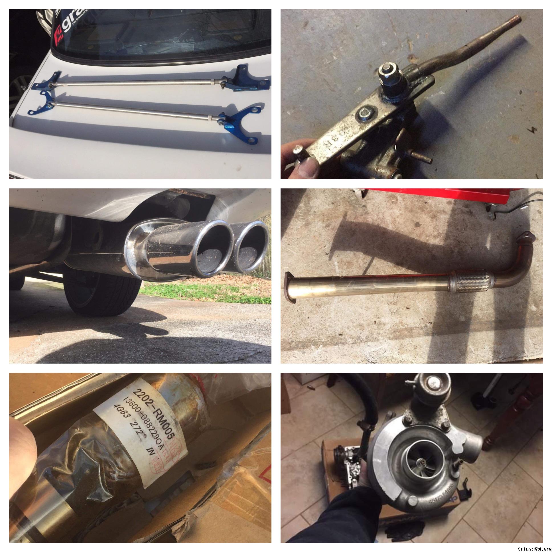

So along with the car I got (most) of the parts needed to get it back running and also some upgrades along with it (272 cams, 20g turbo, full turbo back exhaust, short shifter, strut tower braces)

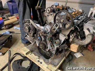

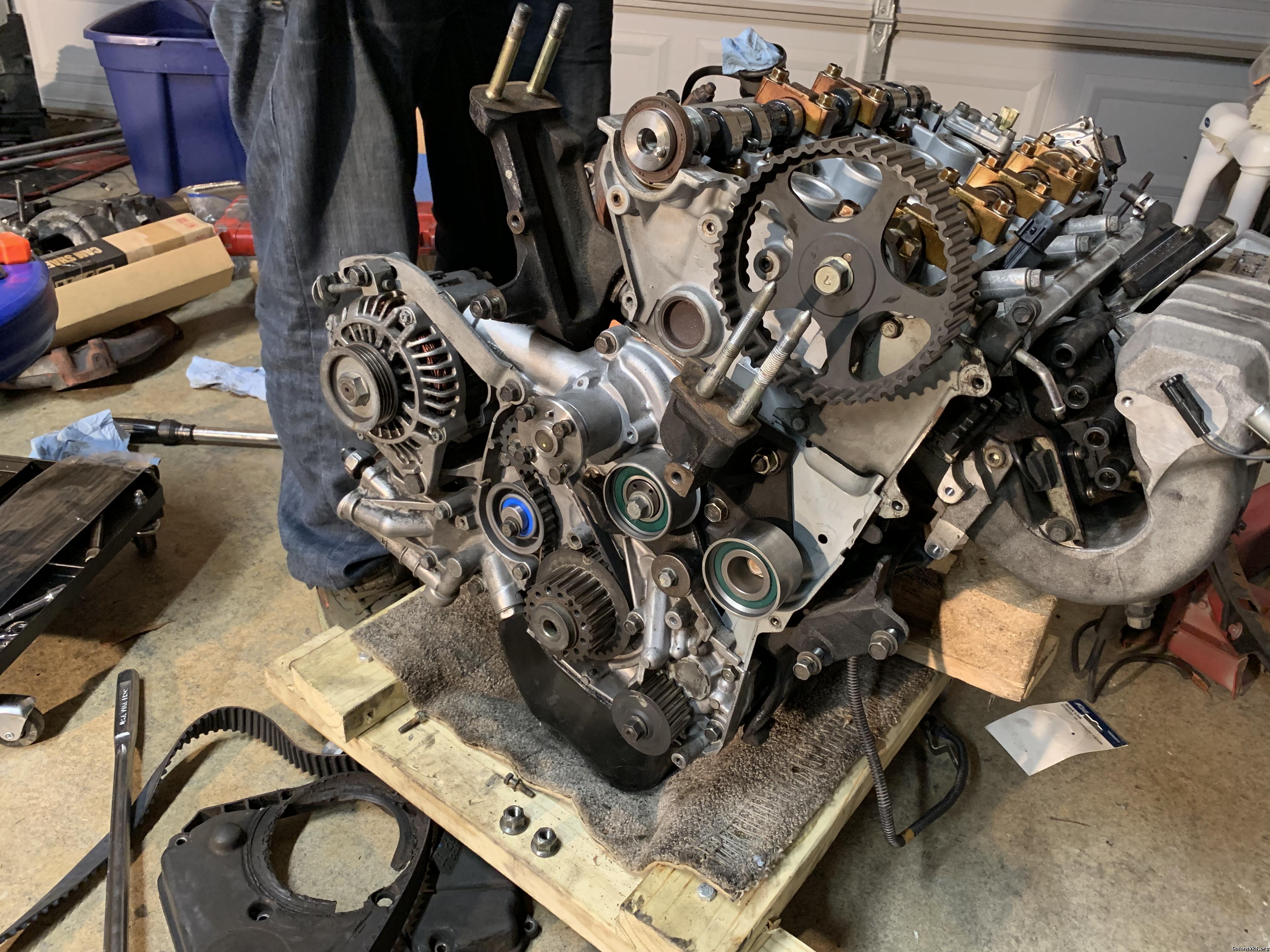

The motor had been prepped to be put in a 2g DSM so I had some
Swapping of parts to do before the heart could be put back in the GVR4
This forum, Miguel and especially POT so far has been such a big help with parts and how-to knowledge that has been invaluable. Miguel forgot some

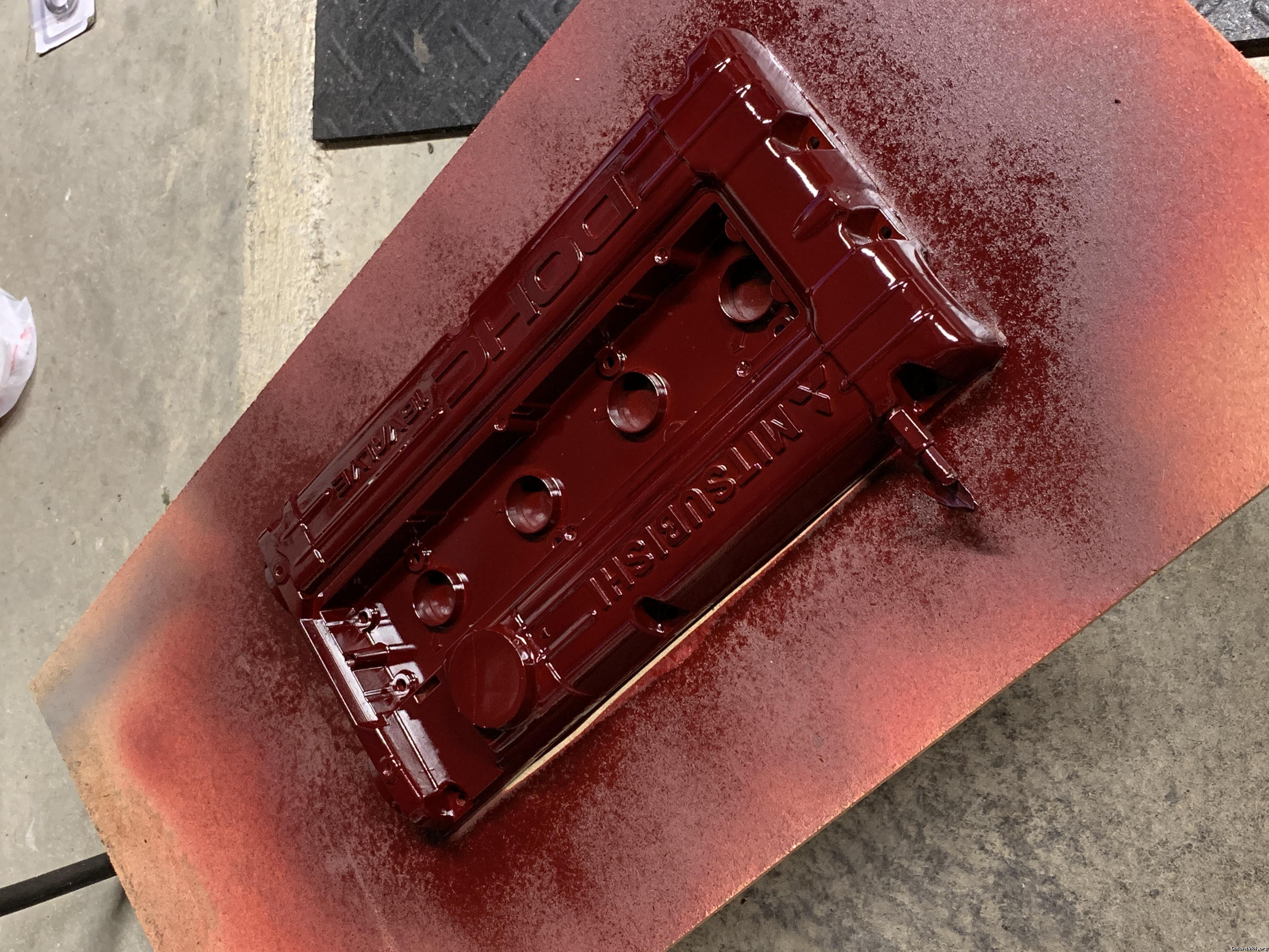

Of the 1g parts I needed and sent them to me ASAP! I had to swap the driver side motor mount bracket, the alternator, water neck, and PS pulley and while I was doing all that I went ahead and installed the 272 cams and painted the valve cover. I was going for EVO 8 blood red, it turned out a bit darker, little dark for my liking but it’ll do for the time being.
Alright let’s drop this motor in!! Oh wait.. I don’t have trans or transfer case bolts <img src="/ubbthreads/images/graemlins/uhh.gif" alt="" /> couple orders to rockauto and STM later I had a bunch of new OEM fasteners, sensors and some other odds and ends. I ordered a new knock sensor because the stock one was leaking from the rubber ( I’ve read this is quite common) also replace the oil pressure sending unit because the stock one had a broke clip. I went ahead and ordered all my fluids for the engine, transmission and trans case, also new rear diff fluids just because.
Alright let’s drop this motor in! Oh wait... I don’t have motor mount bolts (teleported to Lowe’s) alright here we GO!
That pic is after I already had mounted the transmission and transfer case, but those two components got a real thorough cleaning when they were off the car, just don’t have photos of them.

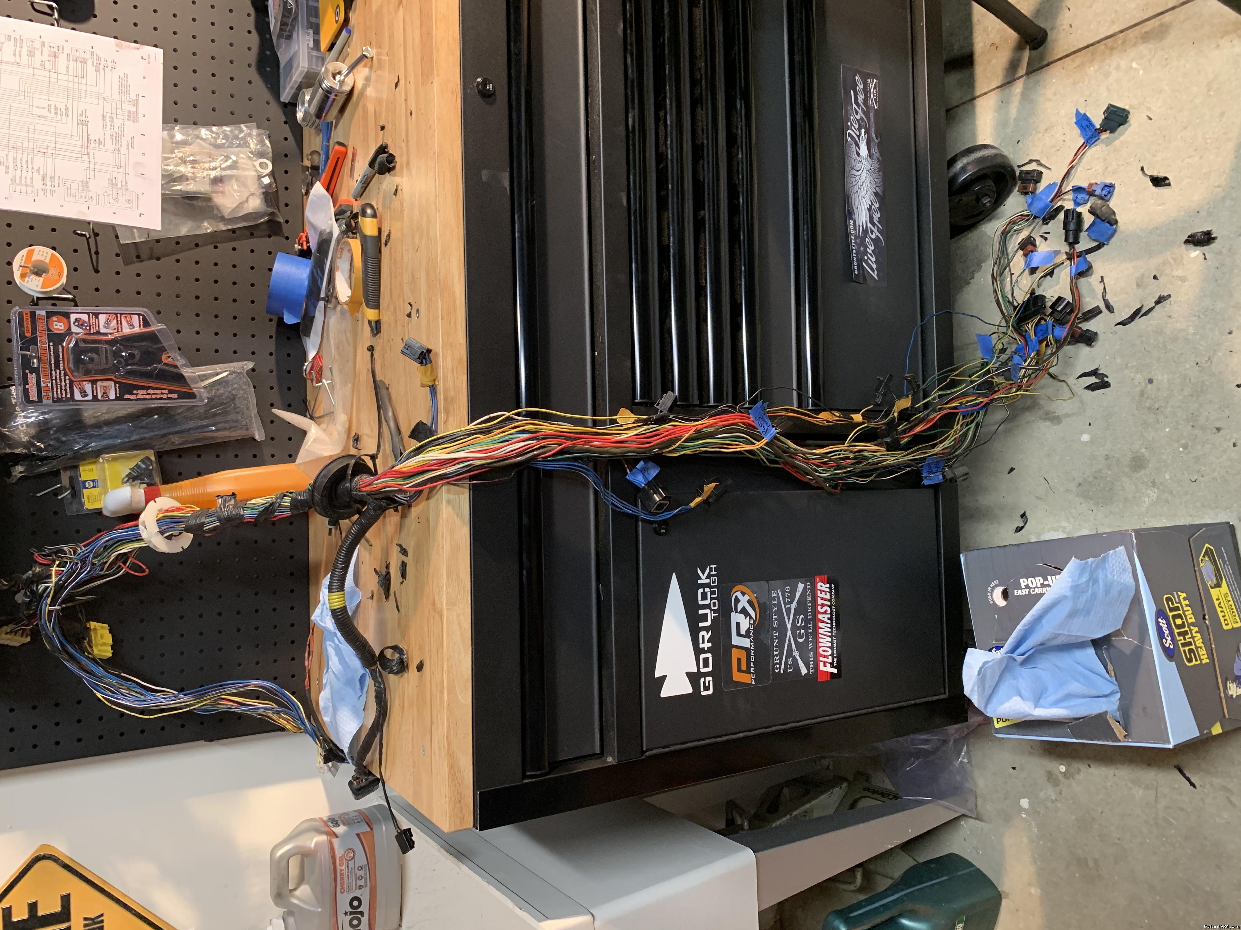

I started connecting everything, TPS, injectors etc and then I grabbed the A/C Coolant temp switch connecter and (I’m not exaggerating) it crumbled in my hand pretty much... <img src="/ubbthreads/images/graemlins/mad.gif" alt="" /> I was so disappointed.. it was then I started examining the rest of the harness and it was in rough shape. So after seeing numerous DIYs on here with harness refresh/rebuilds I decided that’s the route I’m going to take, so that brings us to today!
Here I have the harness about 2/3rds stripped of all the OEM loom and tape, MAN that stuff is on there!
Decided I’m going to do a hybrid repair/rebuild of the harness, POT is hooking me up with a donor harness so I’ll use what I can to keep OEM color codes throughout to make repairs easier in the future if the need arises. I plan on stealing strokin4doors harness design idea and having each sensor have its own shielded and heat shrunk wire going to it, or course crimping and heat shrinking the wire splices as well.

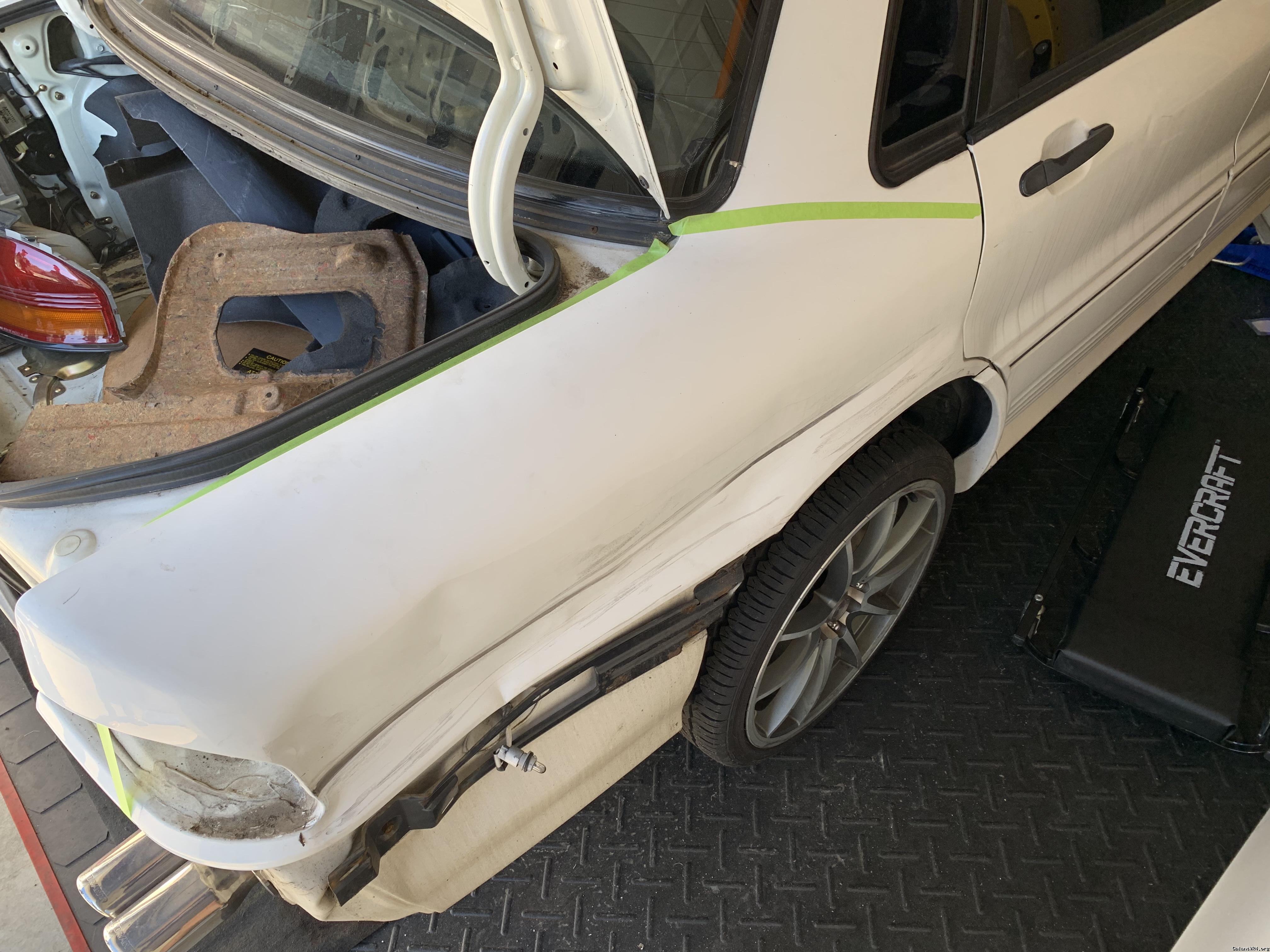

Holy crap! I didn’t mean to make this first post so long! I have so much more to talk about but I suppose I’ll save that for an update, oh here is a picture of the 1/4 panel damage... that will be address once the car is mechanically functional.

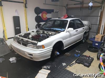

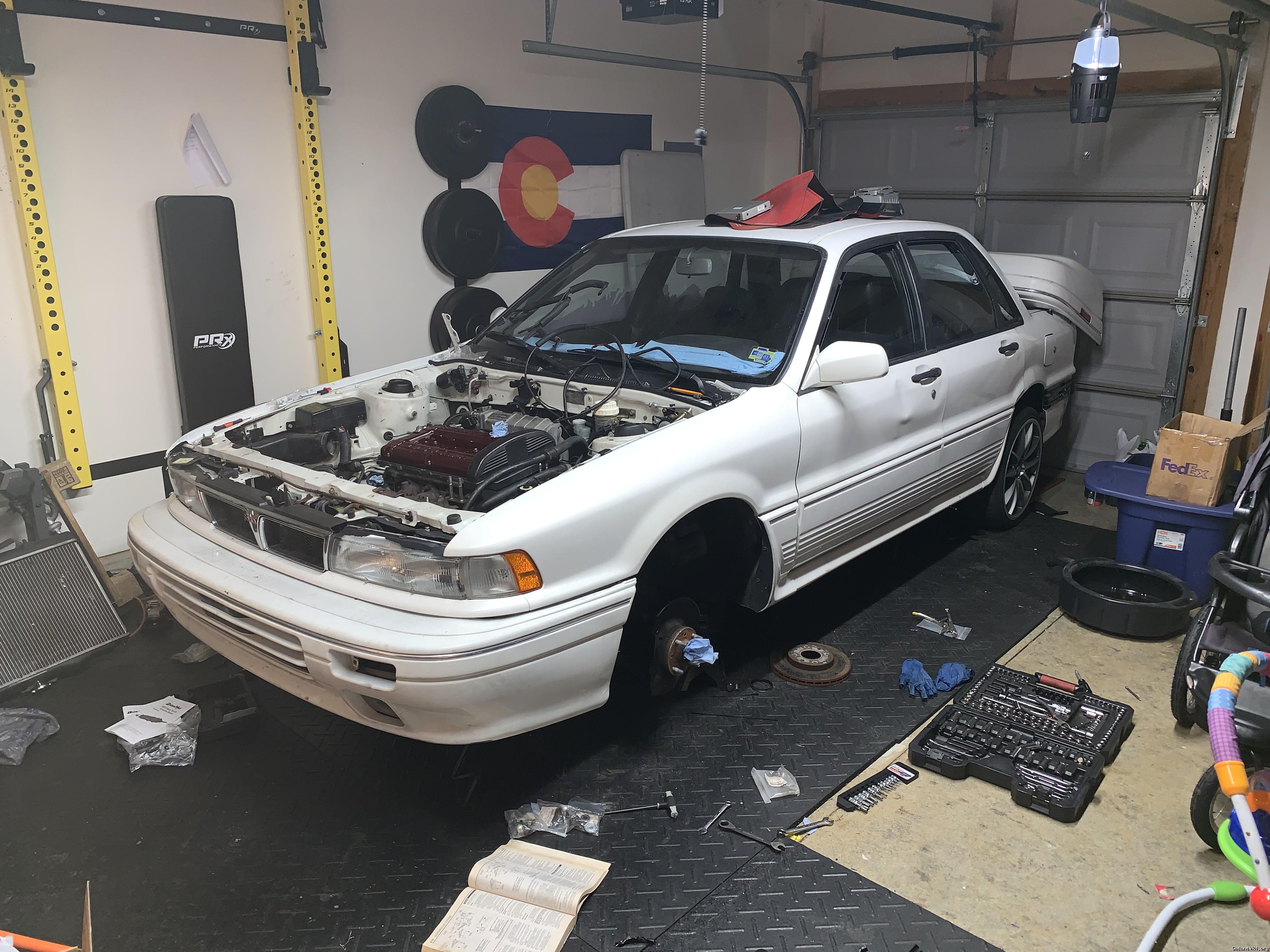

And a photo of how she sits at the moment, kinda sad looking lol.

So I have been on the hunt for a 1/4 section as I’ve been told(stressed the point really) that it’ll be a much cheaper/quicker repair instead of trying to pull all that metal back into shape. Nothing has panned out so far unfortunately...
Grafting in a new panel would be exponentially more work, more expensive and more difficult.
I agree with Anthony, that should clean up fine. As someone who doesn't do body work (but who did that body work here) your "master" body guy should have no problem getting that panel straight. So long as there's no structural damage, you're better of beating the sheetmetal back into place.
I love seeing people save these cars. Looking forward to seeing more progress, and thanks for sharing your progress so far.

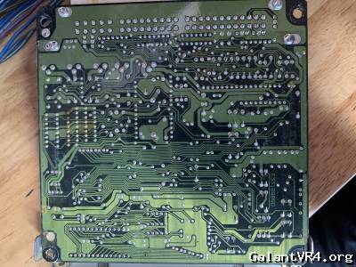

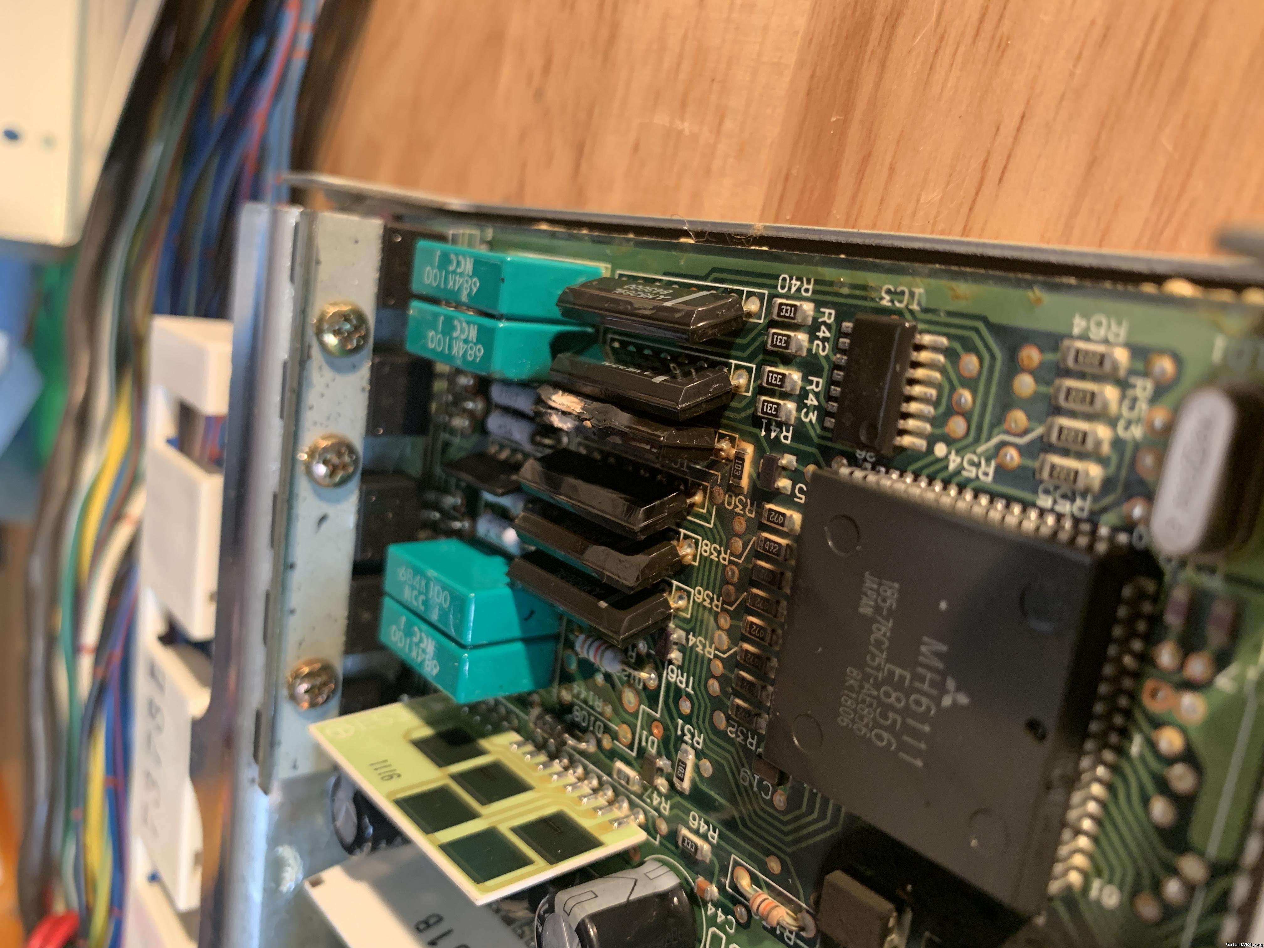

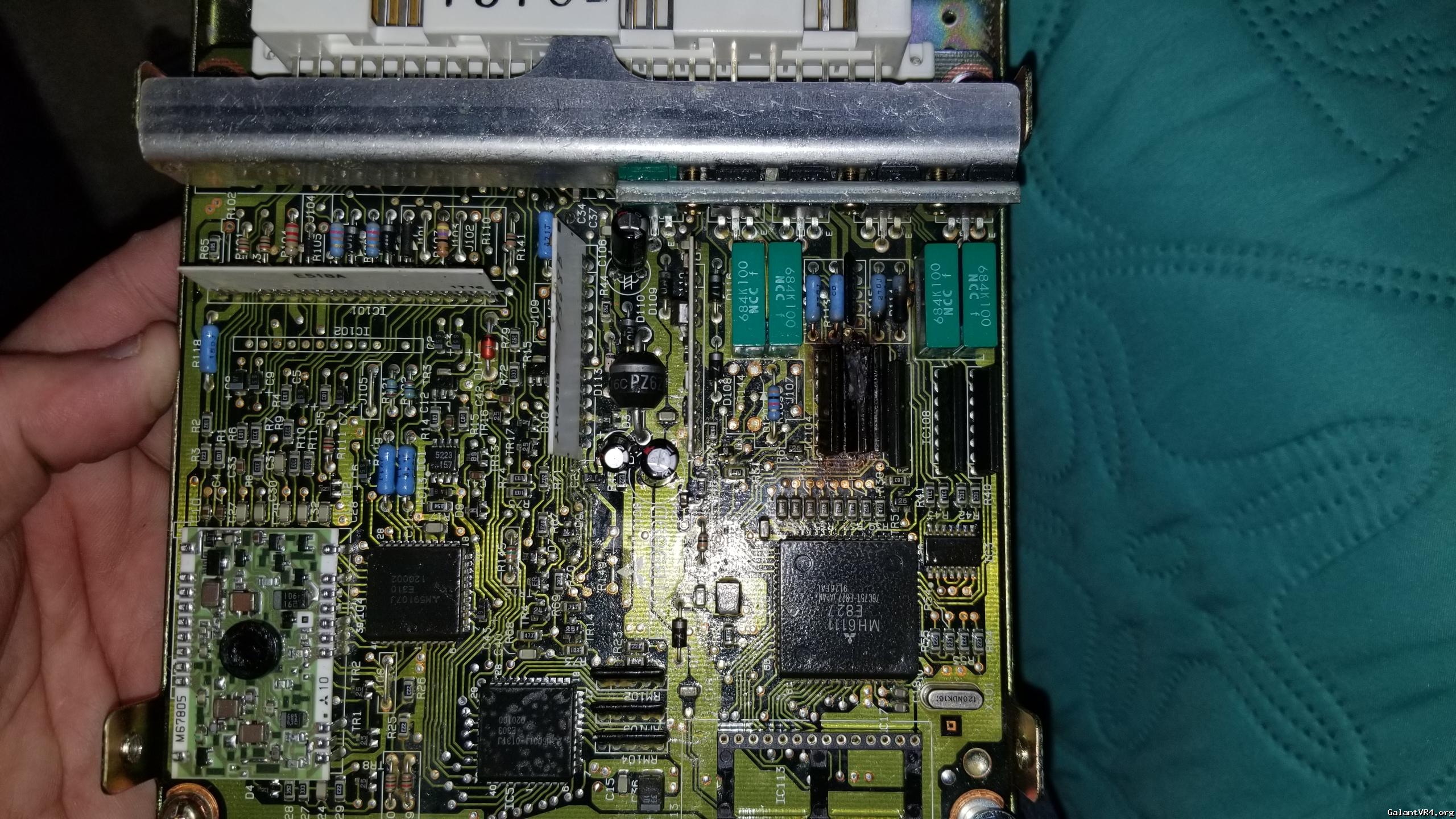

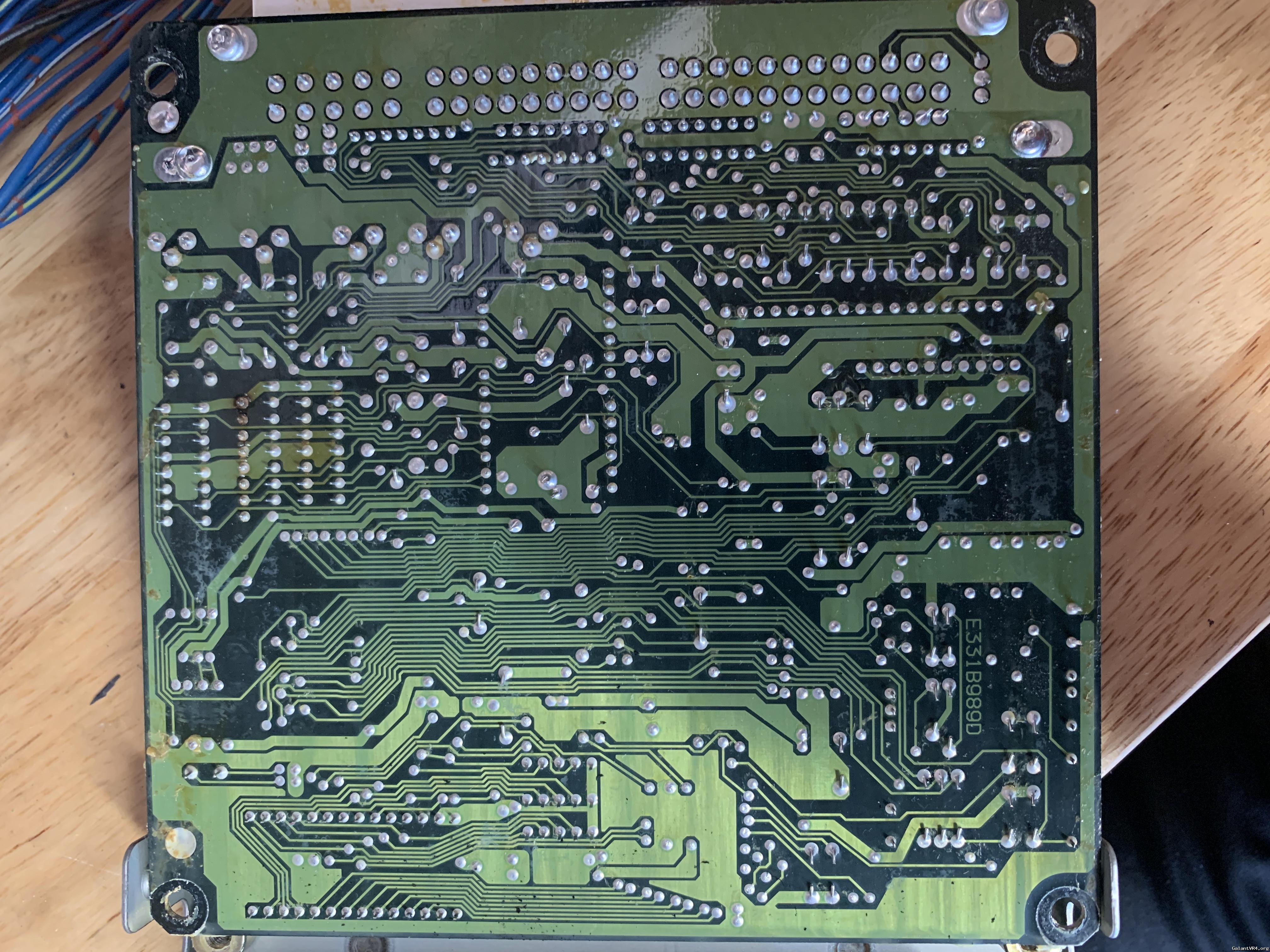

This unfortunately just became more complicated..
Send it to ecmlink in MD and within a week they will have it fixed and back to you. I use them all the time.
As for the damage, I agree with Brett. May take some time, but way easier and cheaper then a 1/4 panel replacement.

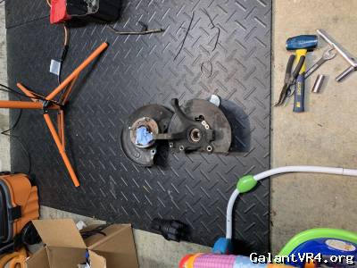

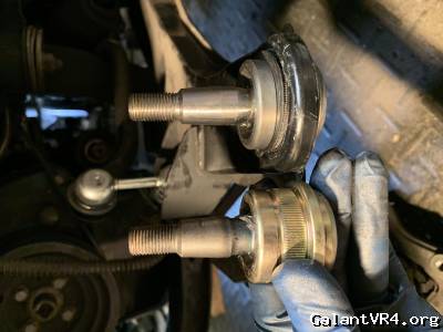

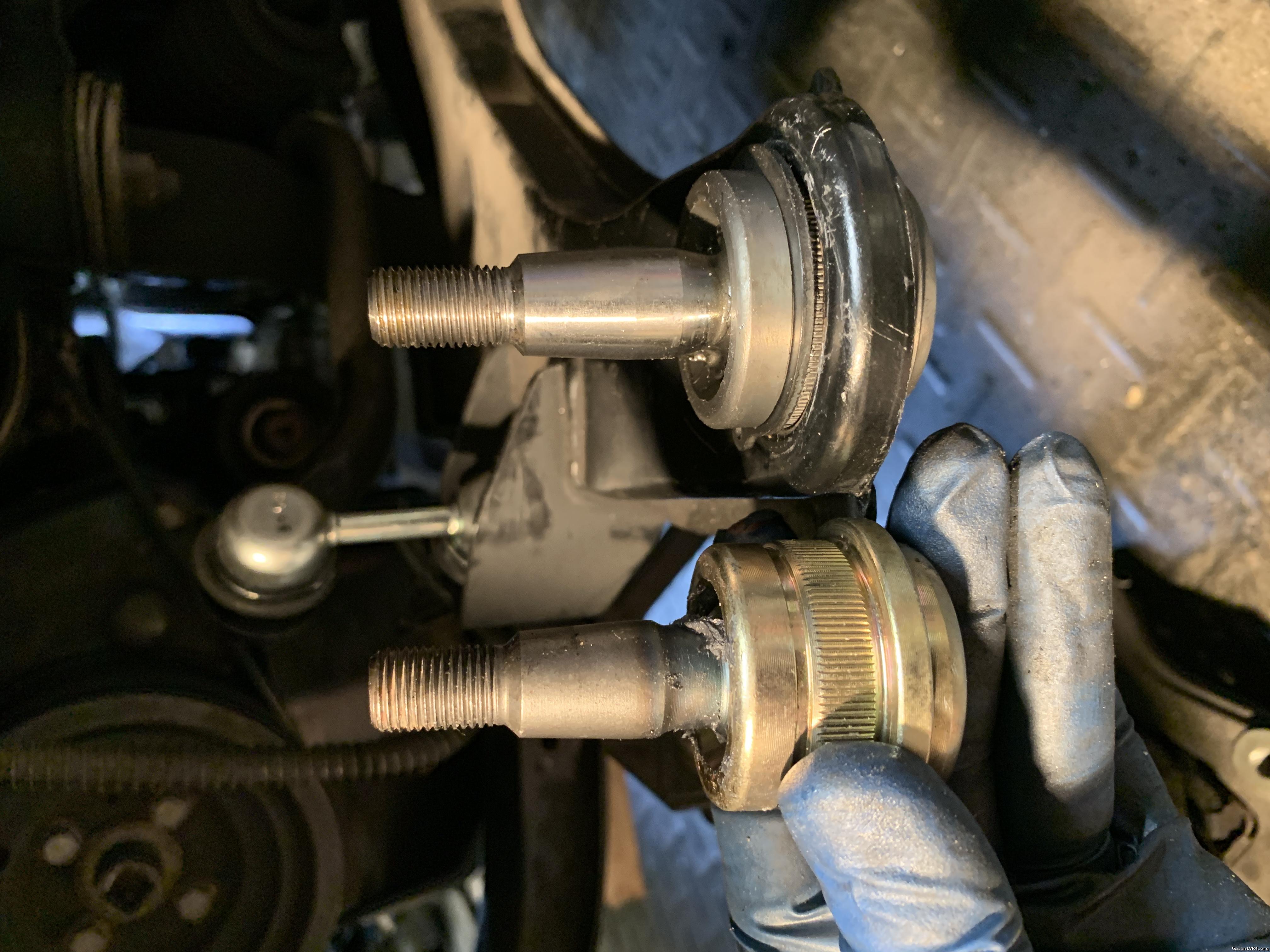

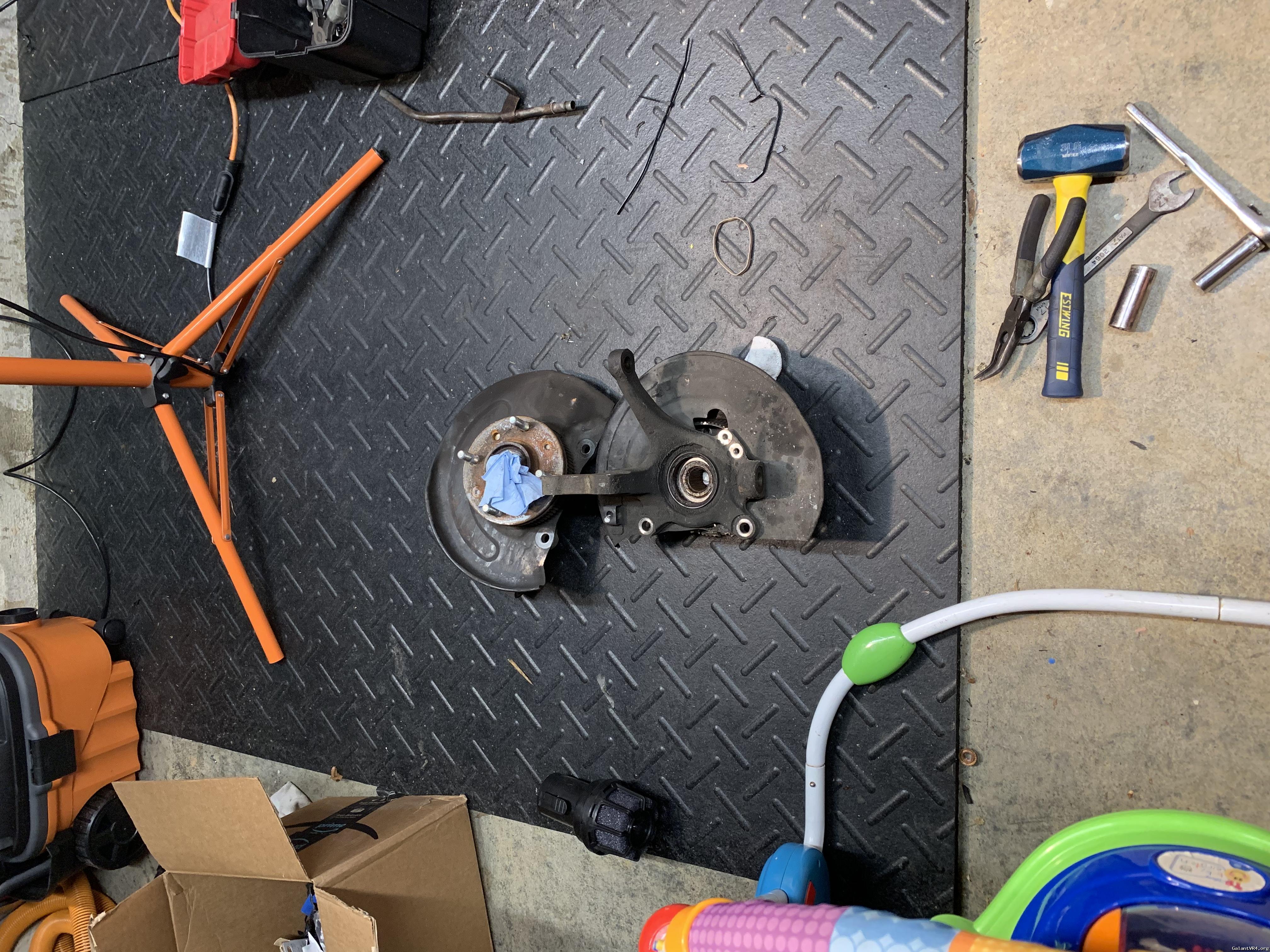

Be going the body work route, my guy is a welder with sheet metal experience I guess “master” is an overstatement lol. Tore into the front a little more to replace the front ball joints, wheel bearings and struts... rockauto sent me two different ball joints so I ordered some high quality ones and am returning the ones in the photo below.
Some more progress shots!

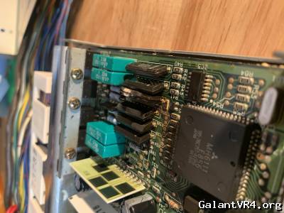

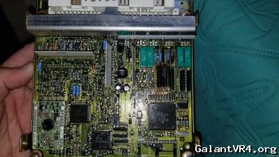

I have sent them two emails in the last 5 days and haven't received a reply to even the first email... a bit disheartening.
ended up picking up a used "good" ecu socketed with an unknown chip from John and Nate.
