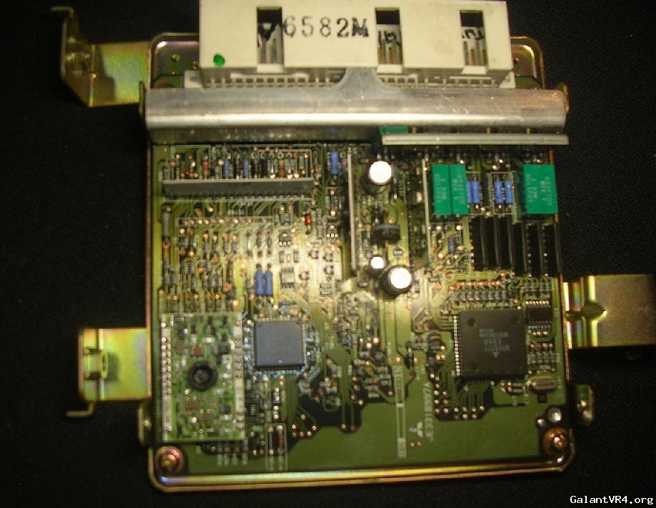

A big help would be if you could post a pic of the ecu board, as it may still be on the original caps, or there may be damage from the previous caps leaking.
The t/e/l ecu will "work" in our cars.
The fuel trims will be a little off because the ecu isn't expecting the lower honeycomb to be missing, and the curb idle on the t/e/l units is a little lower.
These are small differences, and will not cause a problem such as you are describing.
That said, just because it says it's one number on the case, doesn't necissarily mean that's the number on the board, or that it's the correct unit. Posting up a pic of the board with the number on the harness connector body visible is worth a thousand posts on the subject. If it's really a 6262 series unit, the number on the connector should be 6578, (with a bonus if there's an "e" there for e-prom)

I'm very sorry to inform you that ecu is not a good match for your car.
It's a non e-prom from an automatic trans equipped 91-92 model year t/e/l turbo.
That really sucks, becuase the auto trans turbo cars had smaller injectors and ran a different fuel pressure.
It could *concievably* be used but the comps will be wrong. This could make tuning the car with an safc or other compensating device an excersize in frustration, as the base calculations will be waaay off, and there won't be any comp for the missing honeycombs.
It also has the original caps still installed, and although it's hard to tell from the pics, there does appear to be some staining around the caps. That's a sign the caps are seeping, and there may be some damage to the traces on the board...
So yea, pretty much total fail for use in a galant you care about... /ubbthreads/images/graemlins/frown.gif
I see a new ecu in your future, and if I may make a suggestion, it would be to contact keydiver. He has the best knowledge base on these ecu's of anyone in the business, and you will have zero issues dealing with Jeff.
Try and get one of his virgin 94 model e-proms, and then he can also cut you a cool guy chip to personilise the ecu to your particular set-up, and ship it installed in the ecu for a true plug and play deal. (The 94 ecu's are not plagued with the cap issue, so the board will be virgin )
