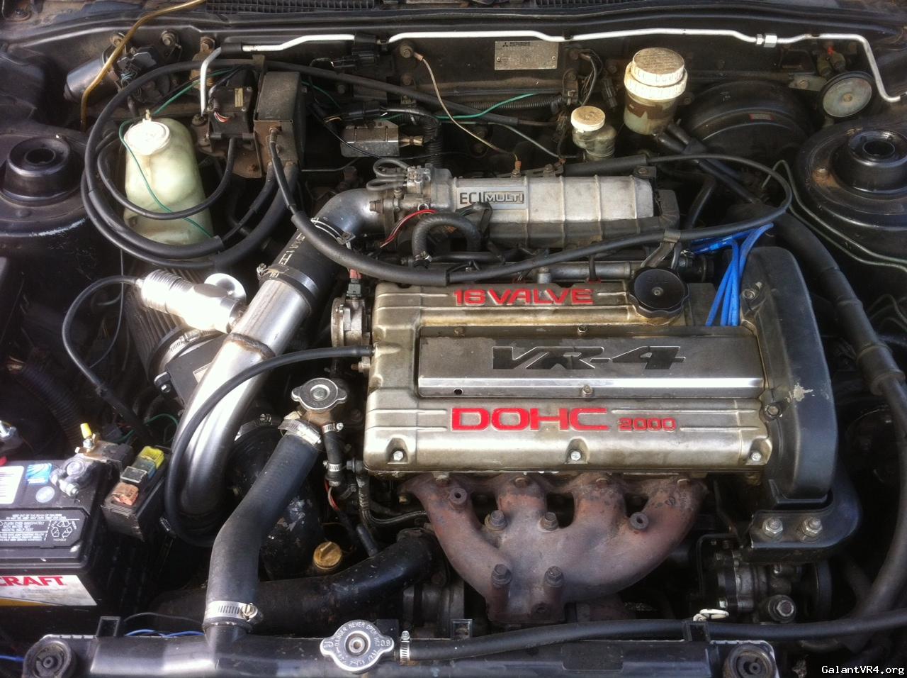

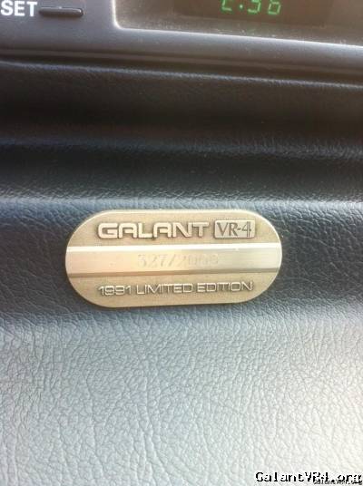

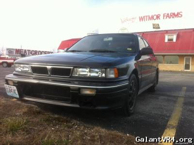

Hey everyone my name is Steven im 21 and i just traded for a 91 Galant VR-4 327/2000. I ended up trading a 97 Buick for the Galant because my friend needed something to drive since the galant didnt run right. The Galant is misfiring has a couple of oil leaks, coolant leak, boost leak, and a vac leak. I know it needs a tune, valve cover gasket, new plugs and wires and the idle adjusted from what i can tell so far. I dont know how to find a boost leak or a vac leak any help?

Look up how to do a boost leak test. It's easy. You take off your intake(air filter to turbo) and pressurize the whole system. Your boost leak and vacuum leak are probably going to be the same thing...

Ill try that and hopefully it reveals my leak and ive been told alot that changing the plugs and wires would get rid of my misfire is this true?
