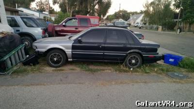

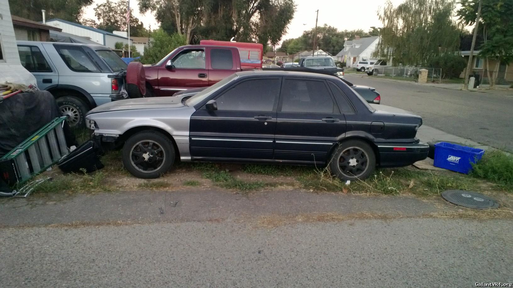

Well to start off, my name is Codey. I recently purchased a 1990 Galant GSX, over the past month or so, I've been purchasing parts to do a build and boost it.

My bad, the rear end was out of a talon, but I got it off of a vr4. Thanks man, as soon as I'm around a computer I will post some pics, but be warned it is far from pretty haha.

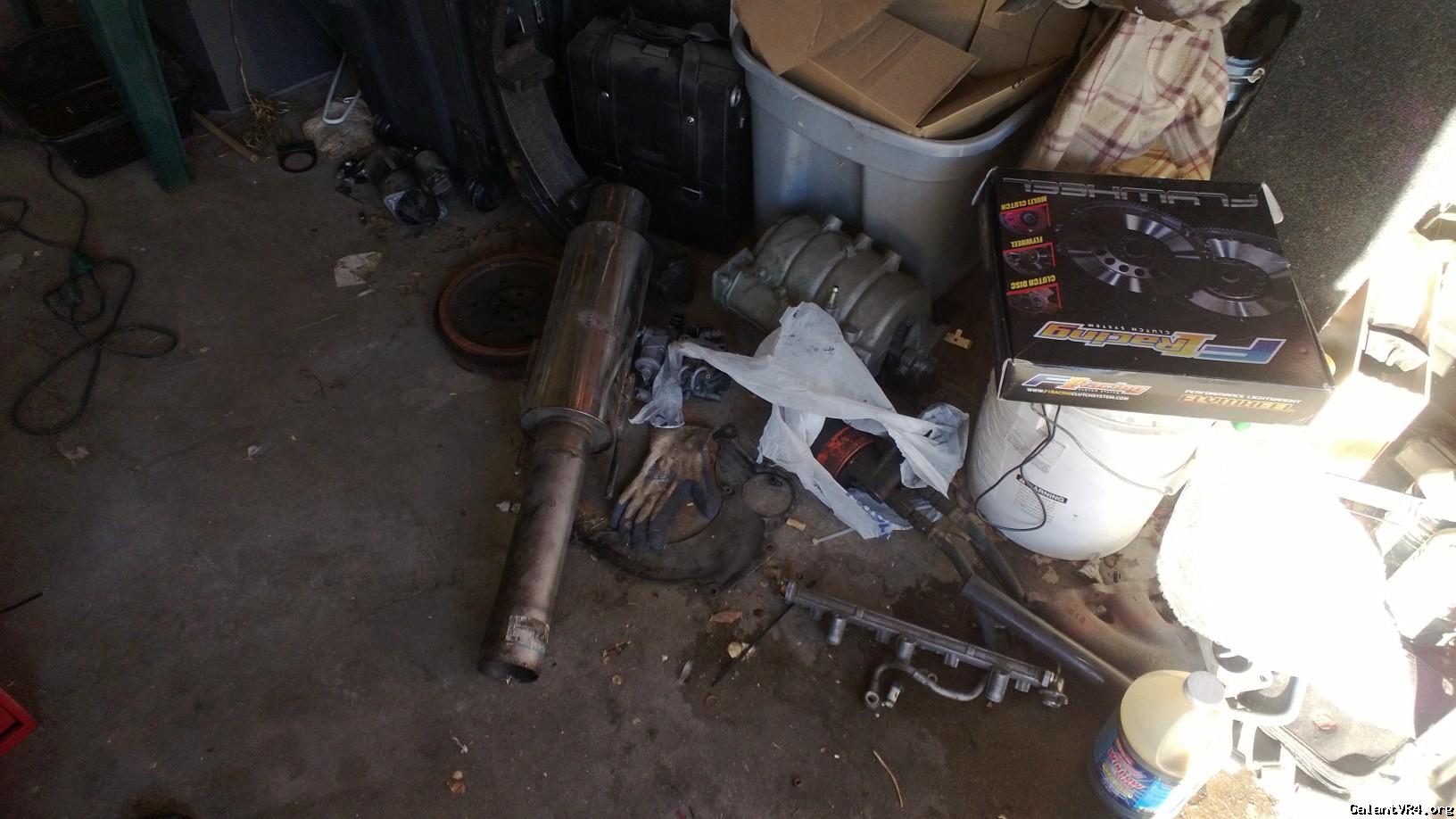

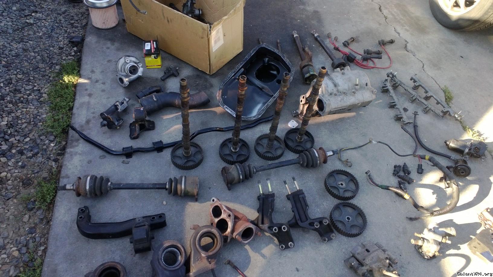

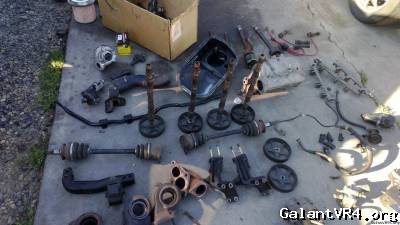

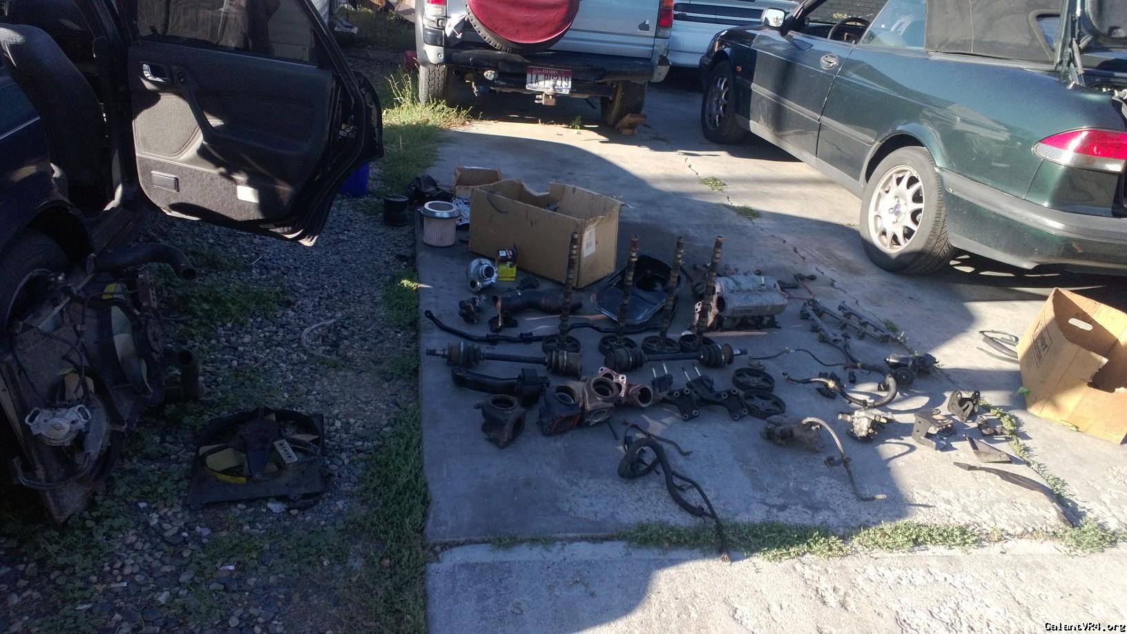

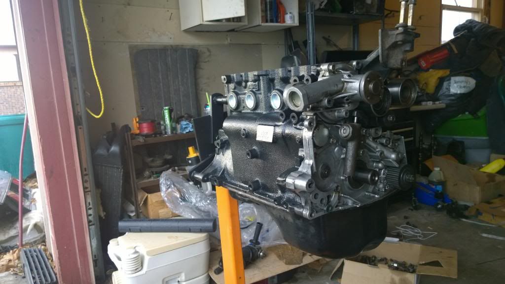

Haven't been on here in awhile, but little bit of an update. Everything has been taking a little longer than expected due to my daughter being born and the machine shop taking awhile to complete everything but:
