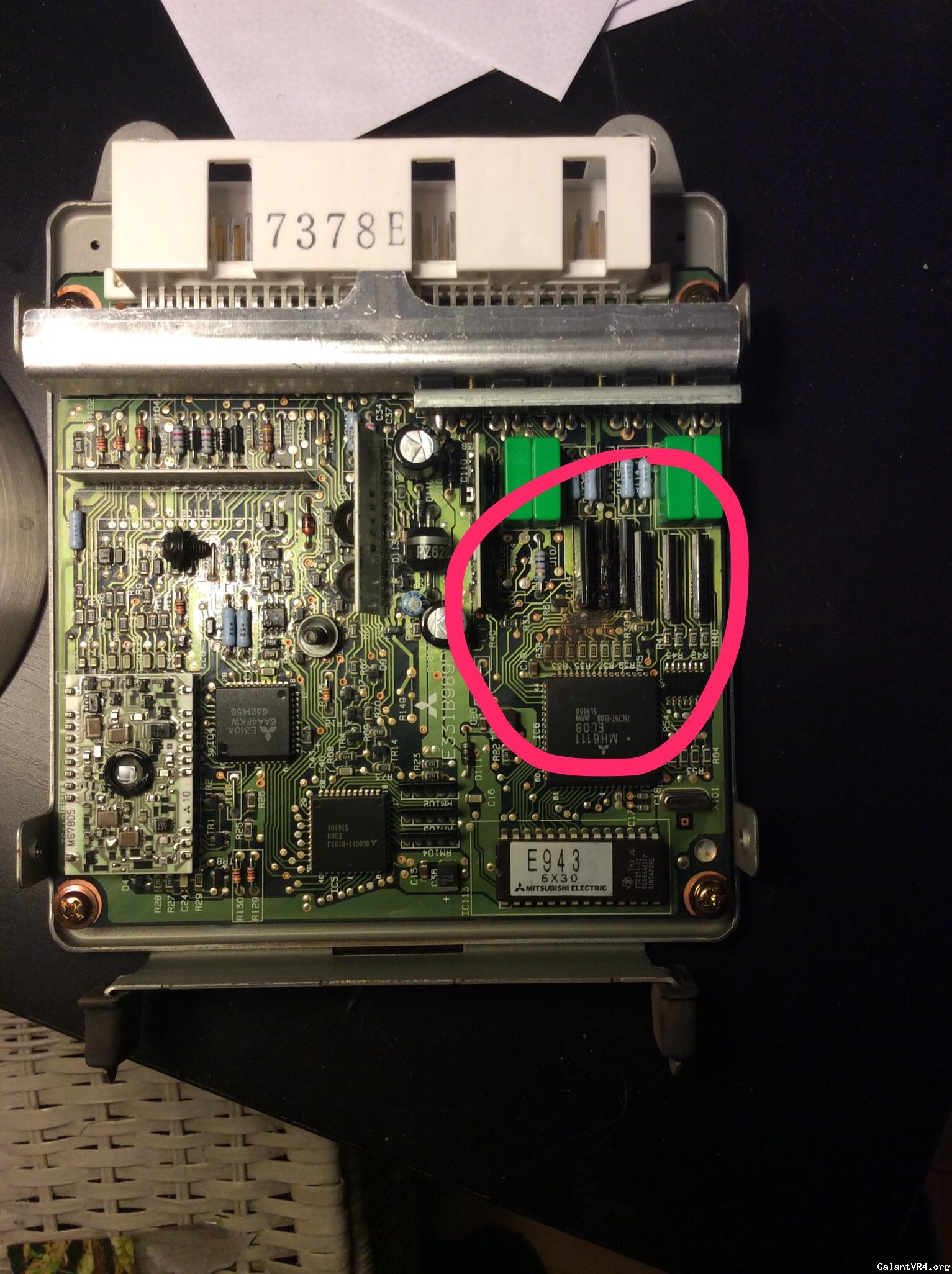

I was have lots of problems with my car and found that my ECU had melted itself. Picture here.

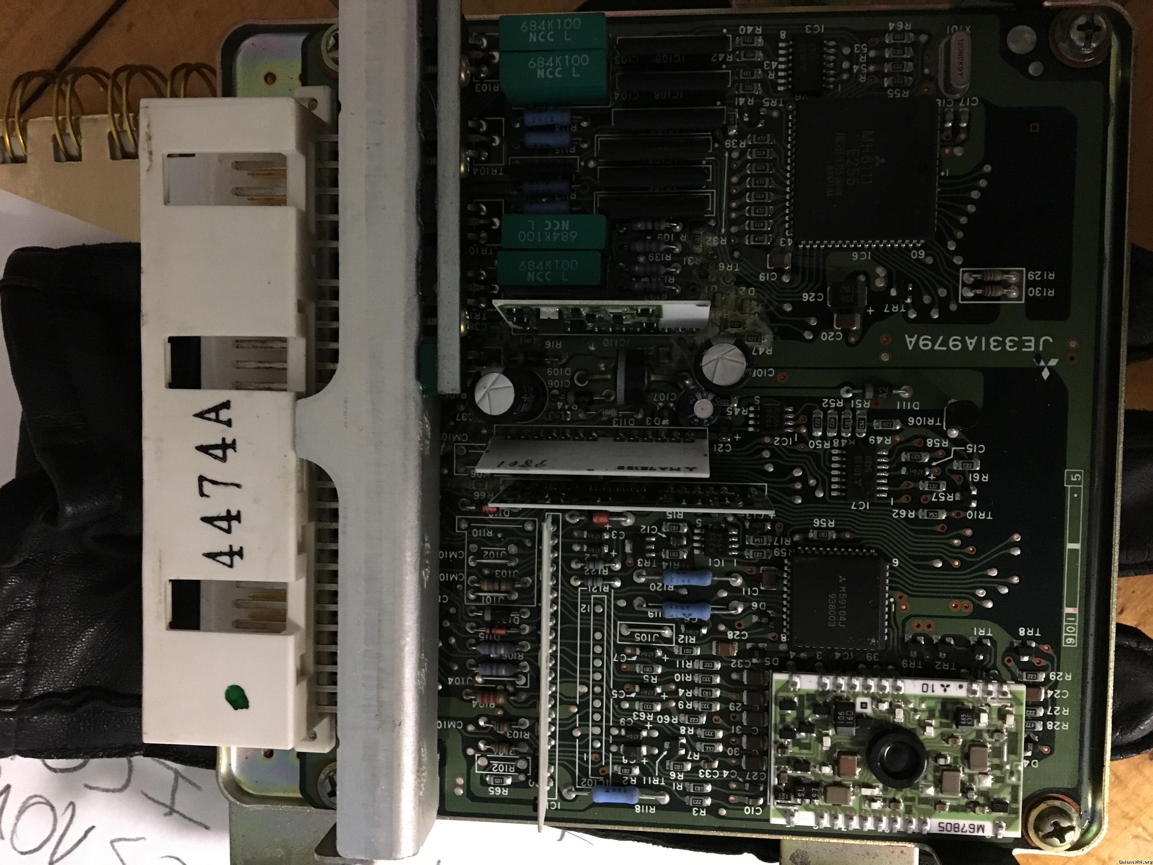

For reference this is the "new" ECU

Yes I fact it turns over harder than it did before. I also noticed that with the key into the on position the check engine, and 4WS idiot lights do not light up. Also this ECU has a blow cap. I'm hoping the seller just accidental sent me the wrong one as it's also not in the same case as the one pictured in the ad.

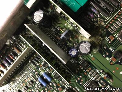

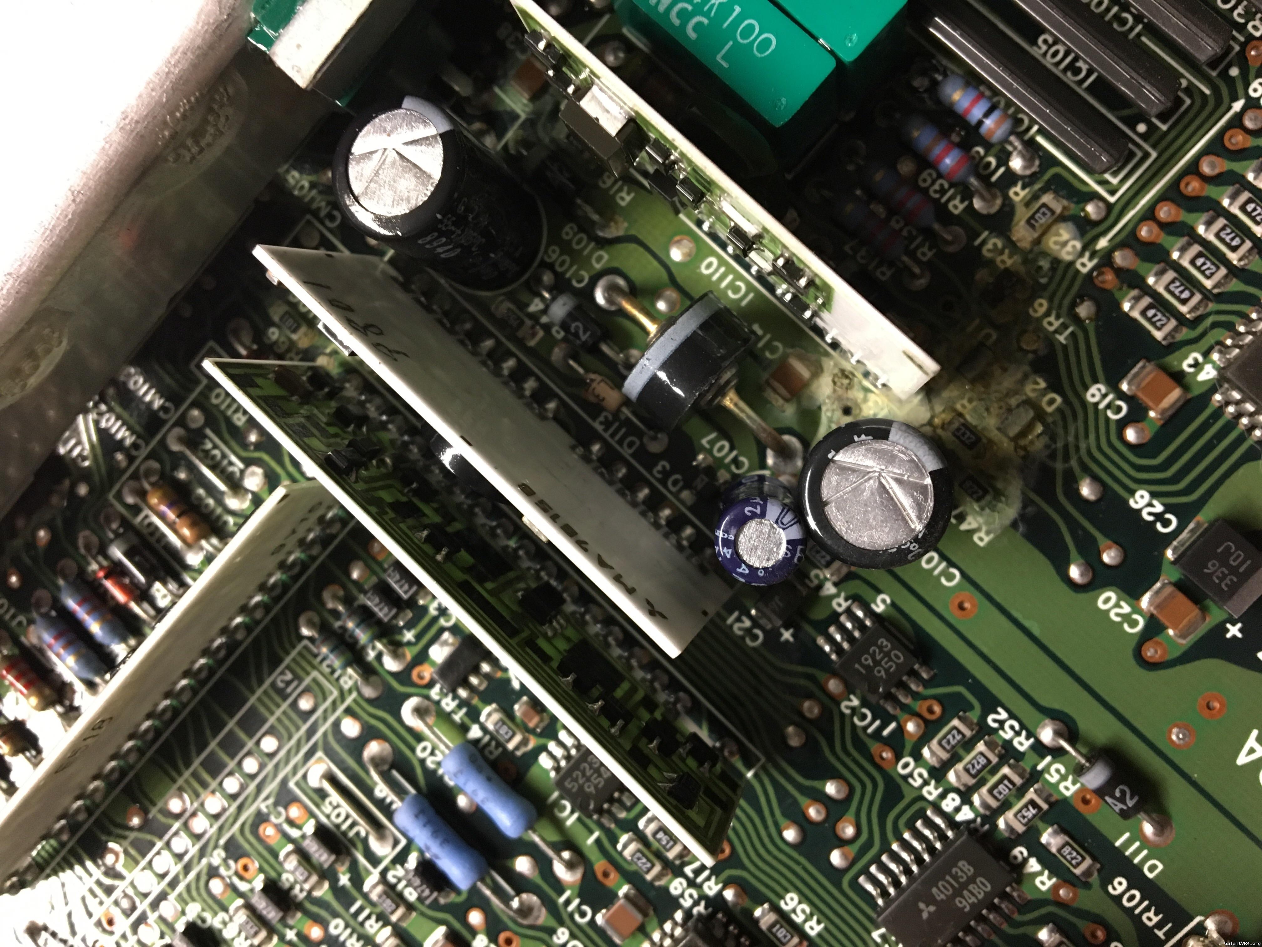

1) It's not a USDM GVR4 ECU since it's not EPROM.
2) PN # 4474 (affixed with E2T3) is for an early model 1G DSM Turbo FWD car ---> click . For a 90 ECU to work correctly in a 91+ car ECU pins 6 and 14 need to be swapped. So, no, it's not plug and play for your Galant.
3) That capacitor sh*t all over the board, and is probably the reason the car won't start.
4) I'd message the seller and arrange a return.
5) Replace your ISC. Looks like IC105 blew, which means coil pair B on the ISC is shorted ---> click . If you plug a new ECU into your car with the bad ISC installed, it will just blow the driver again.
6) Lastly, your ECU can probably be repaired for under $100 bucks. Send it in to ECMtuning and they will get you squared away. They will repair and test the ECU to ensure it's good to go ---> click

1. I advertised it as a 1990 Turbo ECU, not a GVR4 ECU. I had two at the time of the advert start, this was my last one.
2. This WAS running my GVR4 without any wiring changes up until fall of 2015 when I bought a socketed VR4 ECU. I never had an issue when running it except it was in a 1g case and had to leave it against the firewall. I did not have switch any pins around. to get it to run. If that is required, then I don't see why this worked, but it did with a 2gMAF and 560's.
3. I sat for about a year on the shelf, I didn't bother to check the board to see if the caps leaked while sitting there. I see I should have.
4. He is returning it and getting a refund. No issues with that from me.

In most cases, not swapping pins 6 and 14 won't cause the car not to start/run. Those two pins are for the idle switch input. The obvious problem will be crappy idle if the pins aren't swapped. If you don't swap the pins, the car doesn't receive a signal from the IPS, and therefore doesn't know it's supposed to be idling. If you're running ECMlink and simulating the IPS from the TPS, then this is a non-issue.
I don't believe the pins not being swapped are the cause of the starting issue. I think it's more likely the result of the leaky capacitor.

The galant "seemed" to idle OK when I ran the ECU, but when I swapped to ecmlink I also replaced the harness, so maybe this harness was already modified? It had some iffy wiring for sure. Once he sent me a pic of the mo-board I knew the caps had leaked. Guess I will be replacing caps and testing the runs to be sure the ECU is ok once it gets back.
