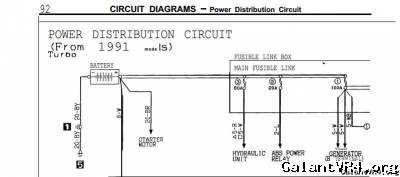

Yes I mean alternator haha. I was just saying that I know the wiring can handle that kind of amperage from the alt because maniac sells replacements up to 135amp. I know that it won't do anything, and I know that its not the right way to do it. Just an offhand suggestion because I never thought replacing an alt would take me more than a full day or make me feel this dumb. I know it's a stupid idea, and even if it worked the real problem would need to be found ASAP.
Thank you for the diagram, at least now I have a picture of what I'm working with. I guess I'll be having fun finding the problem in all these oil soaked wires... I'm just gonna have to start at the alternator and work all the way back to the battery I guess. It has to be shorting somewhere along that route. Before I do that though I'm gonna go ahead and clean all the connections and replace them just to see if maybe that was it, but it's probably not. Have a couple more fuses showing up at the parts store tomorrow (I blew the 2 they had in stock... oops)

3,473
Hey, you end your question with "A stupid BMW guy" and I gotta pull all the stops /ubbthreads/images/graemlins/cool.gif .
I've never had this issue specifically, but I did have a starter issue that was similar. Turned out to be a crappy ground. I'm pretty sure the alternator grounds through the case, so make sure all the mounting points are clean.
If I remember right, the charging wire is a thicker white wire. It traces down from the charging post on the drivers side, along the lower front core support in a wire loom. It then traces back up the passenger side to the fuse box under the hood.
You could disconnect the factory wire and run your own, to rule out a short to ground in the factory harness. Try and run a wire directly from the charging post to the fuse panel. Make sure it's heavy, I'd say at least 8 AWG.
