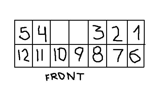

As Bris said, it would help to know exactly what you are looking for. I posted this a while back, which shows that pin #12 is GROUND, and pins 1 & 10 are used for ECU communications. Whenever you ground pin #10 you are actually putting all the computers in diagnostic mode, including the ABS, cruise, ECU, and TCU if its an A/T car.

Ok, I have that OBD1.5 on my Galant. It has OBD2 plug and OBD1 plug, but all wires go the the back of the OBD2 plug and only one wire goes to the OBD1 plug. Also, all my error codes are OBD1 and the only way to read them is by counting the flashes of the CEL, but I need to be able to plug a logger when tuning the car. What iM trying to do is to get an OBD1 plug and run the wires straight to the ECU and make it work for logging. Thats why I need the know what wires go to the back of the OBD1 plug, so I can run independent wires from the ECU.
