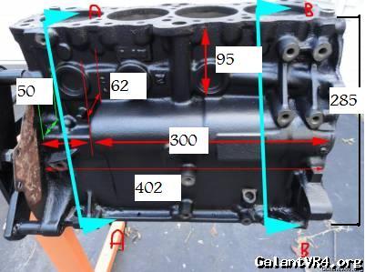

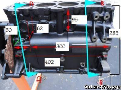

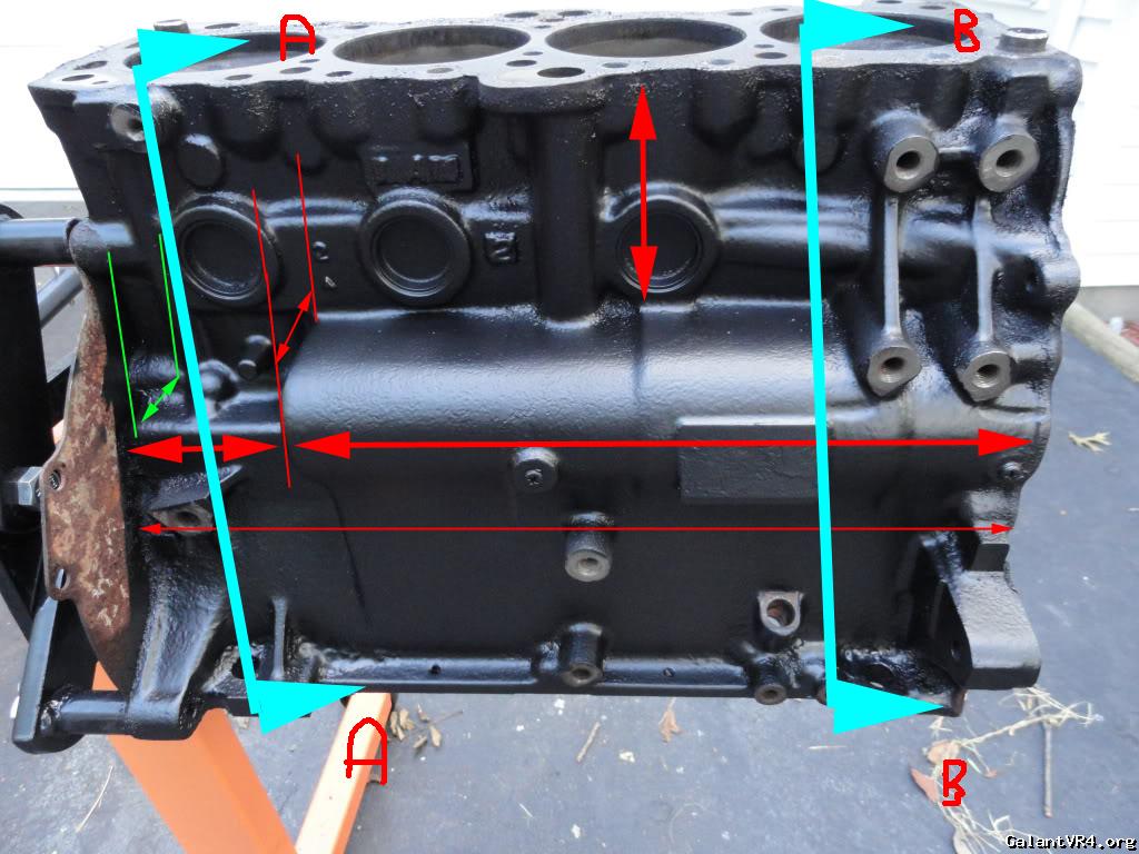

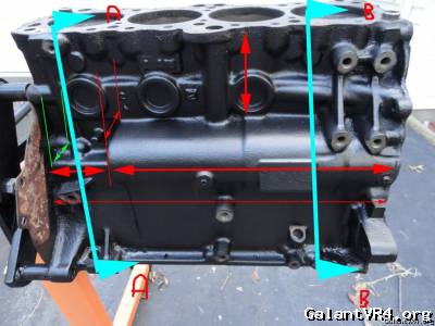

Has anyone got a motor out our easily accessiable? I need some measurements as per the photochop:
I don't need anything too in-depth (nearest 10mm would be awesome!) - I'd just like to replicate the general shape to check some clearances. /ubbthreads/images/graemlins/grin.gif
Thanks in advance
From deck to balance shaft casting is 95 but to edge of freeze plug is 85 with a 35mm freeze plug
Its under the workbench and easy to access so you need any more yell.

You're a legend, Curtis! I may need some more later /ubbthreads/images/graemlins/laugh.gif
