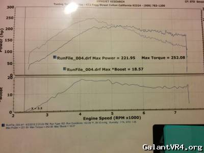

Tuner said it was crappy 91 octane gas
I was getting really bad knock at 4k and above,
Look at the graph

3,473
Output looks low for the boost level.
I need a log...Preferably one from the dyno pull. Any 3rd gear pull from ~3k to redline will work, though.

And not hitting 18lbs until 4000 rpm? Either you have some mechanical issues or that's a poopy tune. I find it suspect too that the A/F ratio isn't also on the graph with the boost. Post a log please.

Jim's right about the air fuel mixture. Without being able to see where your air fuel is in the RPM it will be hard to give good advice an the tune you have. I do find it a bit strange that your torque is that much higher than your HP. It would be nice to see where your timing is set to across the RPM range. What type of waste gate and exhaust do you have?

102 degrees Fahrenheit ambient air temperature is not optimal conditions to try and set up / optimize a tune.
... with no changes other than a drop in ambient temperature, I bet you find some missing ponies /ubbthreads/images/graemlins/wink.gif

I have overpressure from ~1800rpm and easily >1bar at 3000rpm with an evo3 16g, stock Galant RS cams ('92 model) and a little over 9:1 CR (1.8l head). peak+hold boost is ~1.5-1.6 bar (~24psi). Only knock events are at ~2800-3000rpm which are mostly only harmonics from the engine missing its balance shafts.
Are you using any boost control or driving direct wastegate-pressure? Latter one could fit your very slow boost builtup.
Your torque is accordingly quite low, especially considering the cams which should get much more air into the cylinders (if timing is set up properly...).
What are the 880cc injectors for? You're planning on using E85? I was running on stock evo9 injectors (560cc) and they weren't even close to be maxed out... I only switched to 1000cc PTEs for E85 and later engine&turbo upgrades.
The logs should include: rpm, TPS, load, ignition, AFR map and WB02 and eventually boost, which is/should be (in kPa) roughly identical to the load value anyways and hence isn't terribly important unless your MAF scalings are way off...
If you use ECU-based boost control, wastegate-duty might also be interesting to clarify the slow boost built-up.
THIS
I would expect you closer to 280hp at that boost level. You must be running fairly low timing or something else is wonky...
