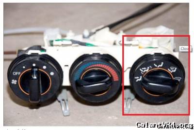

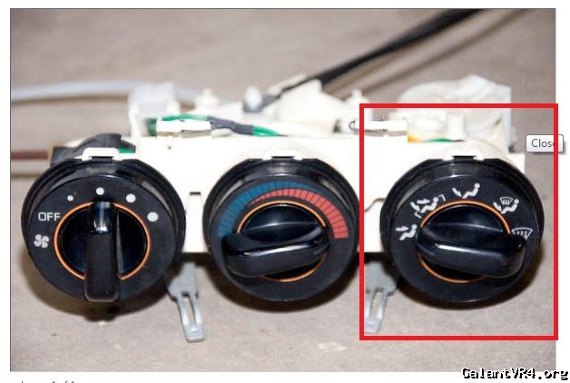

Hello. Can someone help me out or have any reference pic of the thing that this controls?
I don't know what it's called and I want to get mine fixed, maybe know what to expect when i find time to get it done.
Thanks!

Air Diverter control. Mechanical flap(s) divert the incoming air to various output vents ( top, bottom, both, defrost ).
10,996
Mode control. Cable or electrical (not sure you are saying this is from a GVR4). Typically operational problems are more likely located at the heater box itself.

This is the best picture I could get.
