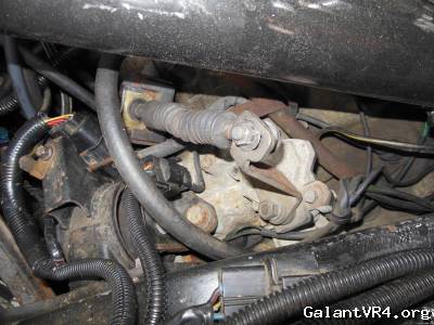

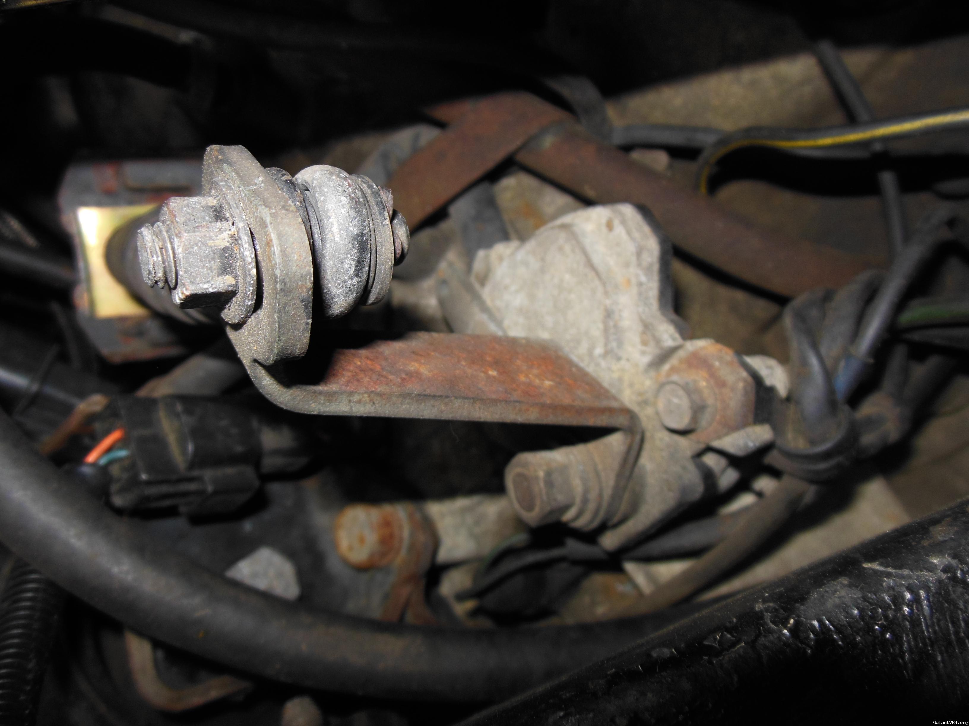

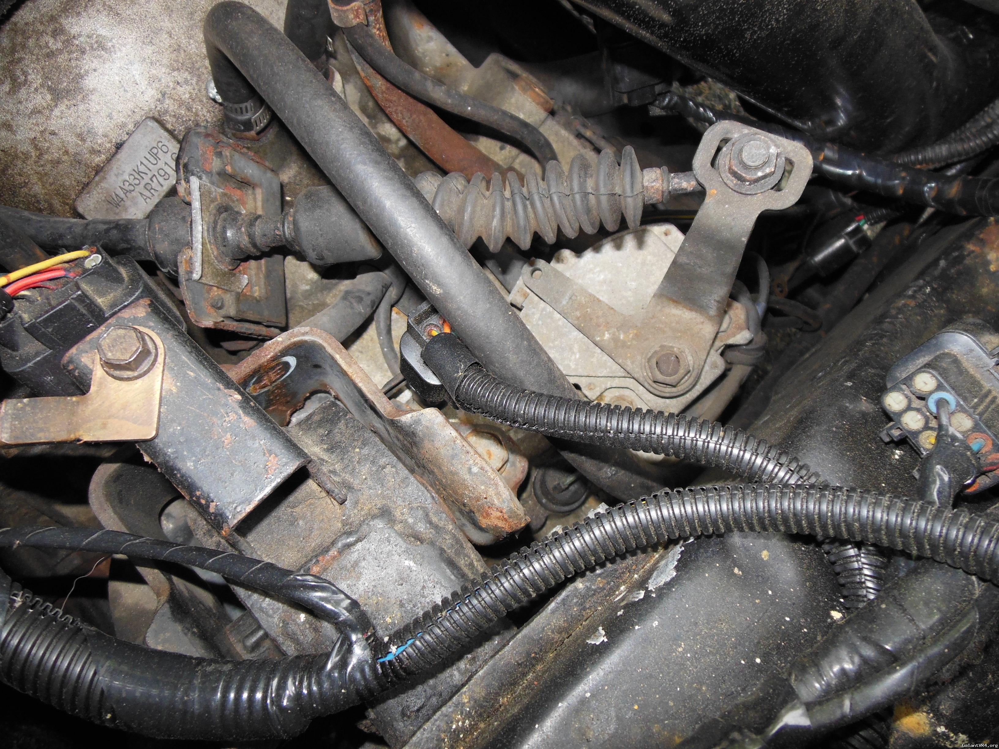

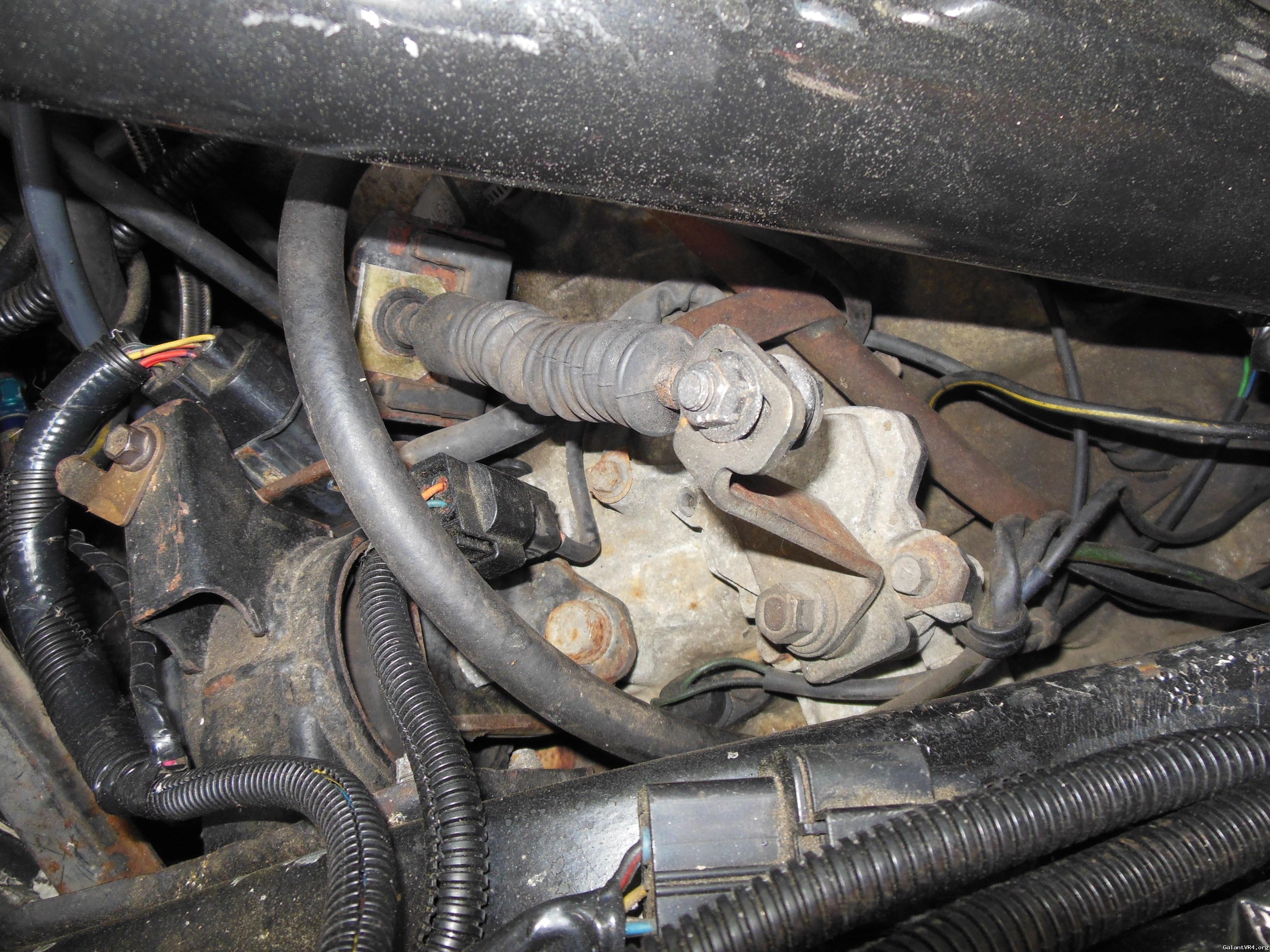

need a little help automatic shifter cable
I was just wondering if anyone has a picture on how the factory auto cable attaches to shift lever on the automatic transmission. for the life of me it just isn't making sense or if I'm just missing a piece?
Because looking at it the cable end is round and the end of the shift lever bracket is a rectangle open area without a stud vs. the manual linkages hooks to levers on the manual transmission. so I'm thinking I am missing something.
I've searched for a few hours and no luck so if anyone has an auto setup with a pic or an auto dsm I would greatly appreciate it, I can take a picture if I was too confusing tomorrow if it helps.

here are the pictures.
the rear and driver side motor mounts are the same for T/E/L and GVR4 the front is specific to the GVR4, stamp 344 i think, and then you use the mount that attaches to the auto trans
Just a bolt and nut awesome I was worried it was going to be some little piece I was missing. Thanks helps out a lot.
