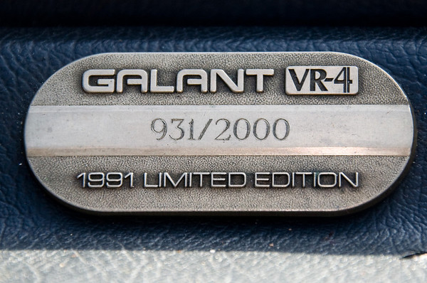

RIP This shell gave up it's drivetrain and electronics so that #139 could live.
1991 Galant VR4 #931
