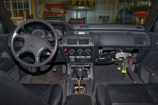

Misc Pictures
After having the windshield replaced do to the CF hood smashing it (prior to hood pin install) /ubbthreads/images/graemlins/banghead.gif
Iphone pic from Island Dragway 9/20/09
Engine bay prior to coilovers, nitrous, 4" intake
Two shots from Englishtown in August 09
Images below are from early August 09 while the car was near the end of being rebuilt.
