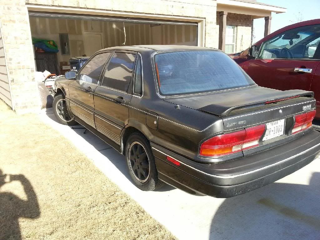

Hello all, names Jeremy just recently purchased this 91 galant vr4 993/2000 with 130k on the clock. Was always a domestic type of guy but saw his little gem on Craigslist so decided to snatch it up an try something different. I'm kinda new to the whole DSM(don't flame me for that) world so I'm sure y'all will be hearing a lot from me. The body an interior is pretty clean for being 23 years old.

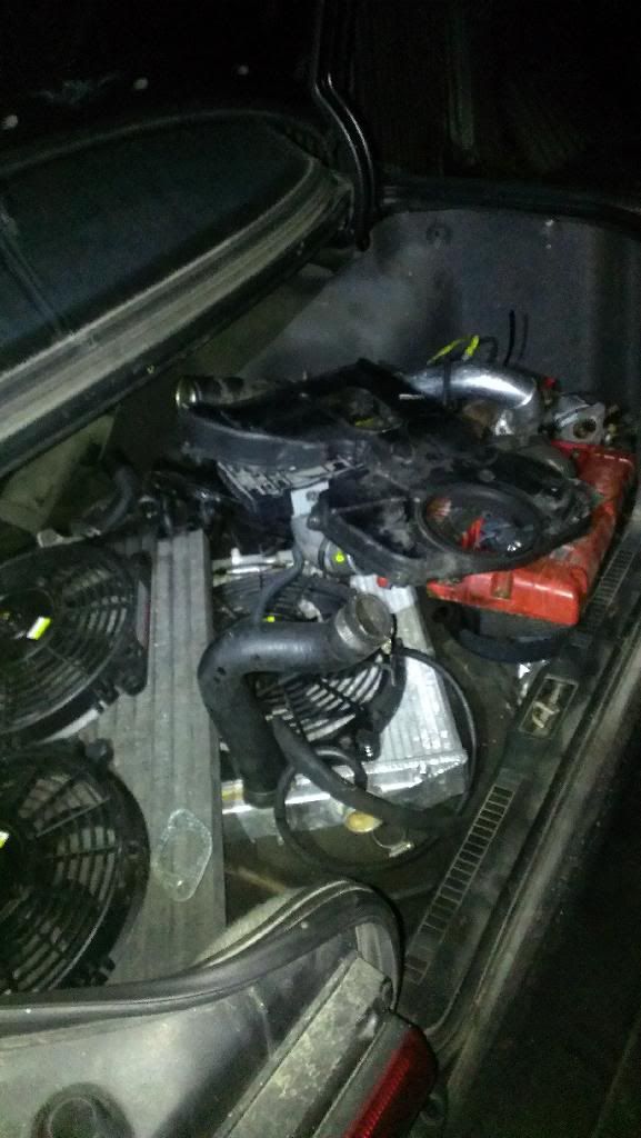

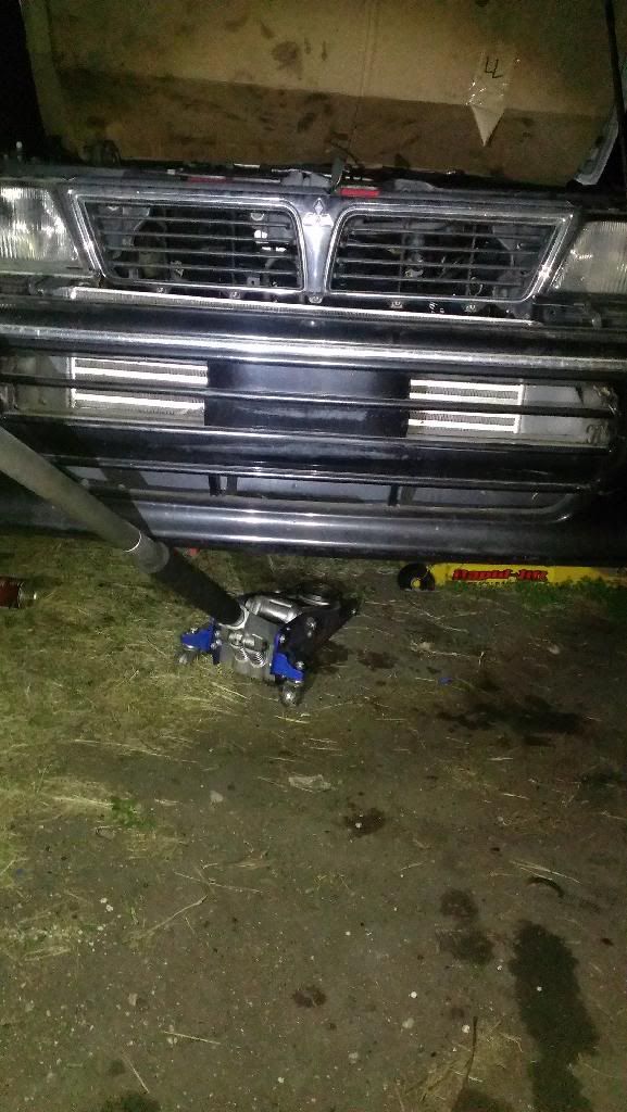

Trunk full of parts

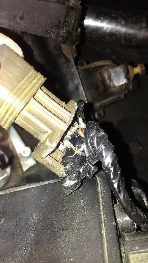

Previous owners handy work /ubbthreads/images/graemlins/uhh.gif
Intercooler doesn't look like it's mounted right also /ubbthreads/images/graemlins/hsugh.gif

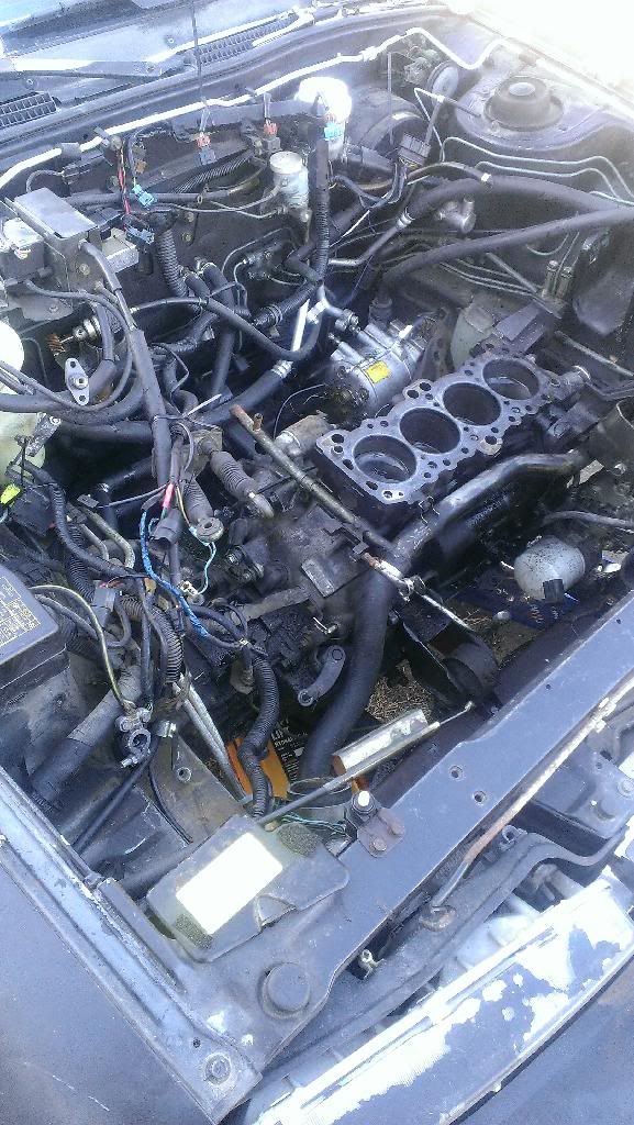

It's been a minute but here is the update

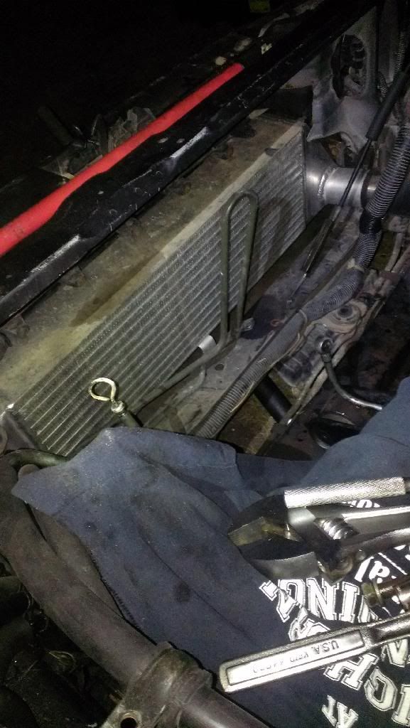

still needs a few thing like the radiator mounted and find a spot to mount the battery and the car starts but revs high to about 3000 rpm then dies, I can feather the throttle and it bogs a little but will stay running. Not sure what it could be /ubbthreads/images/graemlins/dunno.gif I was leaning towards a boost leak but haven't gotten around to checking.
BUT THEN!
FUUUUUU /ubbthreads/images/graemlins/mad.gif. So I guess ill be doing a headgasket now

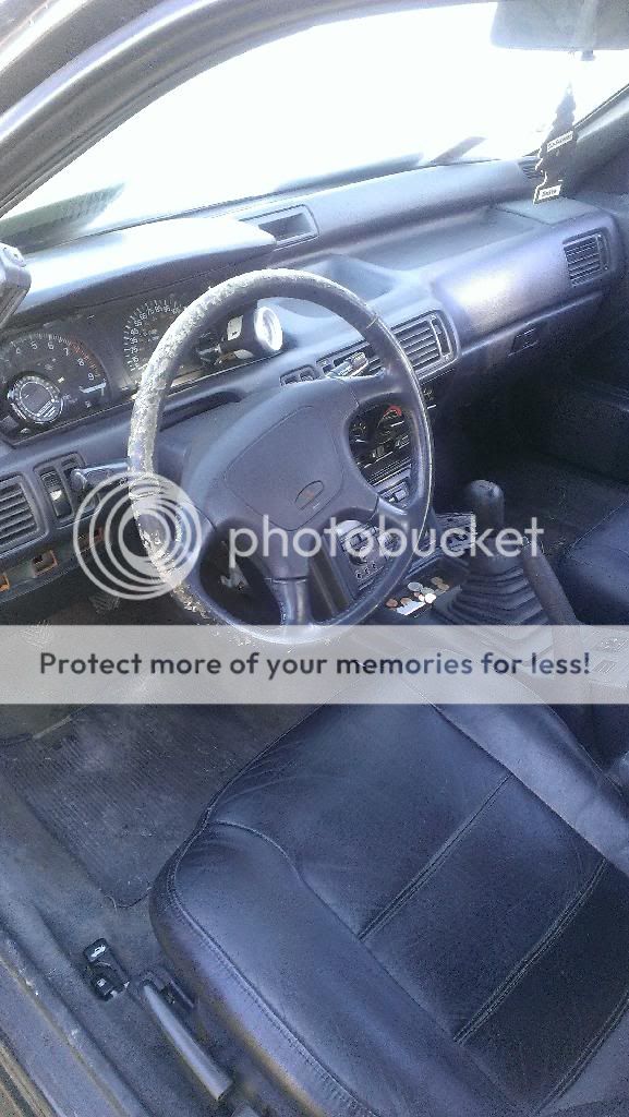

That looks like a really nice chassis, good base to start with. No rust in any of the typical spots (strut tops etc), you even have ac lines, cc, abs, and that little flapper door.
If I had assloads of money I would make you an offer and rebuild that one from chassis up.

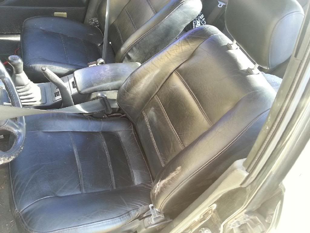

Throw a bunch of leatherique rejuvenate on those seats asap and they might soften up a bit, they are in fairly ok condition for their age. The interior doesnt look so bad. You gonna pull that carpet and clean it? The steering wheel is shot however you could get that recovered if you wanted. Or go aftermarket with a hub.
