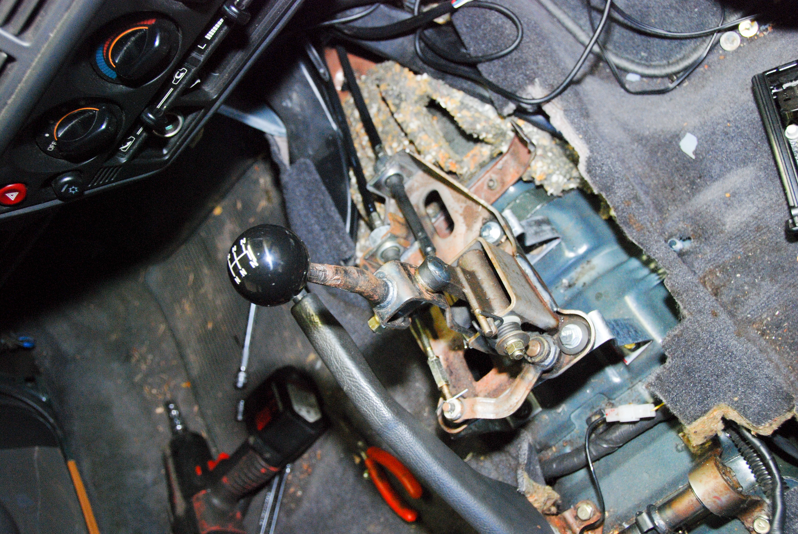

So this was the best wedding present ever! A good friend of mine made this "prototype" set up for 380. You can't see it but it actually has 380/1000 inscribed around the base. Also a nice rally inspired shifter extension.
Let me know what you guys think?
I'll give you guys some details if anyone is interested in one for their Gvr4.
-Dimensions are similar to RallyArt knobs
-This shift knob is made of high quality Delrin (Temperature insensitive & soft to the touch)
-Shifter extension creates a closer "wheel to shifter action" (Mine is pictured with a short shifter from Curtis)
Again this is a prototype, he will be sending me a black and a gray one soon to test out...
PM me if interested. I can give you pricing and options. Shift pattern is standard but could be dressed up or down. If I get an "a lot" of interest (5+ orders) he said we can migrate this to the Gvr4 Marketplace, but until we cross that bridge...

I like how the knob has the 380 inscription in an inconspicuous area. Nice little touch. I assume it's pretty light? How is the feel with that weight. Good to hear that it is coupled with a short shifter to try to get the ratio back.
The low rise shifter and knob looks lame in low console cars. I like the stock shifter in these cars (albeit with a shortened ratio). I had a 1g shifter in my car, and ended up buying a stock shifter to get the knob a little closer. Works better for driving. Maybe not as cool looking for some.

Thanks man
-Yes the weight is great. Pretty light but not to light.
-The extension creates a natural wheel to shifter action
Again this mod is not for everyone. This shift knob replaced a Greddy counterweight shift knob that was giving me problems during redline shifts. I knew it was way to heavy in tandem with the short shifter (not just a 1g shifter but similar to JNZ shifter made by Curtis) so I worked out this solution with my engineering friend. Think about a breaker/cheater bar effect. This creates a much better shift and solved my problem. Plus the Greddy unit is solid steel and would get super hot and super cold, as 380 is my daily driver.

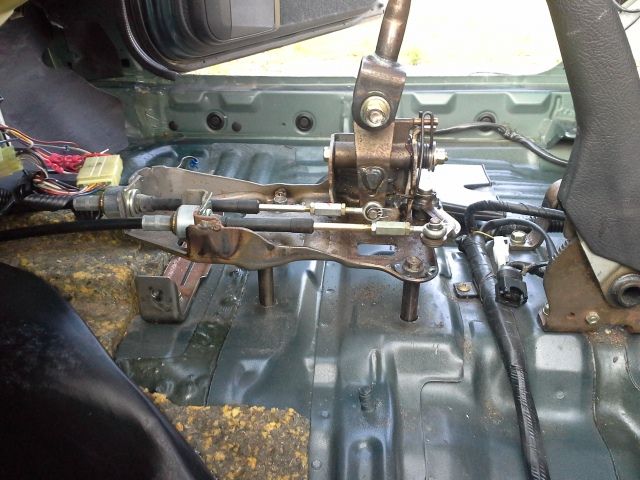

Here's the "shifter" setup in #19. Raised the based 1.5" or 2" used a 1G lever. Sits right about where stock would have sat but with much less throw. I plan to eventually get a JNZ or EH short "shifter" too. Did this in my Mr2 as well and it works very well.
BluFalcon
Jan 20, 2002
1,312
Wichita, KS
Any issues with the shifter base shifting or flexing during use? That's a pretty cool idea, but those standoffs for the shifter base look to be a bit too narrow to keep it from moving around during spirited driving/shifting.
89Patches
Jan 30, 2013
723
Ontario Canada
Probably have 20k miles on it now and plenty of lapping days. I haven't had any problems with this setup to date. Also did it to my Mr2 which has never seen the road since I have owned it (Only track days) and haven't had any problems with it flexing either.

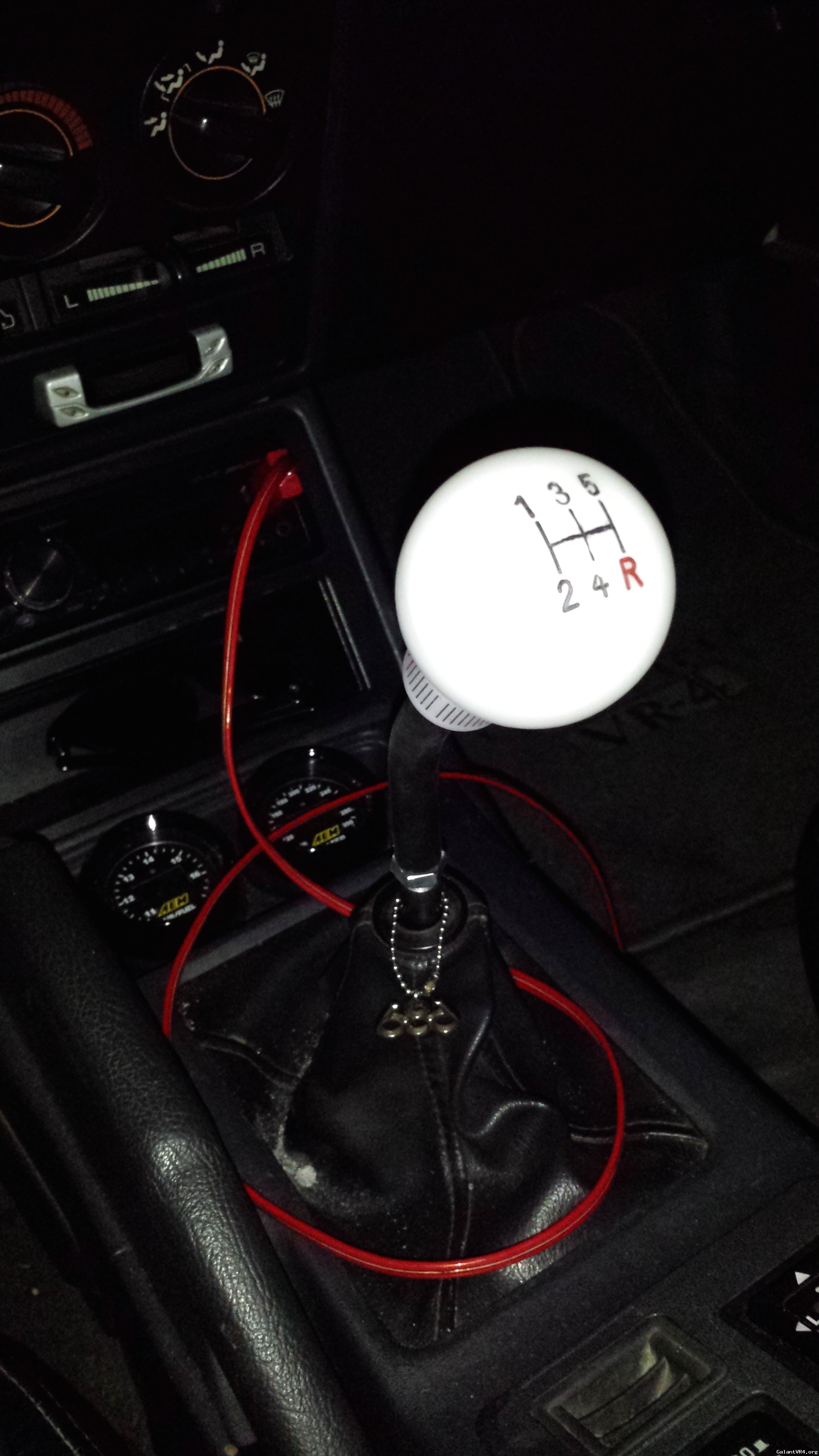

I did something similar. I just used a bent piece of steel stock to do it though. It's way more sturdy than it looks. I got the whole thing BARELY inside the stock shifter boot, mine is way higher though, probably like 4"
I love this mod.
