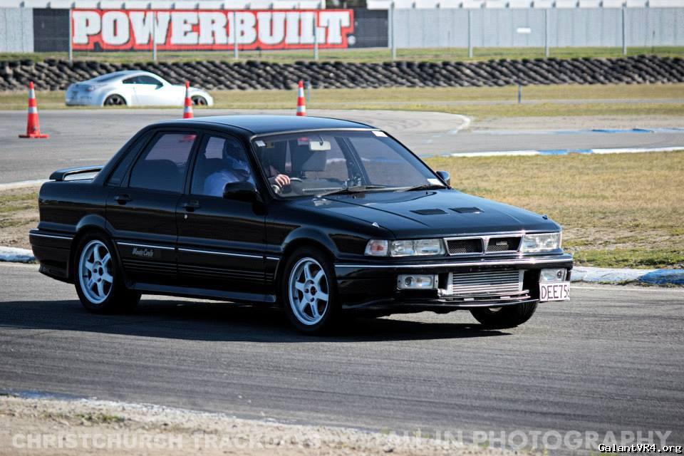

Heres a bit of a rundown on my Galant VR4 Evolution. Its a weekend toy and has less than 140,000km on it. Ive recently upgraded the throttle body and intercooler so need to have the car retuned. Power listed below is before the throttle body and intercooler upgrade. I have also recently ordered an Aquamist water methanol system for when the car is retuned.
